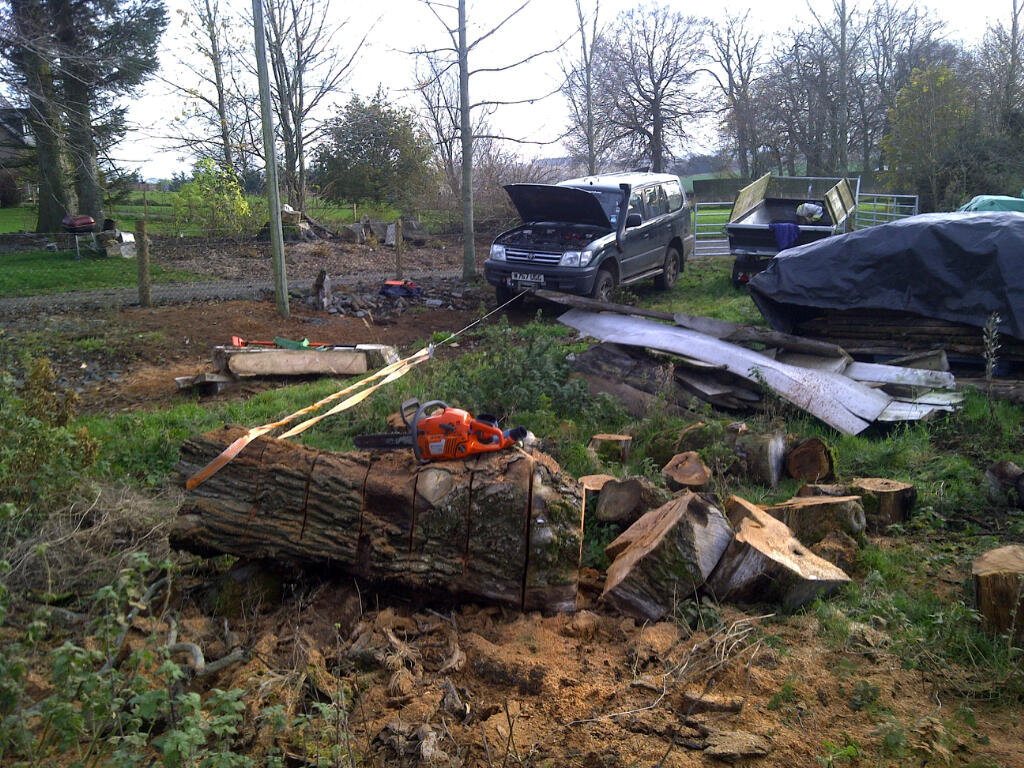

You might find that a wide track Sankey suits your purpose better, it has a bigger tub and tailgate. the wheel track is made to match a 110 the old sankey you have there is an old narrow track for series vehicles.
The wheel bearings, springs etc were all standard landrover parts for interchangeability
