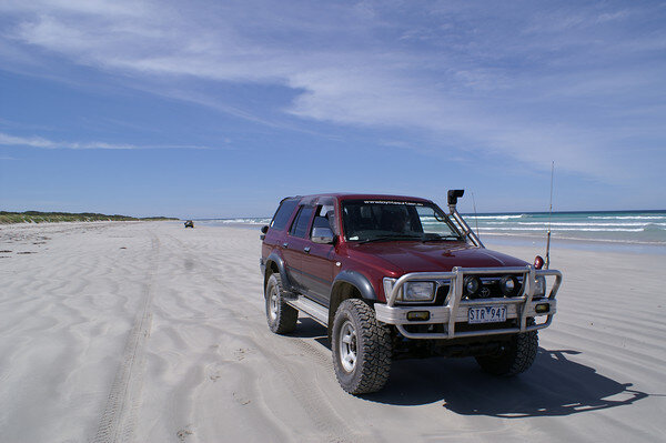

I used to have something like these on my truck back in oz: http://www.lampline.com/240par56wfl-ge-188-p
They are to date the brightest setup i've seen, the light isn't very focused but there is that much of it that there is little need. They are very high wattage (250w) so take around 40amps to run. The biggest downside is they aren't road legal as they are aircraft landing lights on the massive plus side though they are dirt cheap!
You just can just see how they look in the pic below.
