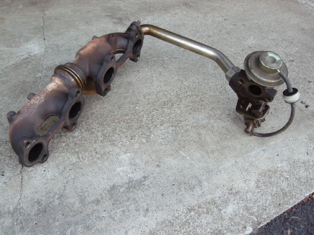

You can stop the egress working by blocking the vacuum pipe that operates it. no plate needed.

The plate goes between the exhaust manifold and the chrome pipe shown here
Not much room to get at it at the back of the engine and a rounded nut meant i had to take the lot off to get it undone . I think it's only 10 or 12mm nuts and if i knew then what i know now i would probably have used a brake pipe spanner for my first attempt .
am i right in thinking that once the blanking plate is fitted you can discard the chrome pipe shayne?.

I removed my pipe all together, and experienced no fault electric wise. I just blocked the vacuum pipes that were left hanging about.
I found it creates a lot more space with it gone, plus it's dead weight being there serving no purpose. If you do remove it like this you'll need couple spacers to put on the bolts as the stud isn't threaded the entire way. You'll see what I mean once you remove it.
