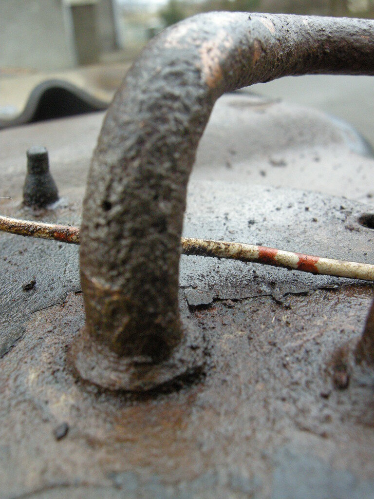

Sorry if I'm saying something that you already know, but best to be a bit wary if welding round the tank without taking the diesel out and giving it a good flush with soapy water. It's not so much that you'll set the liquid diesel alight (though that can happen) but diesel vapours can ignite. You might get away with it, but better to be safe than end up with a face like a kebab. As already said, on the top of the tank are the rigid feed pipe and the return pipe, they are steel and do rust, as do the clips on the flexible pipes. If you have a leak on the feed, it will draw in air and if there is more air than the self purge can handle, it will affect running.

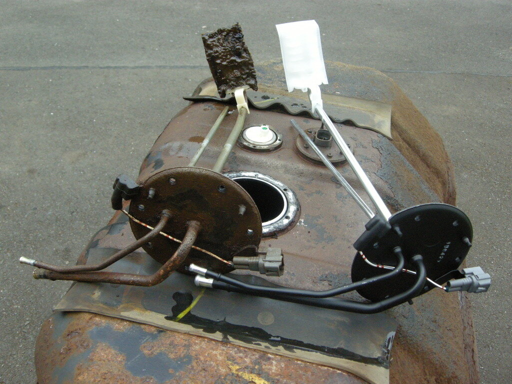

well found the problem guys the fuel tank fecked and so is the tank guard :angry-screaming:
also found a good bit of rot under the back end I'm bloody gutted

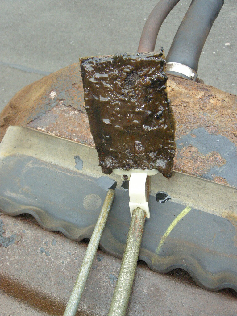

I had something similar with my '98 Colorado.
It turned out to be the steel diesel feed pipe coming out of the tank - it had rusted through and was letting air into the line.
Also, the Sock Filter on the pick-up pipe was choked.
A new pick-up assembly sorted that and, with new rubber pipes, it starts and runs fine (the sills have rusted and its currently in bits - but that's another story).

i will be able to give an update on the condition of the pickup pipes and what not when i drop the tank ,but I'm not holding my breath tbh
pickup pipes solid which is a big surprise :fearscream:
tank all plumbed in just the straps to fasten up .

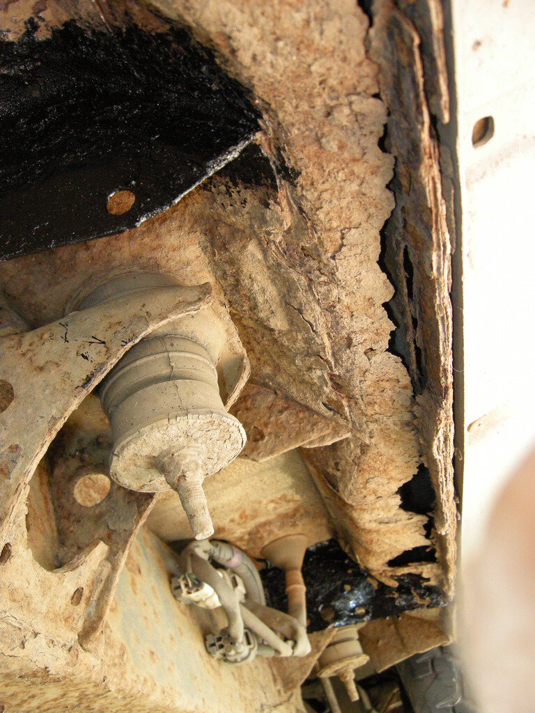

Davedrlc - I'd be interested to see some photos of your rusted sills. I can see mine have problems but I am yet to remove the plastic (bit scared tbh!!)

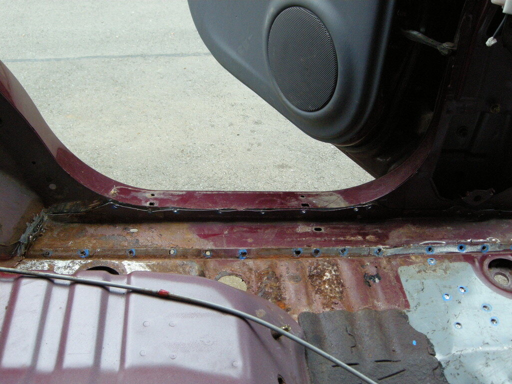

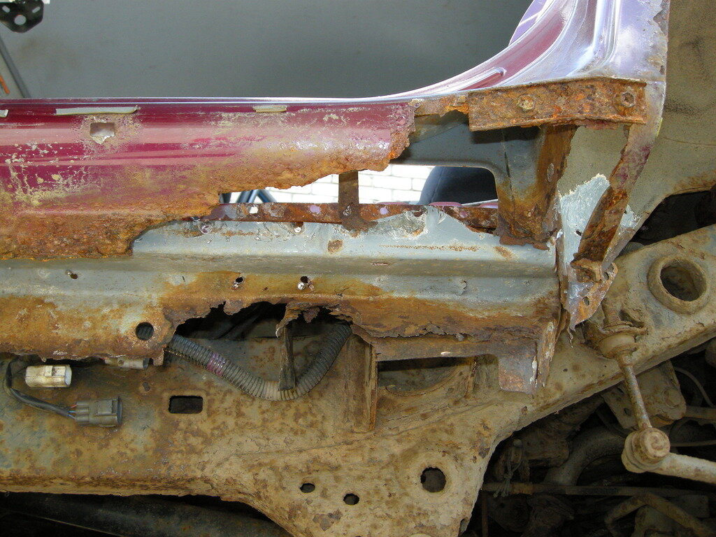

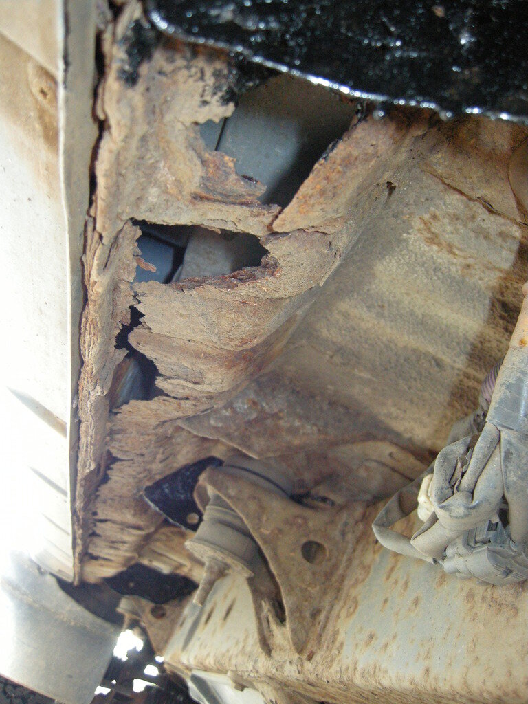

The sills have gone on my '98 '95' manual 3.0l diesel (1KZ-TE).
This is what the N/S looked like:
As the 'inner sill' is actually the side of the floor plus three of the body mounts I elected to replace the whole assembly . . .
This is what turned-up from Toyota . .

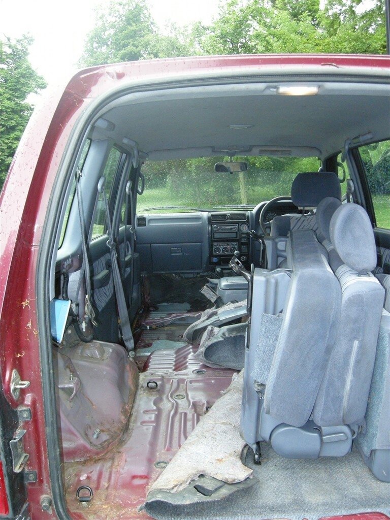

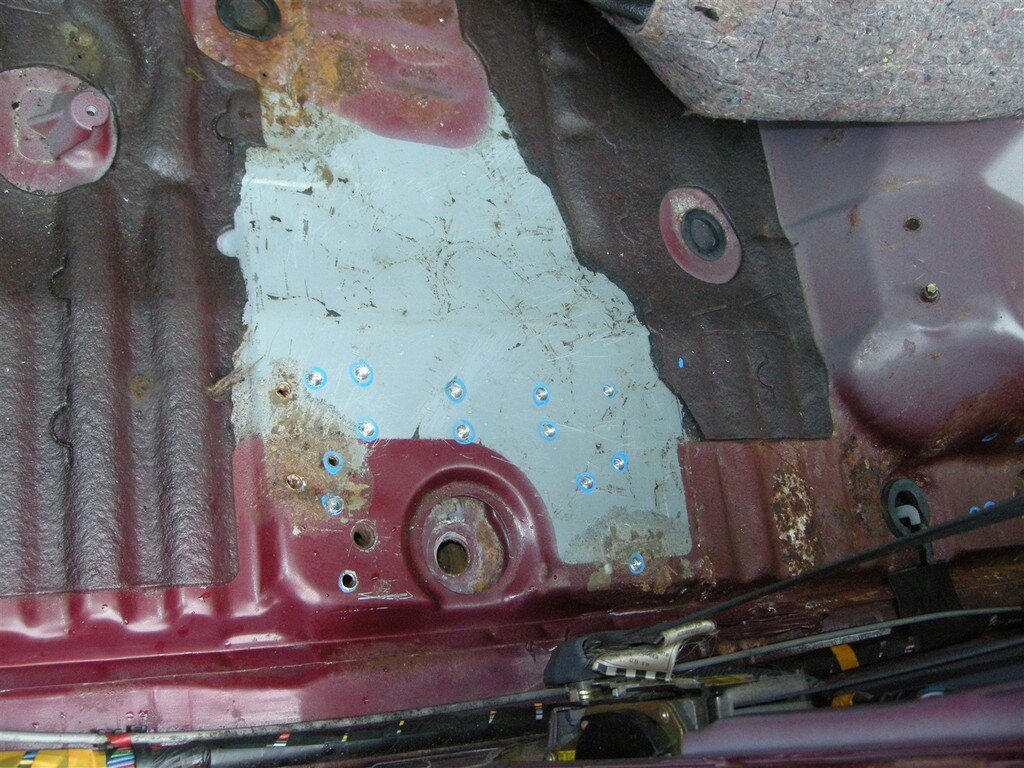

Removing it entails drilling out a few hundred spot welds and then lifting the body off the chassis.
This is no small undertaking.
With the Tupperware removed - the outer sill is toast as well. I'll fabricate new panels from 1.6mm sheet steel and weld them in.

Bob your positivity is awesome! I did see some of these pics on another thread you have, I was hoping my sills will be nowhere near as bad as yours!
How can it possibly go from a passed MOT to that in a year?!? It wasn't hiding behind Waxoyl was is?
I need to be brave and remove the plastic trim to have a proper look. I am hoping a body repair place can fix it. If mine looks like yours though...I think I'll lose the faith..!

well finished the tank put the 50 ltrs of fuel back in .primed the pump switched her on she fired up first crack :dance:
