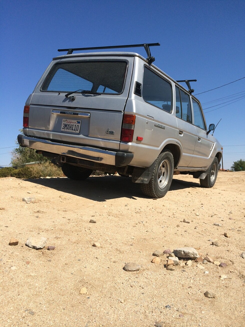

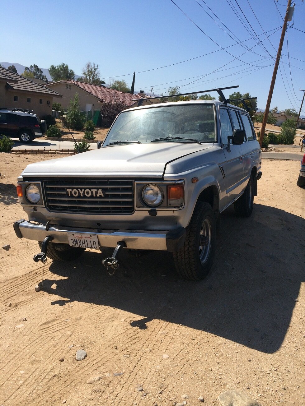

Well today I got out into the garage and was checking a few things on the carb, and I noticed that the choke was completely closed. I turned the ignition on and pulled the choke knob on the dash in and out and there was no change at the carb. I manually opened the choke flapper and when I released it, the flapper sprung closed. I inserted a screwdriver in there to hold the choke all the way open, and when I tried to start it, Truck fired right up and seems to idle just fine right at about 900RPM. Is the choke suppose to be like this? Im kinda thinking not. Here are a few pictures of my friends rig.

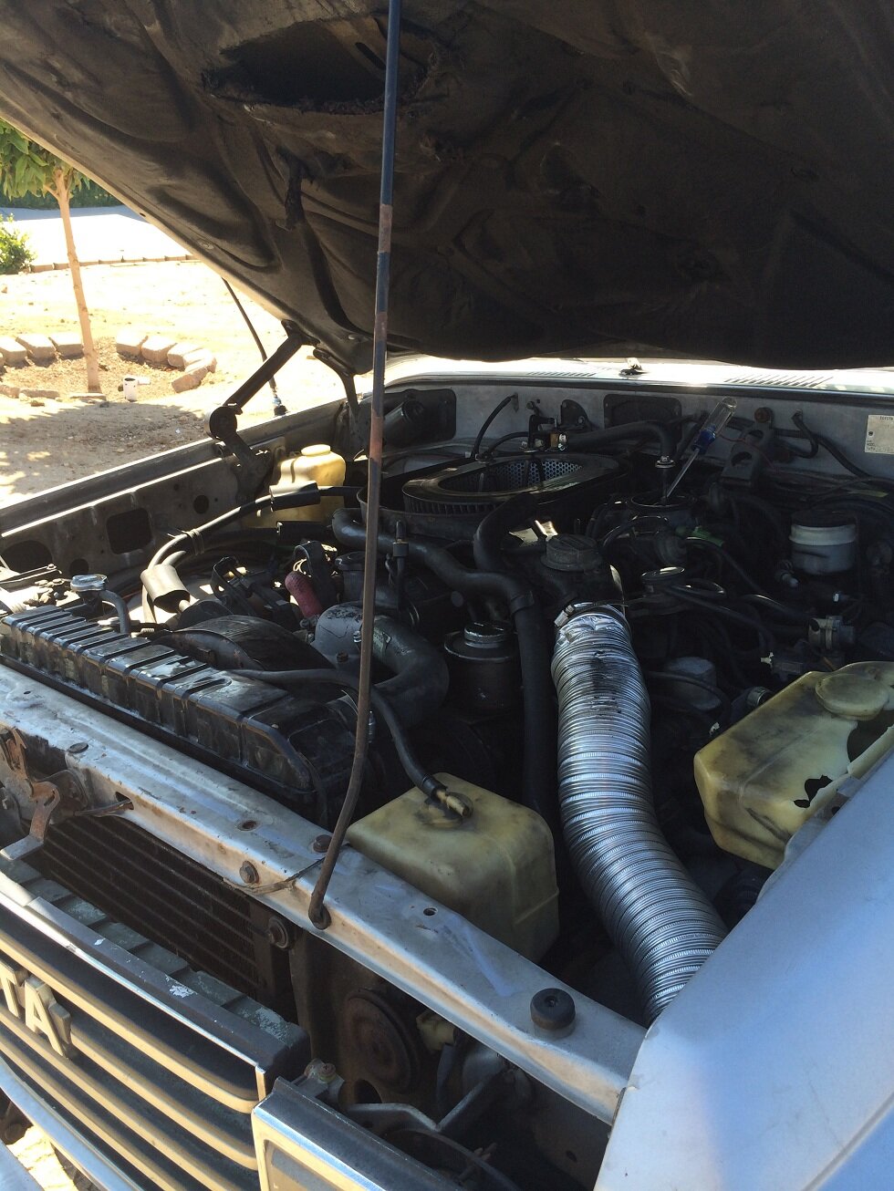

Also here are a few pictures of the engine bay, and my handy dandy screwdriver holding the choke butterfly open in order to make it start and idle

Your picture does not show a lot but I would suspect you have a brake in the choke linkage or cable and it is closing under it's own weight or with spring assistance, if everything looks right at the carb try replacing or repairing the choke cable.
From what you have written above I suspect that the choke cable has probably failed with age.
