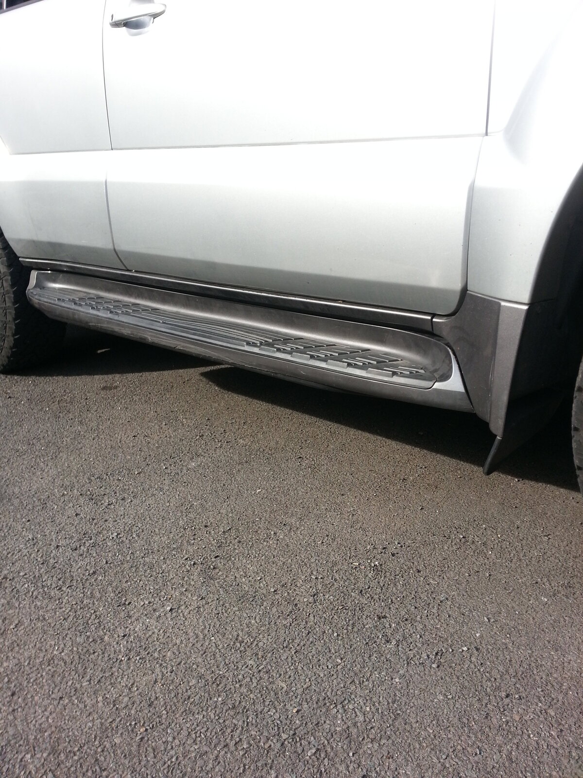

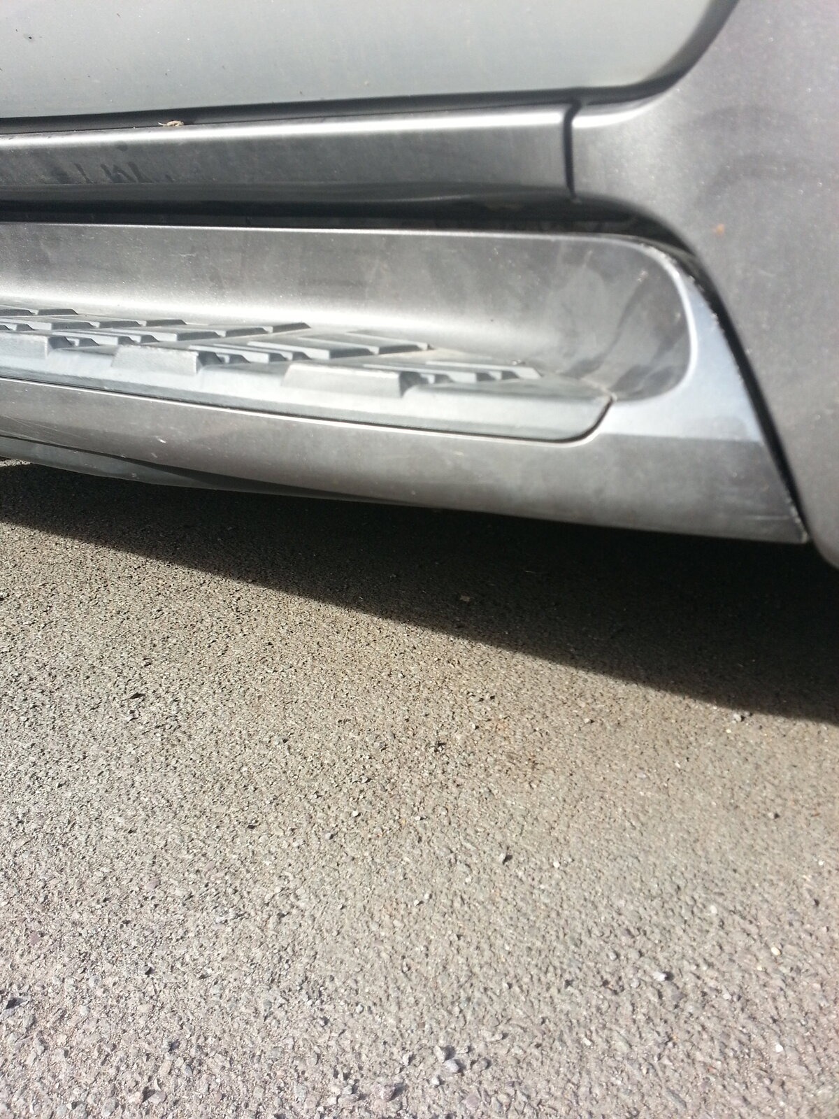

Well finally got some time and fitted the drivers side super stealth sliders. Was easy enough just took a while. 20140504_170344.jpg20140504_170353.jpg
Now to do the other (harder I believe) side
And next week we learn how to hold the camera the right way :)
They do look good and not noticeable.
:wtf: Posted from phone cause thats where the pictures were. Would have thought that someone as smart as you would have fixed the forum to rotate pics the right way round automagically :icon-twisted:
