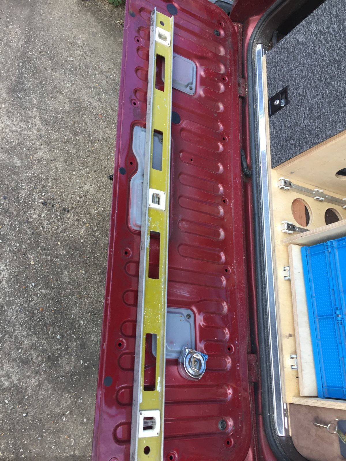

I was getting the six foot level out of the motor and thought of you sc!
I finally got back to the tailgate hatch yesterday and decided to give it a bit of a pull to try and straighten things out. With an offcut of ply and a couple of clamps I managed to all but remove the bow. :-)
