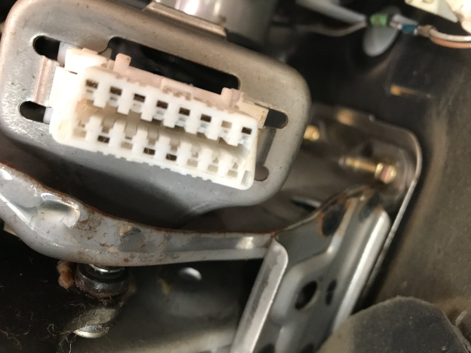

As usual I seem to be the exception to the rule... Can't find anywhere on my Cruiser to plug it in, any clues where to look?
If it’s an auto right hand drive, get your head down in the driver footwell and look up uptowarsds the back of the peddle. There is a small plug fitted to the rhs of the support. I will take a picture for you
It is RHD but it's a manual. I'll get it out in the daylight tomorrow and have a proper look. Cheers
