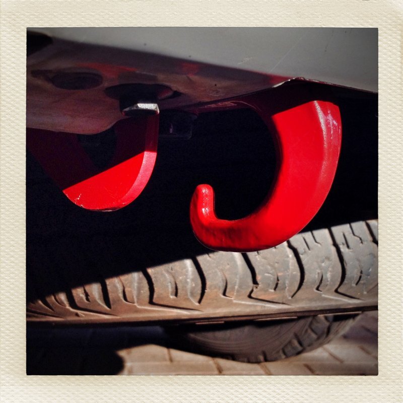

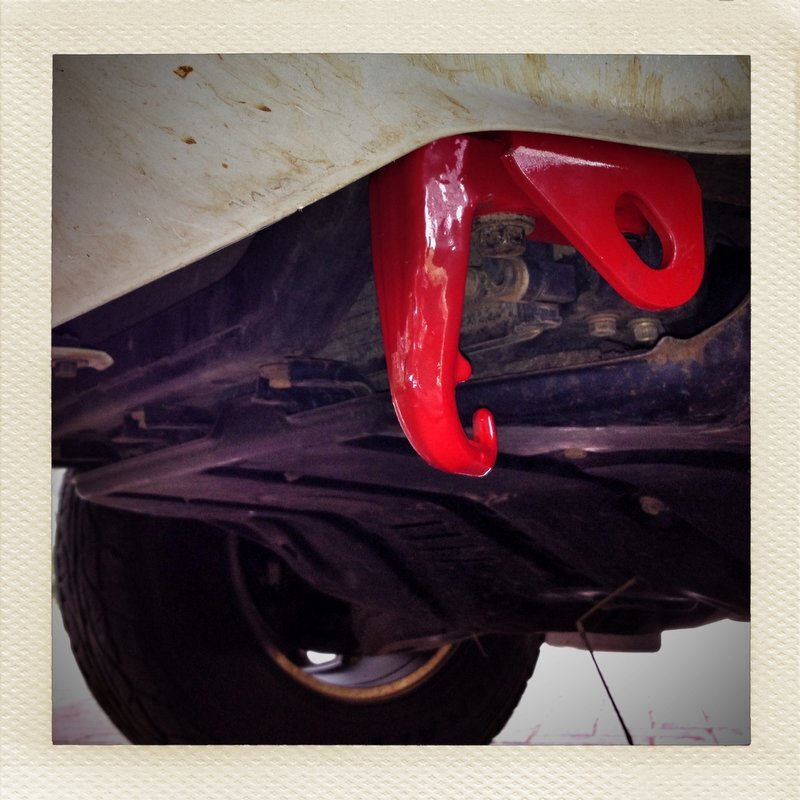

What you do need to be careful of is that from memory I seem to recall that Toyota list a different one for the rear than the front (different part numbers) and the one in your photo Warren looks like a different design to the ones in my photo. The one you have there looks more slender towards the top/root than mine!!! The rear ones get removed when a tow bar is fitted so there's a few of them knocking around as a result I guess The other thing to consider is the price, when I got a quote from my local main dealer for one it was over £70!!! Even from Ian it was still £36/38 from memory Like I've said they are not a light weight item, I could imagine tearing the chassis rail before busting one of these hooks and thats an whole other can of worms right therewarrenpfo said:I have been given one of these:
I wanted to confirm my thoughts that it is not a recovery point but rather a tow or tie down point. Is this correct?
I conquer, the angled ones with a hole in them are listed as Transport Hooksfridayman said:I think the angled one with a hole in it is just a tie down point for shipping, the hook is the tow/recovery point. It might have been someone on here...? that used the angled one for a recovery and managed to bend it (the recovery pull was slightly angled to the side).
warrenpfo said:Just to add further to the discussion, I found this site which sells 100 series recovery point and they look alot like the angle iron ones mentioned. http://www.lukeys4x4.com/products/recov ... LC100.html
I will double check the ones I have on my car again at lunch and post but am sure the one I have pictured is the same as the one on the front of my car and that the rear one is more of a hook in shape.
