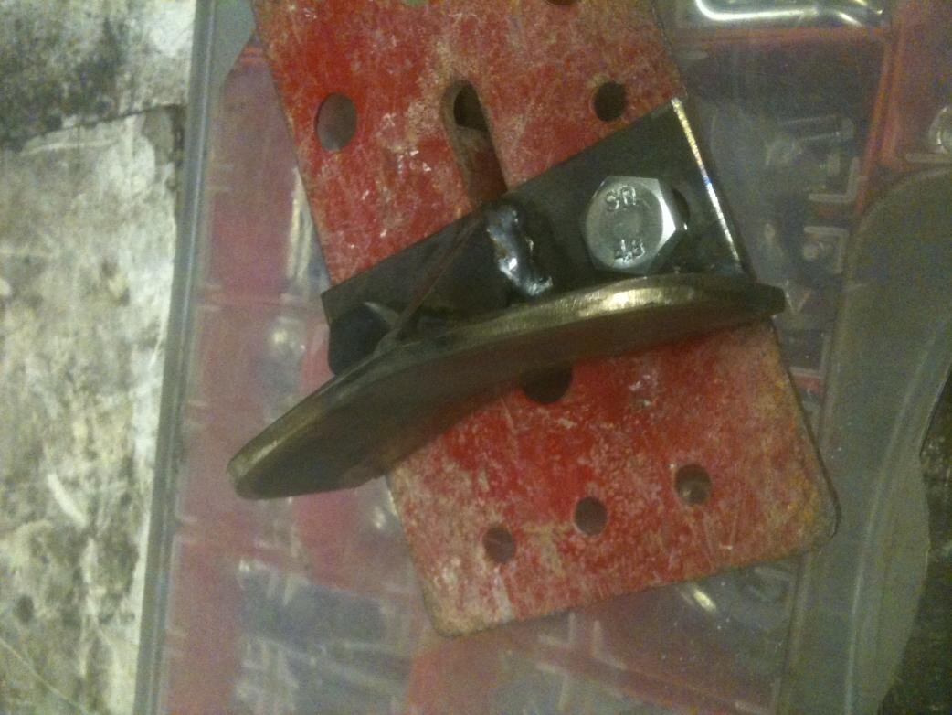

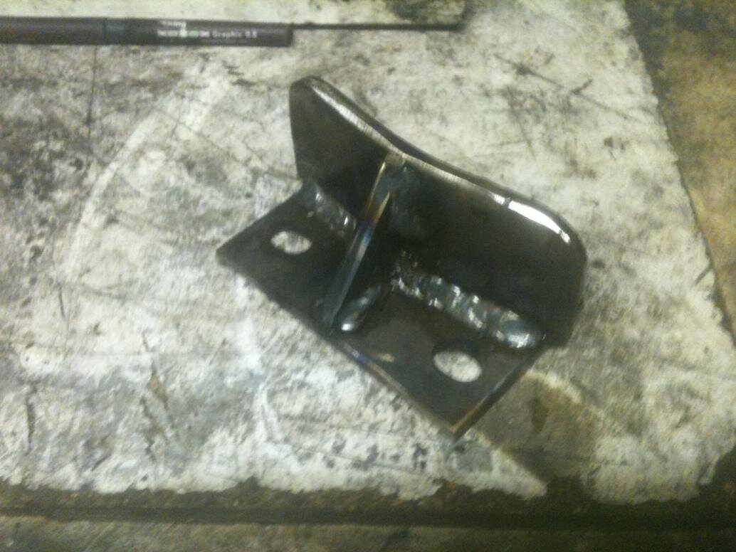

So, an alternative then. Again a quick Gurgle on t'interweb and a bit of bang bang, whirrr, bash clank and bzzzz later and here we have.....
Mk I bead breaker. It simply bolts onto the foot of the jack
OK - so does it work? Well there was only one way to find out. Off into the dark with a 37" tyre and rim, High Lift and my rock sliders to work against, and..
I can confirm that it works flawlessly and effortlessly. Broke the bead instantly. No pics, because A it was dark and B because it just looks like a tyre
