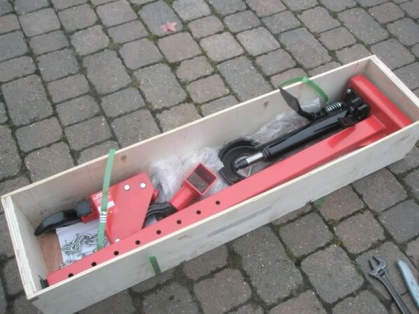

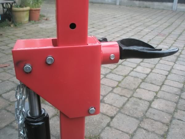

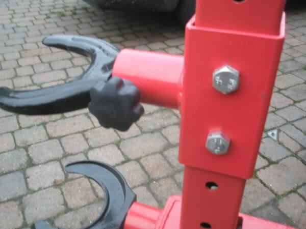

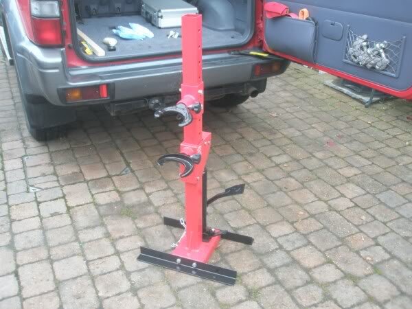

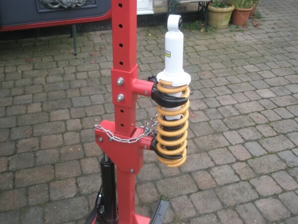

So had a chance to put together that thing that fell from off of the back of my truck today & had a bit of a play with it
Well that all looks prety well
What do you think

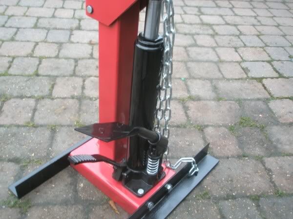

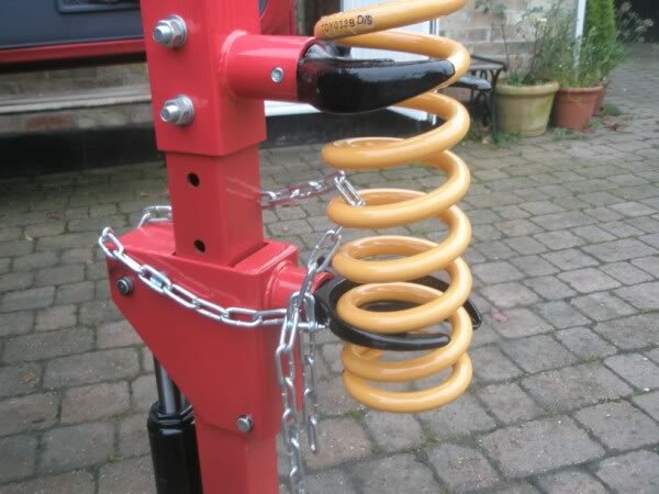

Time to try a spring in it

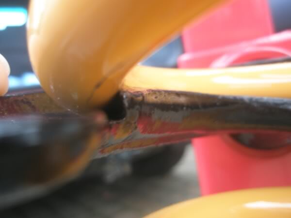

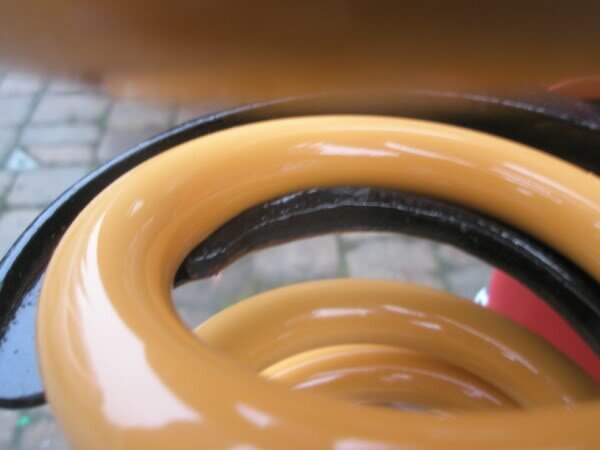

Just nipped it up for a closer look

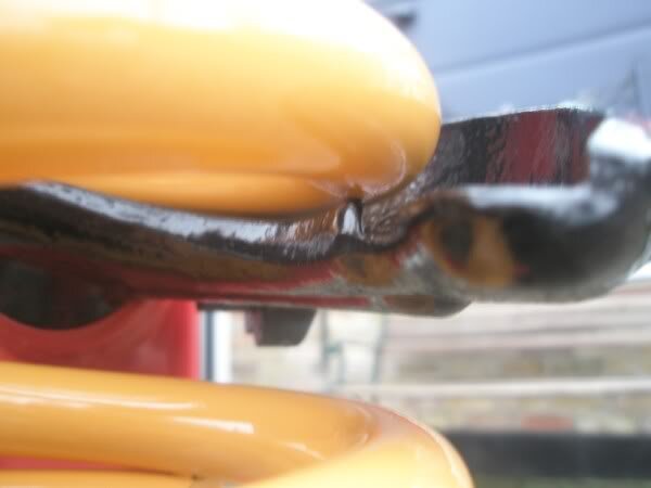

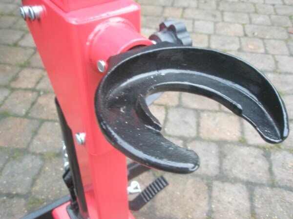

Left side of bottom yolk
Right side of bottom yolk

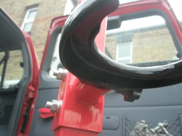

Top yolk looks prety much the same
The spring dosen't seem to be sitting in the yolk correctly

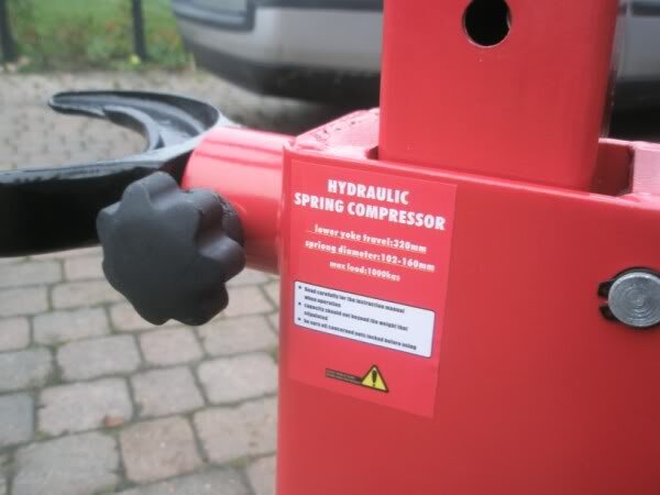

I'm sure that the ebay ad' said it's suitable for springs of diameter 102mm up to something that I don't require
When I measured the diameter of the Ironman spring it is 110mm so I thought that it should be OK
Hang on back in a mo just off to have another look @ the eBay advert
Yep here it is
Suitable for springs from 102mm to 160mm diameter
So what's the gig then
Looks to me like it's ment for a spring with a minimum internal diameter of 102mm
Quick measure of the shoulders on the yolk (90mm across) quick measure of the ID of the ironman spring (78mm)

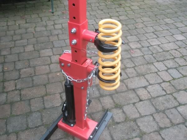

OK nothing ventured nothing gained

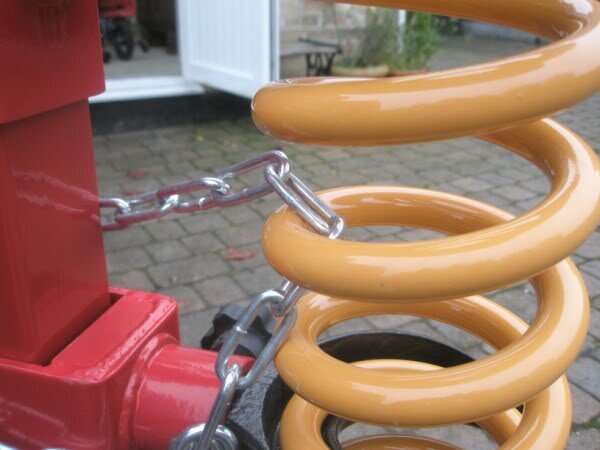

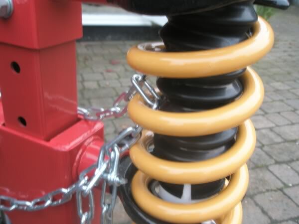

Lets chain it up & give it a squeeeeez

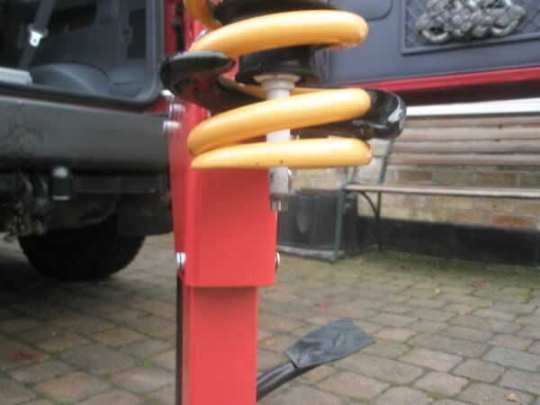

Well
That's gone well
Very well infact
Even though the spring is not fully seated in the yolks it is well grabbed & feels as solid as a rock
Even if it did brake loose it's not going to jump over next doors fence killing their dog
as the chain has got it
And it's not going to kill me if it gets loose as I'm stood directly behind it keeping my distance
Although if it did brake loose while i was stood that close to it I would almost certainly need a kitchen knife to scrape my pants off before they went in the wash
Guess how long it takes to load the spring, chain it up & squeeze it enough to fit a top plate
4 minutes
I even put the spring back in the box & did up the bolts on the the safety chain 'D' shackles before starting the clock
Looks as though it's going to be a handy addition to my toolbox on Saturday then
