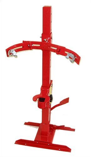

OK I've prety much decided to buy myself a floor standing hydraulic spring compressor & as It happens there's a firm in Wickford not 20 minutes away from me that stocks them so no postage to pay :thumbup: But there is two different styles to choose from :? The first looks like this for £75 :arrow:
This one has a pair of adjustable hooks that hook over the spring coil & then the strut sits on top of the horse shoe plate @ the bottom & is then clamped in place with a 'U' shaped securing bracket :)
The second one looks like this for £95 :arrow:
This one has two horse shoe shaped seats that the spring only sits in leaving the shock free to fall off once the top nut is removed as the the youtube vid above :) This one would be my prefered choice as it looks slightly more robust :think: They do say it will accomodate springs down to 102mm in diameter (Fierys spring is 110mm) so should be OK but I'm a little concerned that the shoes will not fit in between the coils as they are quite tight on the 90 spring :? :?: :)
Can anyone help me make my mind up before next Tuesday when I'm going to pick it up :p
Has anyone used the second type on a set of 90 springs :?:

Going purely on design rather than technicalities, I would go option B. That's the type I have seen before. The other look very bendy.
Does it not come with some filler pieces to even out the horseshoes? I wouldn't put the shoes into the coils. I would compress the whole tower from the isolation pad on the top to the bottom flange on the shock. With some filler pieces, the shoes would be flat. Wouldn't take any making really.

Chris said:
Going purely on design rather than technicalities, I would go option B. That's the type I have seen before. The other look very bendy.Chris
The top one is useless :thumbdown: , I watched Greg trying to compress some springs and as you say Chris, it was very bendy, it just wouldn't do the job.

agreed - i got the top one :( whilst i got the job done, it was very bendy -
it was fine for my subaru forester springs, but not so good for HD landcruiser springs
i wonder if i can get the stirrups from the "B" model, as the rest of the system is the same, just the spring holders are different
will be interested to see how well the "horseshoes" fit between coils

OK I have to put my hands up to having misslead you all a little as the video & the photo both show the Sealey RE231 coil spring compressor rated @ 1500Kg that is not easy to find for less than £150 & can be as much as £220 either way far more than the Chinese copy that I'm planing on buying rated @ 1000Kg for just £95 :) You can see from the photo of it that it is not as well guseted as the sealey model & is also rated @ 500Kg less than the sealey model :) I don't know what the spring rate of a standard front 90 spring is but even the Ironman ones @ +20% over standard can't be more than 1000Kg :!: Can they :?:
Also be warned 80% of the peeps selling the cheaper 1000Kg unbranded model show a photo of the Sealey RE231 in their adverts :roll: :p
Here is the photo of the unbranded item that I'm considering buying :arrow:
I'm still a bit concerned abouit the yolks/horse shoe seats fitting inbetween the spring coils of the uprated 90 front spring though :think:

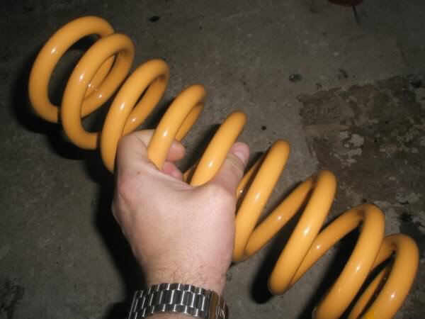

Just been down & unpacked one of my new Ironman springs & the coil tightness isn't as bad as I thought :? I guess I was looking @ the OME (original manufactures equipment not Old Man Emu :lol: ) on Fiery old & sagging with weight on 'em :D

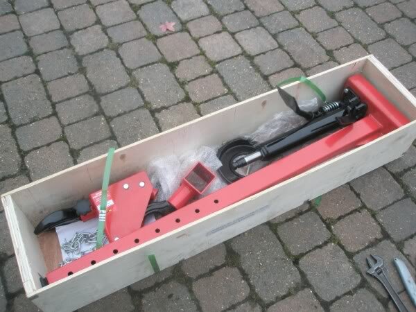

Ooops :shhh: Look what just fell out of the back of my truck :D
