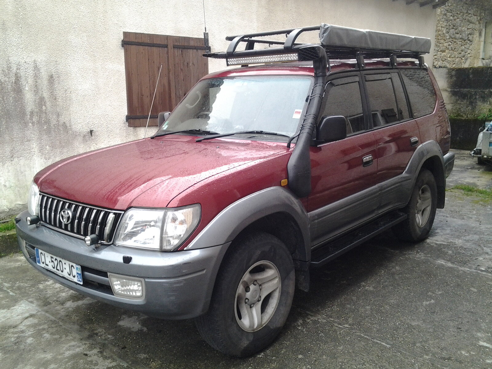

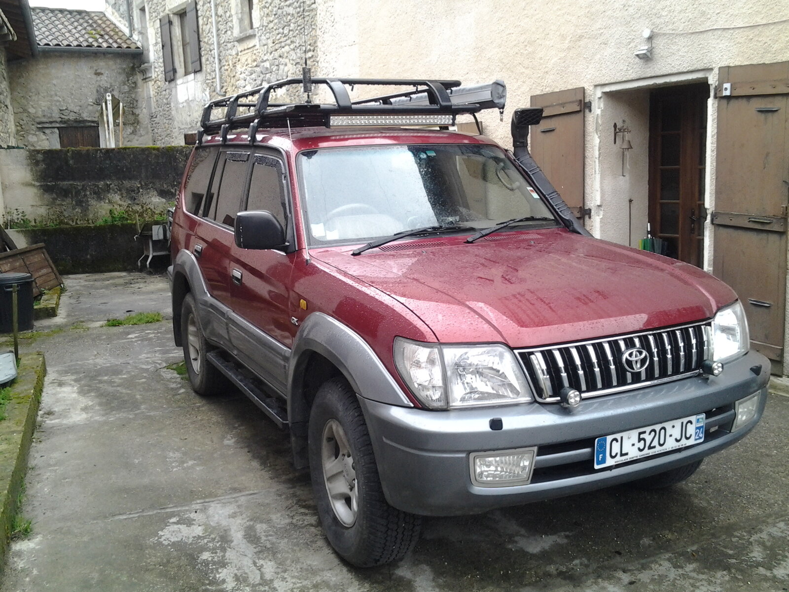

before:
after:

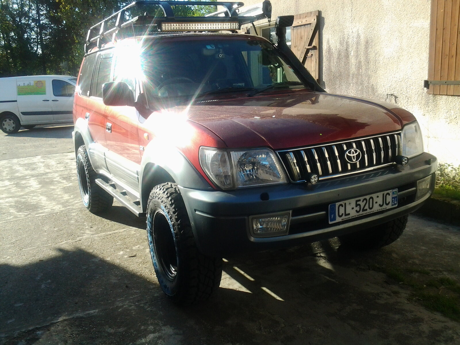

before front drivers side : 87.5cm now: 94cm
rear drivers side : 88cm now 96cm
rear passenger : 87.5 now 96
front passenger : 88 now 96
Original wheels 7 x 16
new wheels 8 x 16 with -25mm off-set :)
why down drivers side? drove home with fat me in drivers seat perhaps?

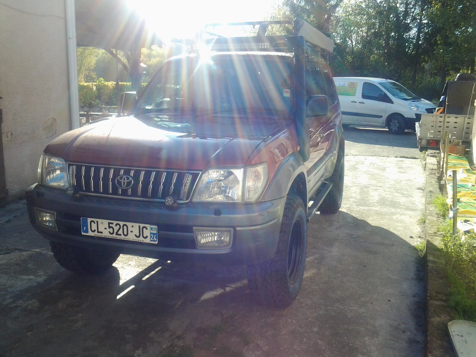

ride is good, no rolling, but early days. Both front tyres catch the sill, :( so, out with the grinder if it still does it after my alignment tomorrow.
Very pleased with the result, but dont think I will be using mr local mechanique again......10 hrs labour charge........525€ all in! OUCH!!!!! had lots of problems, everything rusty, had to cut off rear suspension...I told him all this before hand! Oh well, DIY next time!
That's looking good Steve - it's a surprise how much better they look with the wheels pushed out to the edges and chunky tyres. :icon-cool:
P.S. I was never a fan of those 3-spoke alloys Toyota used on the facelift 90s.
That's looking well good
Looking good Steve. The -25 offset is why they're catching, moving the tyre outwards means it needs more space to swivel.
Worth the wait Steve and if you say it fast, and the money! :icon-cool: Factor 11/10 :lol:
Looks very smart :) Need more photos with less sun :) :)
