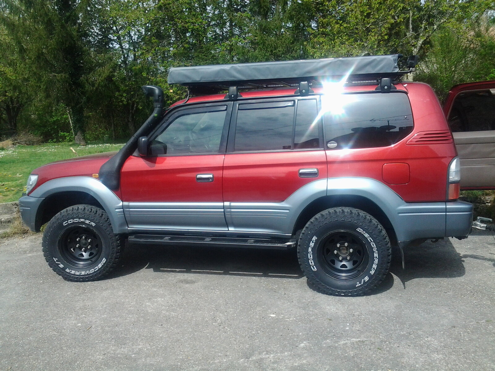

and just for Steven, a couple more shots without too much sun! (I cant help it if the sun is (almost) always shining can i?) ;)
Plenty of clearance at the rear, even with 1250kg on the back :)
Still chuffed.
Cheers for that Steve :)
That second photos the one for me :) It shows those tyres off to there best :) :) Very tempted by those as I've always loved the Coopers I had on my past trucks. Where did you take those lift measurements from? Could you take some from the under side of the molding to the top of the wheel rims for me :) Those -25 off-set rims where an interesting move! They're like having a 40mm wheel spacer from the OE off-set, I think that the 80 series rims that I have on Swampy are zero off-set ET00. The different measurement that your getting from one side to the other may be that one of the springs is slightly longer! In the Ironman kit one of the front springs is slightly longer than the other by 10mm, but I can't remember what side that it is supposed to go in! I've no idea if the Pedders kit has the same thing though?!
No worries, top of rim to moulding is 34cm. Tyre make a little 'rumble' @ 50kmh / 30 mph, nothing I cant live with :)

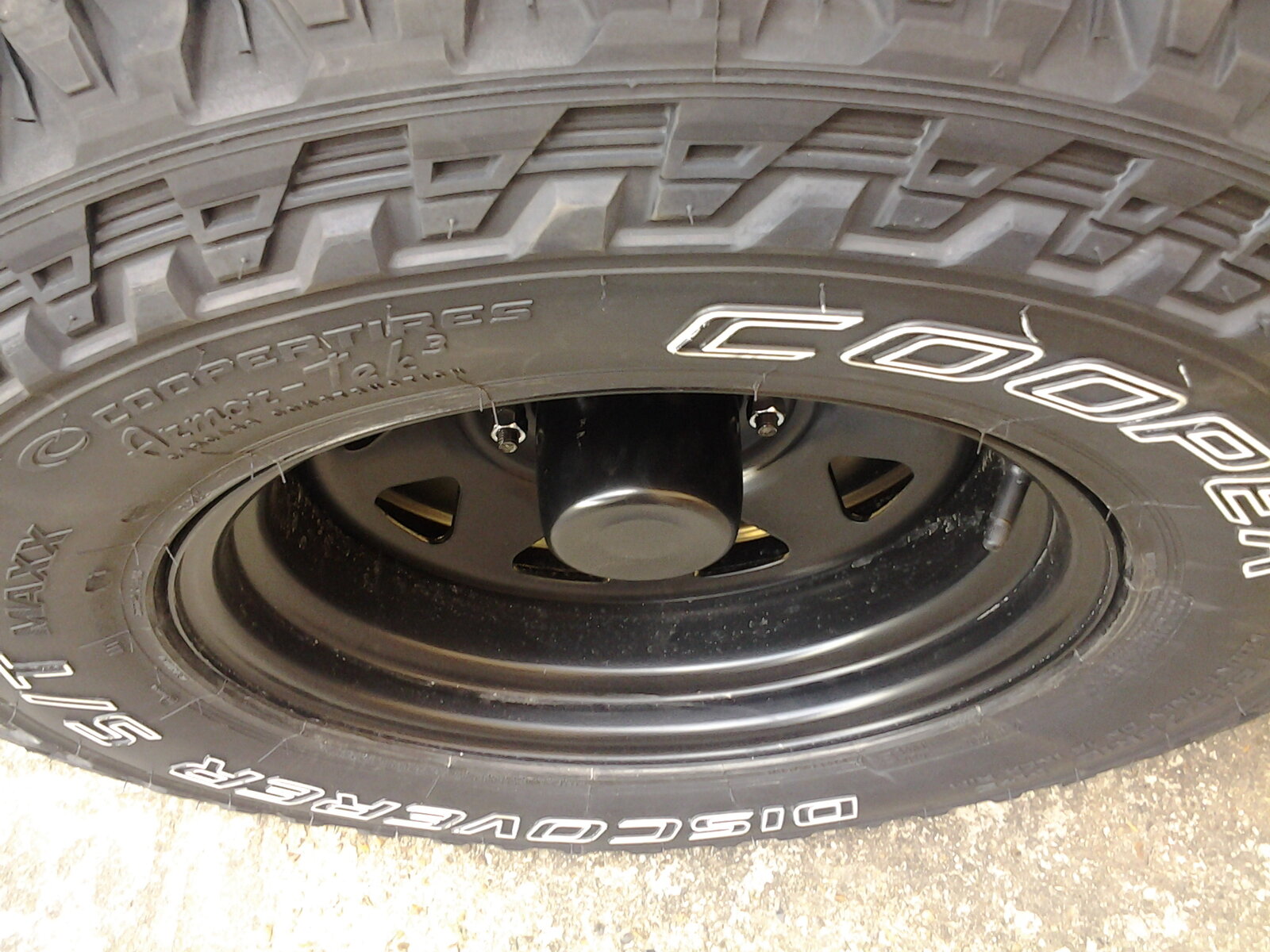

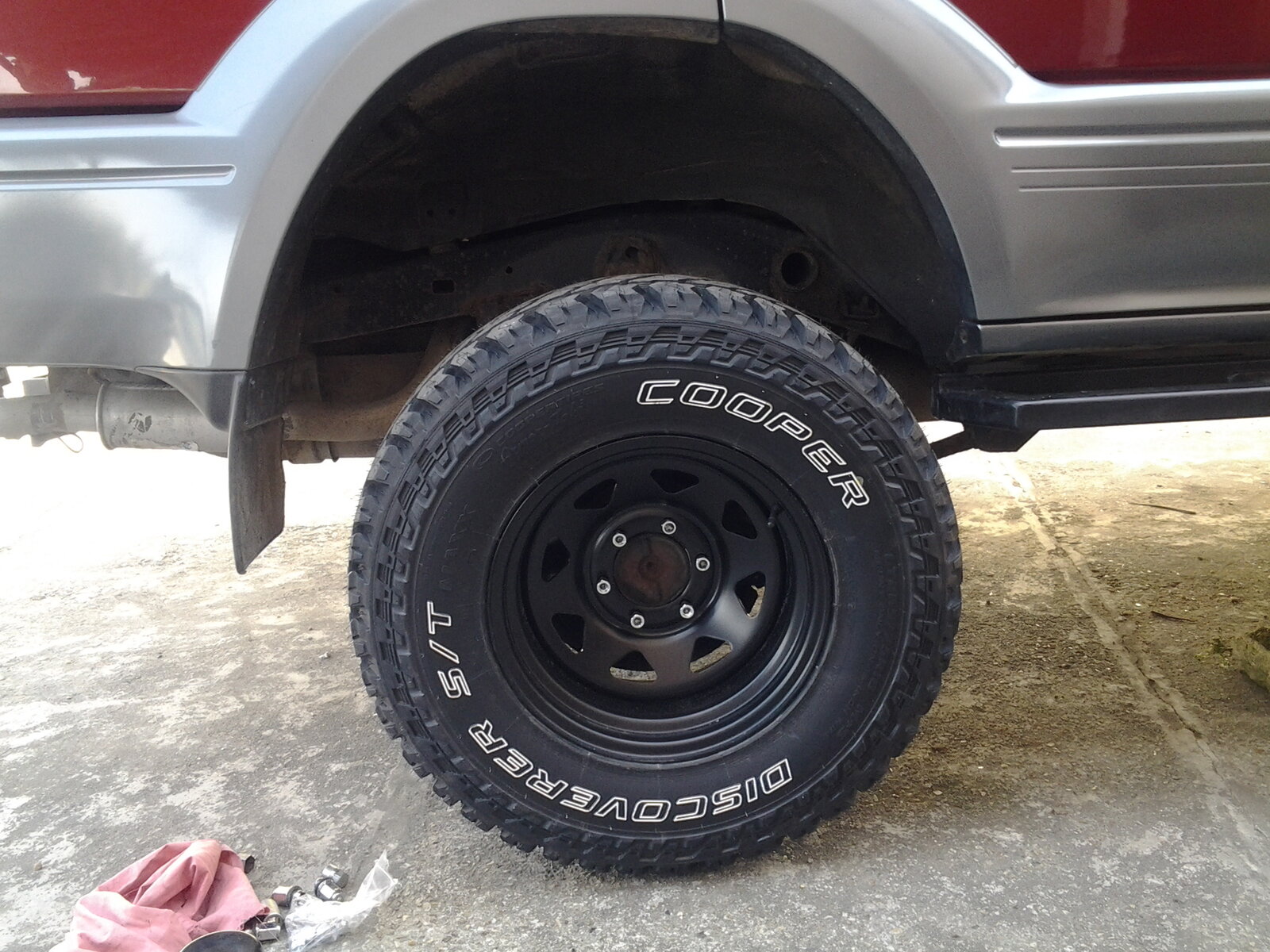

My new nuts came this morning (oooerr misses), so just fitted them and the center hubs, just to finish it all off - one problem though, my bottle jack isnt tall enough any more, so with a lump of stone and a lump of wood, just got it high enough to remove 1 wheel at a time.......some clearance now! Photo was before wheel came off the ground..........
finished wheels with new nuts ;)
Just a note - front wheel studs are 10mm by looks of things shorter than the rear ones.
strange but true!
strange but true!
Yes, you're not the first and wont be the last person to find that! :icon-wink:

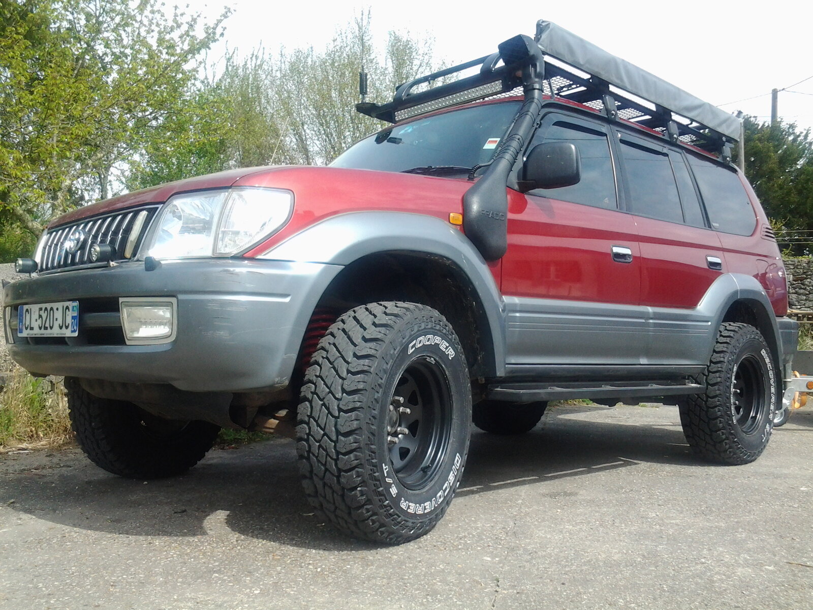

Hi Steve, just wanted to ask how your steelies are getting on? Any rust or issues? I am considering getting them for my 90. Also is there any chance you could take a pic of how the tyres are sitting compared to the arches? I have aftermarket flares and trying to decide if your -25mm offset rims are enough compared to the -32mm one I got from GOJO's. Cheers dude ;)
P.S. where did you get the hub covers from?
Here you go... I guess they poke out about an inch. I have heavier springs on the front too. The caps came with the wheels.
I am sorry the car is so clean....it was valeted a week or so ago and hasnt been used since!
