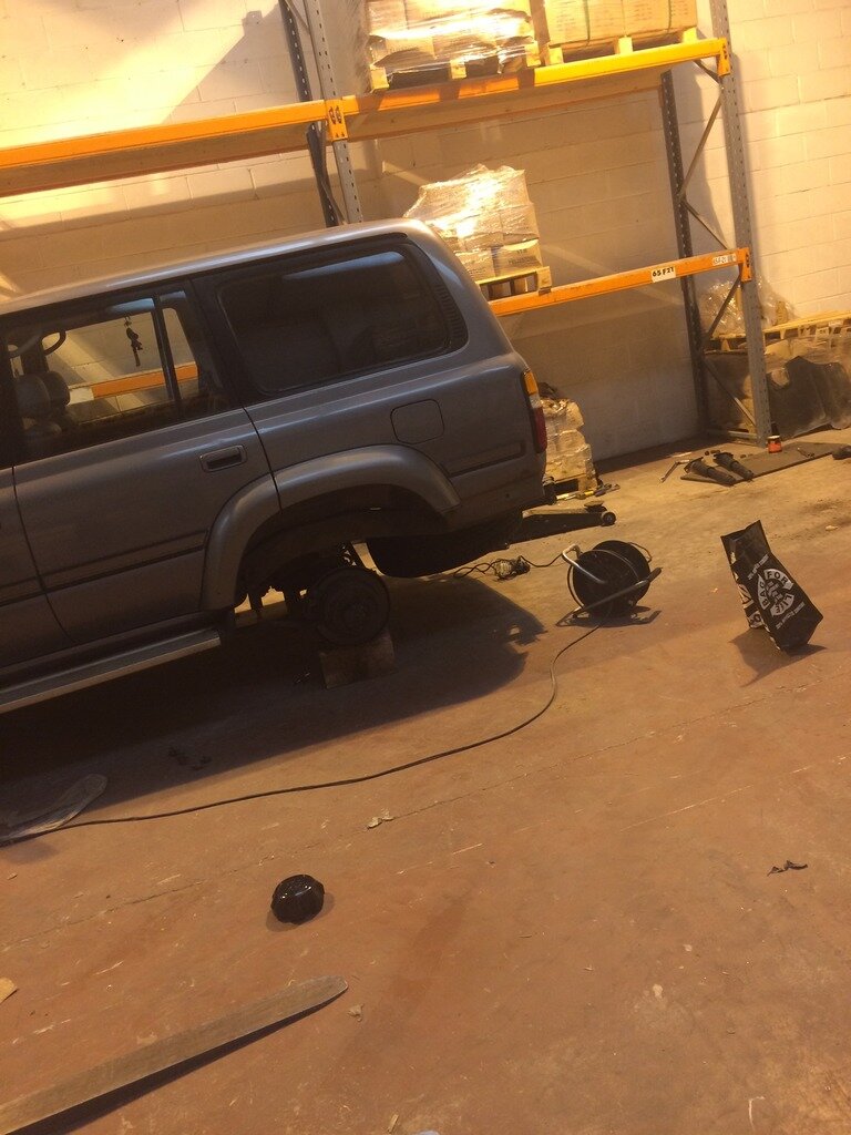

Well it's time to pull the front diff I'm afraid. I have had transmission issues since Morocco and despite changing the gearbox and the T box more than once, they continued to plague me around the Baltic. Between 55 to 70 it's very noisy and on the overrun in or out of gear there is a mechanical rumble / clangle sort of noise. My only option now is the diff. Now it does not whine at all so I figure the ring and pinion are good. The noise sounds like a drive shaft being able to wobble if you like when not under load. With the window down you can't hear it. It's being transmitted through the cabin somehow. I have dropped the oil more times than I care to remember and never had any filings but the oil has been utterly trashed.
Dropped the oil this morning and it wasn't bad but it's only done 4500 miles. However, look at the plug. Something is wearing in there.
However, it's raining now so work has stopped, but the really good news is that the hubs, discs and other parts are in great condition and still all set just as they were before my trips. Everything spun silently with no play and even the grease in the knuckle is still in place with not a drop of oil from the axle tube.
