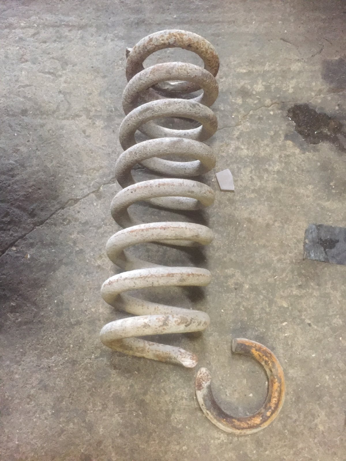

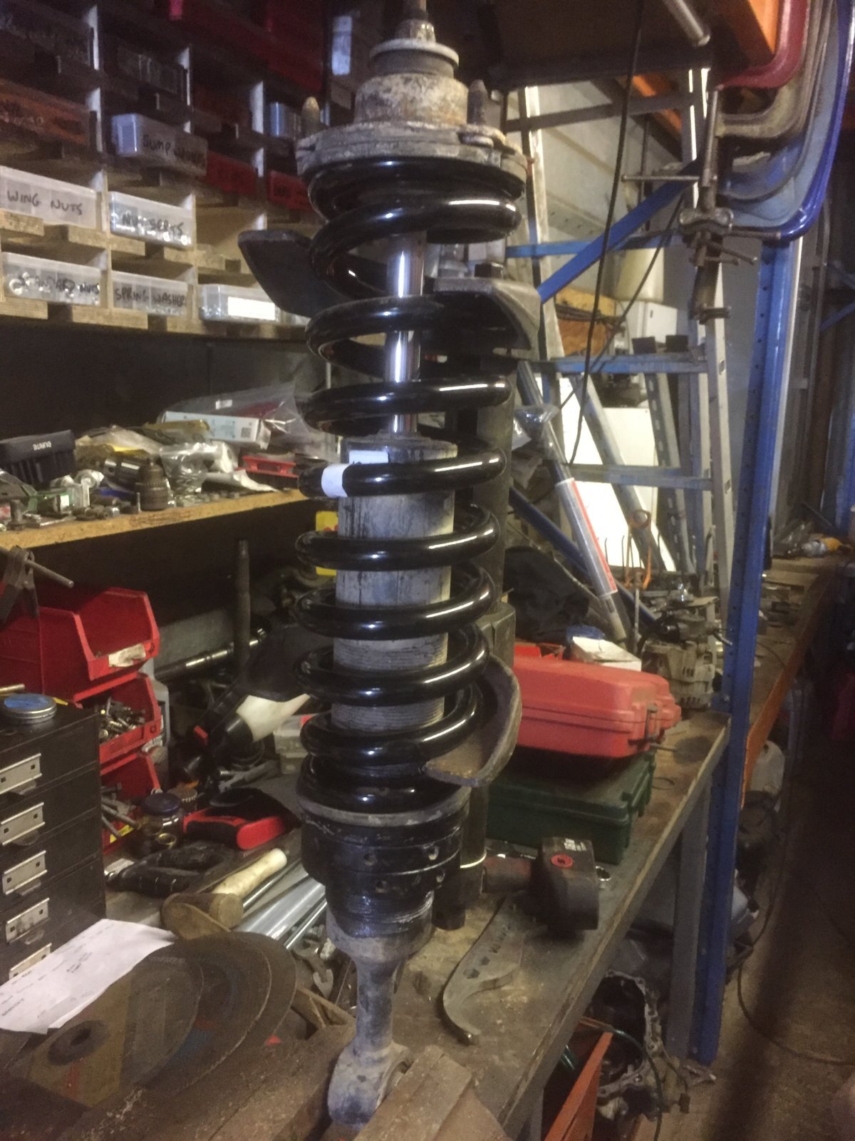

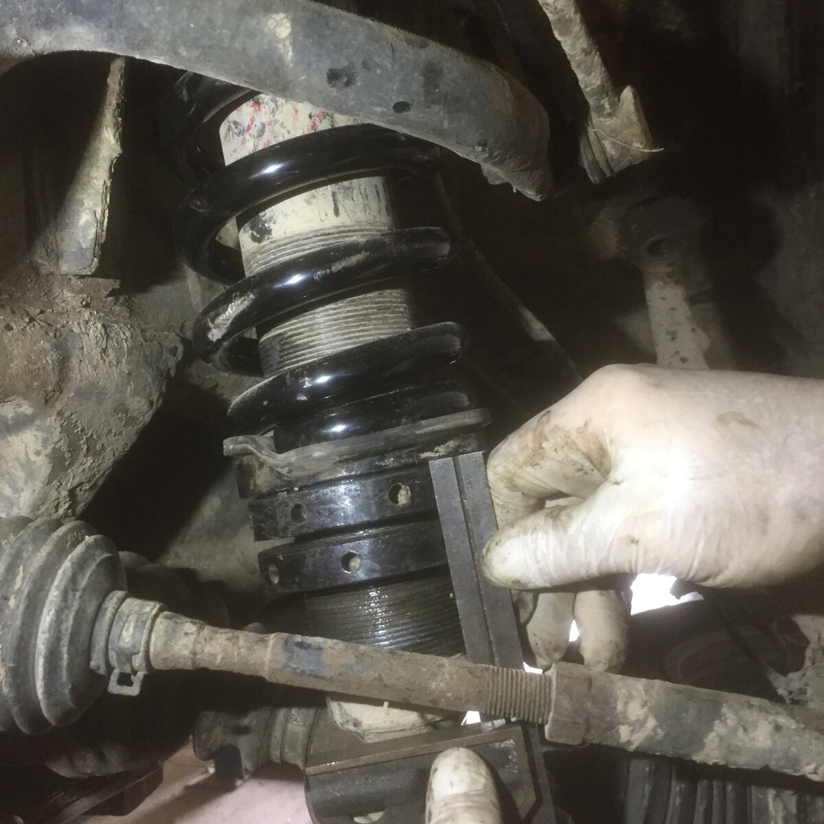

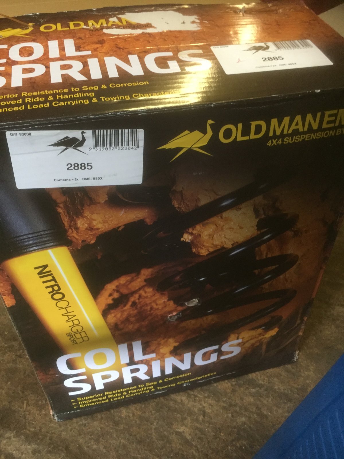

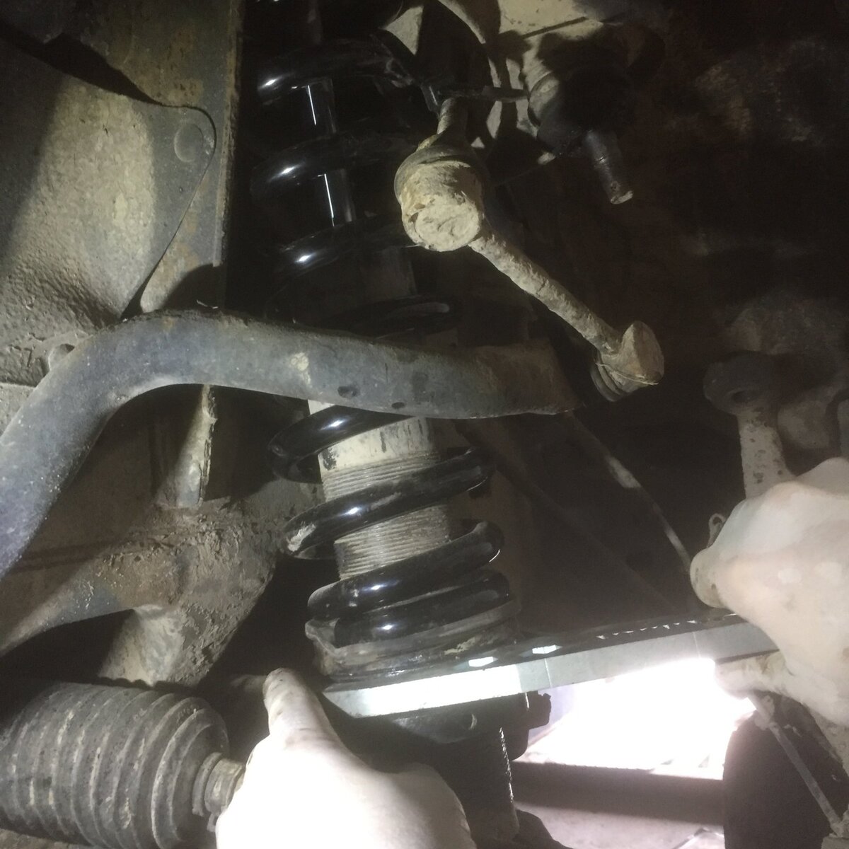

One of the Tuff Dog springs broke on the 120 which is a shame as they gave a good ride with the Ironman foam cell pro shocks.
Replaced springs today with OME without the packing ring (didn't fit) and adjusted the shocks to pick the front end up a bit more.
So far enjoying a very balanced ride.

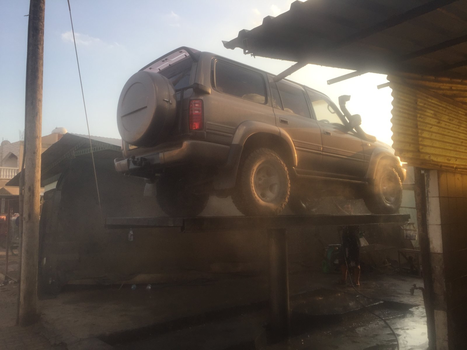

New used turbo fitted temporarily for now till I upgrade to a EFI 24 valve body one.
Quite a job even had to take the manifold off myself quite labour intensive doing most of the work myself.

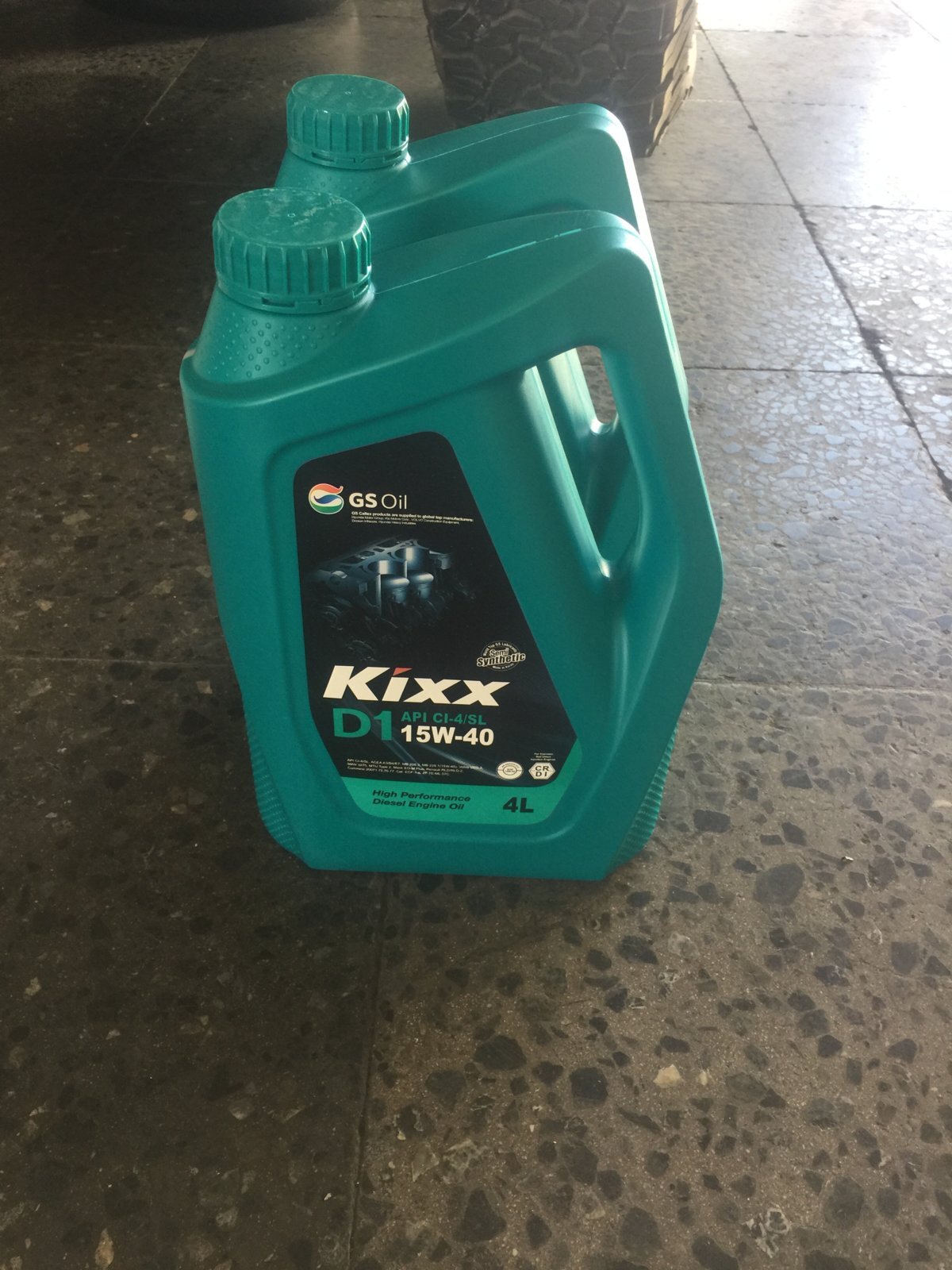

New service with upgraded oil for longer yield and new filters. Should last some 20,000 km’s before next service.
Wheel tyre rotation done with props greased.
Also a over due under and over jet wash clean ;)

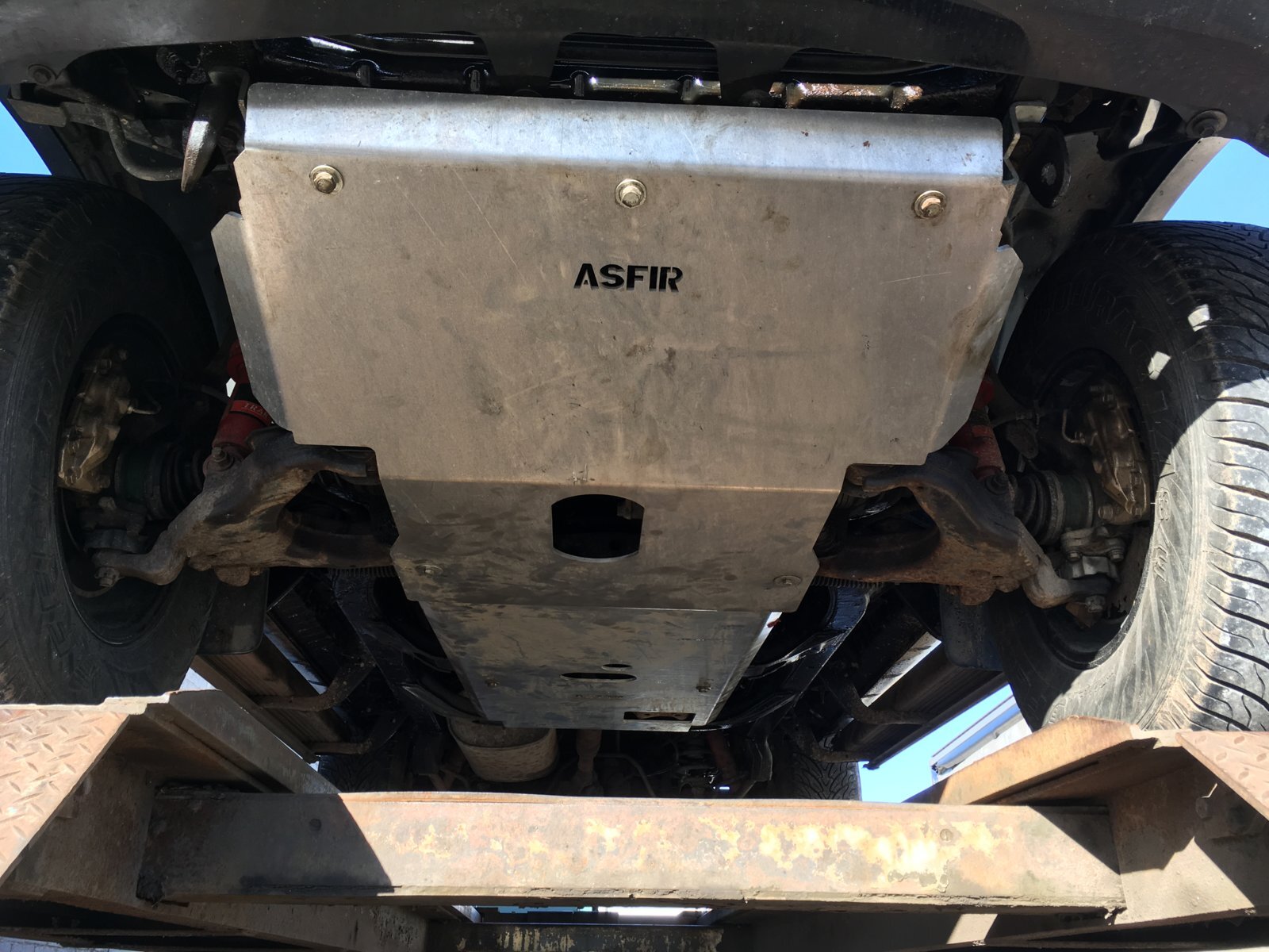

On the black Collie, greased the props again, (I do it every time it goes on the ramp) changed the front diff oil and the transfer box oil. Sprayed every surface with motorcycle chain lube and covered it all up with these:-
This is a really top piece of kit, very precisely made and the only hiccup came with having the remote cooler fitted the pipes had a bit of re routing but it all went together in about half an hour.
Many thanks again to Shayne coming up with them and fetching them to Lincomb .
When I bought the Collie it didn't have a single shield and I didn't know as it was the first Collie I'd looked under and didn't realise what should have been there. To buy some good OEM shields and blast and paint them up wouldn't have been much difference in price TBF.
