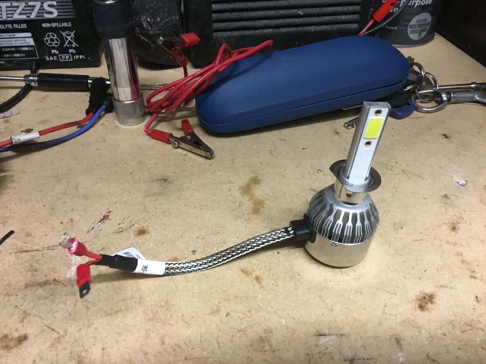

Not really maintenance as such but replaced the HIDs in the inner headlamp housings with these...
Nothing wrong with the HIDs which had an excellent beam pattern but I also have HIDs in the Hella driving lamps and one of the drive units has failed so, thinking ahead to the MOT I fitted the LEDs and used on of the spare drive units for the Hellas. The LEDs give just as good a beam pattern although not quite as bright but brighter and slightly whiter than the H4 LEDs I bought from Woodypeck some time ago. Well pleased for £15 and they’re fan cooled so just have long life.

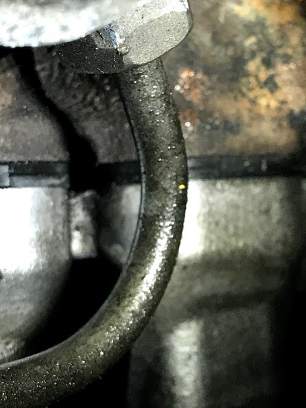

Fixed a diesel leak - I thought it was injector pump related and I was just hoping for something loose as both injectors and pump have recently been services. After spraying copious amounts of brake cleaner to try and trace it I quickly discovered that the leak was coming from well above the pump ... I then quickly checked the oil worried about diesel contamination but that was ok. More brake cleaner being sprayed and I can see it is coming from above the air inlet manifold. I removed the cross over pipe and put 1/4 of a turn on the injector line inlet thingies and it seems to have fixed it. Some of you know my saga using one of the UK popular overland mechanics ... and I feel this is just one more notch on their belt of sloppy work.
This is where the leak was.
