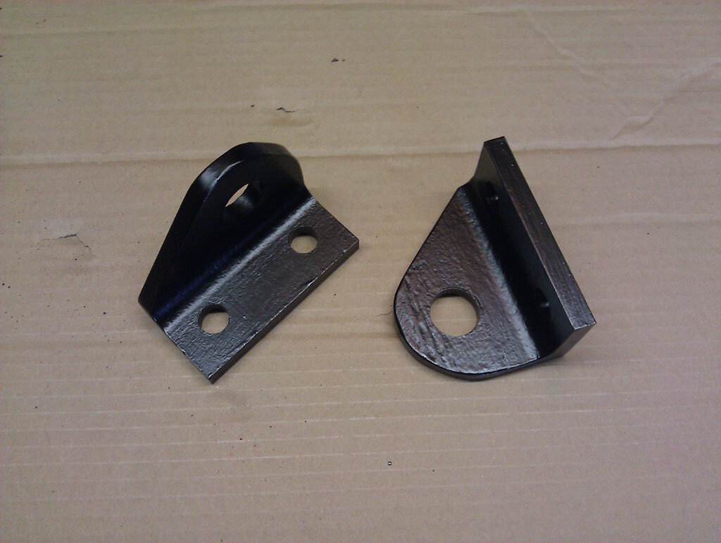

Swivel eyes are fine these just give me more options :) will make another pair now for the rear, same reason :D nothing special, just some 10mm thick angle with holes in the right places.
10 mm? Sounds beefy. Any pics?
That's 10x50, 10x70?
no pics now but I'll post one later. It's 50mmx75mm angle that is 10mm thick, like the OEM bracket you get on the side opposite the cast hook but using thicker steel.
here you go, not very exciting though. I've painted them and that's worth mentioning - used some paint from B&Q called Fortress or something like that and it's very good stuff, used it on the trailer as well and it's like brush on powder coat is the only way I can describe it, it's a bitch to get off again with the flap wheel if you want clean metal to weld to! Much better than the Hammershite I was using before :)
