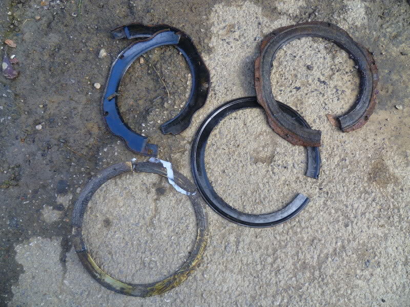

Chris said:
The old seals were stuffed and clearly had been fitted by the now infamous spanner monkeys. They'd slit the felt and rubber washers rather than put them over the end of the knuckle.
The seals on my one were cut like this, no wonder they did not work...

It's OK for a quick fix I guess and in truth Rob, I had wondered in the past if you could do it this way. But I figured it was so obvious that Mr T would have thought of it and must have dismissed it. Now, I did read that someone used that method but cut the seal on an angle and then used super glue to stick it. They said it worked. In fairness the seal ain't great any way. Very difficult to stop water ingress etc. I wondered if it were possible to put canvas gaiters on like some Landies have.
If there was to be a better way and someone was designing a kit to be split, it really would need an overlapping section to give a proper seal. The felt is only a wiper and the neoprene / rubber ring bit is the real weather seal. Having this slit really in the manner that the PO did, really never was going to seal it.
Chris
I suppose cutting the felt is no reason to loose sleep over, but the rubber seal will not sit properly if cut which will reduce it ability to do its job.
Agreed Rob. The felt seal has bolt holes in it to locate it against the metal ring. But the rubber should actually get slightly stretched onto the cannon ball. With a split in, well it just ain't gonna.
Chris
