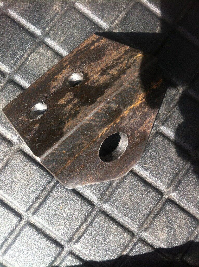

While we were faffing under the truck, we noticed the left rear control arm was bent - oops - so this last weekend I took it off, flipped it over, stuck it in and jacked up the vehicle to straighten it out, (thanks Chris) which seems to have worked, so that's £100 + saved :LOL:
Interestingly, once it was straight it was apparent that the axle was in the wrong place - now I know what a hi-lift jack is REALLY for - to easily jack the axle backwards so the control arm slotted back into position properly - thank goodness for solid sliders to jack against!!
