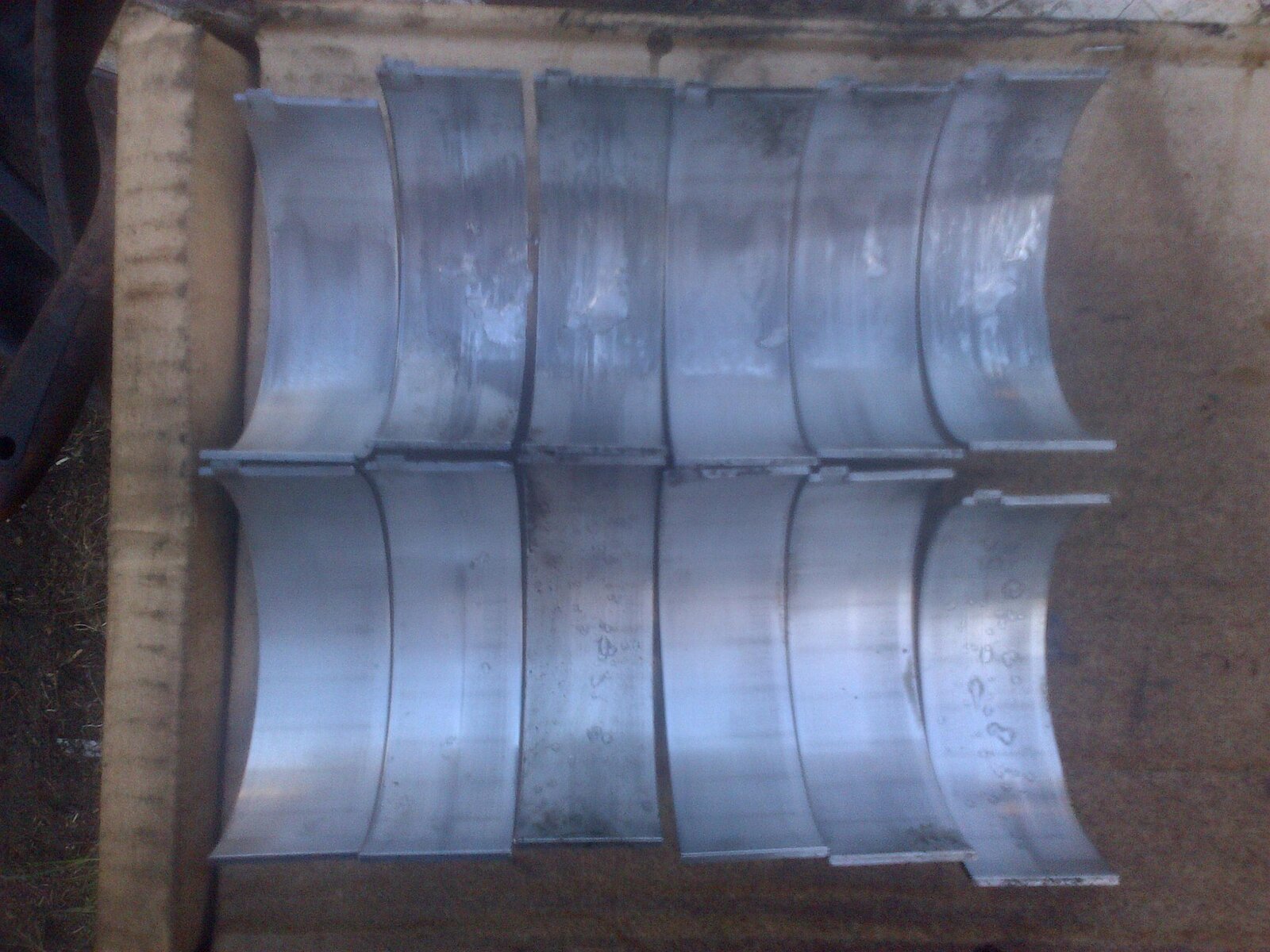

Also changed the big end bearings as i have been driving around with these for a while since Karl posted them to me. Cheers Karl.
In the pictures the bearings are from no1 on the left to no6 on the right. New Forest-20130504-00036.jpg
The truck has done 311000 miles and they look to be original no4s. I put acl standards back in.

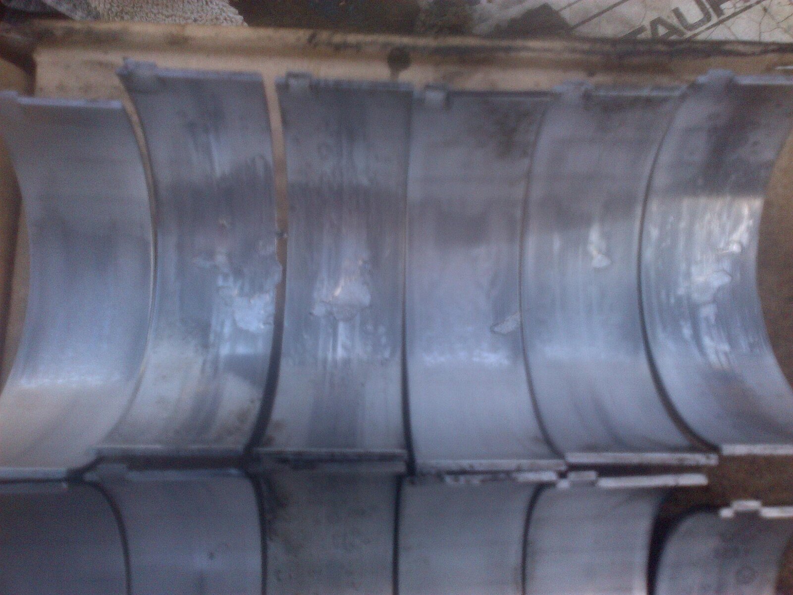

New Forest-20130504-00040.jpg Top line are from the top. Nearly all have signs of wear especially no 2.
I definatley feel this was worthwile looking at what came out.New Forest-20130504-00040.jpg
Mind you i cant tell if they have made any noticalbe difference in the running of the engine, refilled with new oil and filters from Toyotas( Oil price was better than i can get anywhere else) so i have put that in. It cant be that bad if they use it right.
Oil pressure is better but could be the new oil as she was due a change as the truck had done 10000 since last change.
If the photos are not very good i will get some with the camera instead of using the phone.
