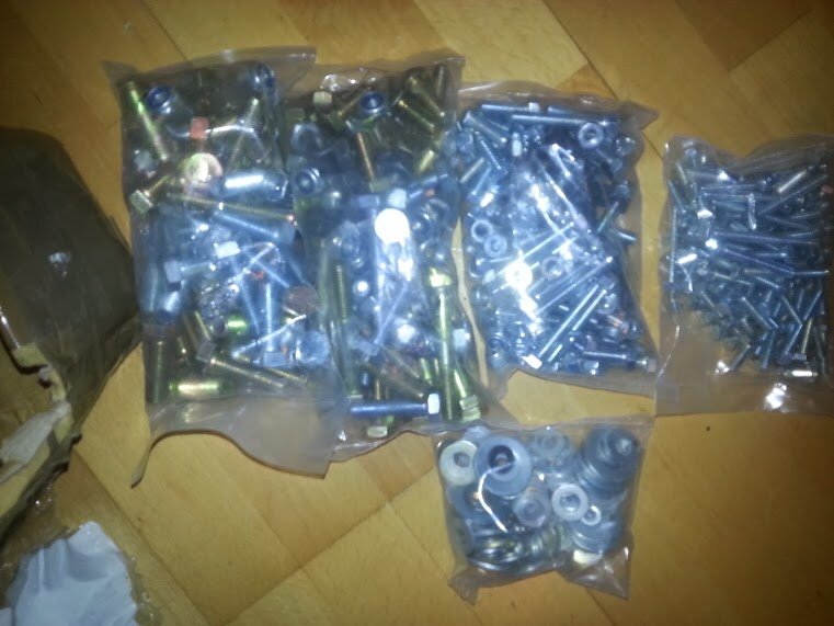

Some bags of shiny new min 8.8 M6, M8, M10 & M12 bolts to work my way through.

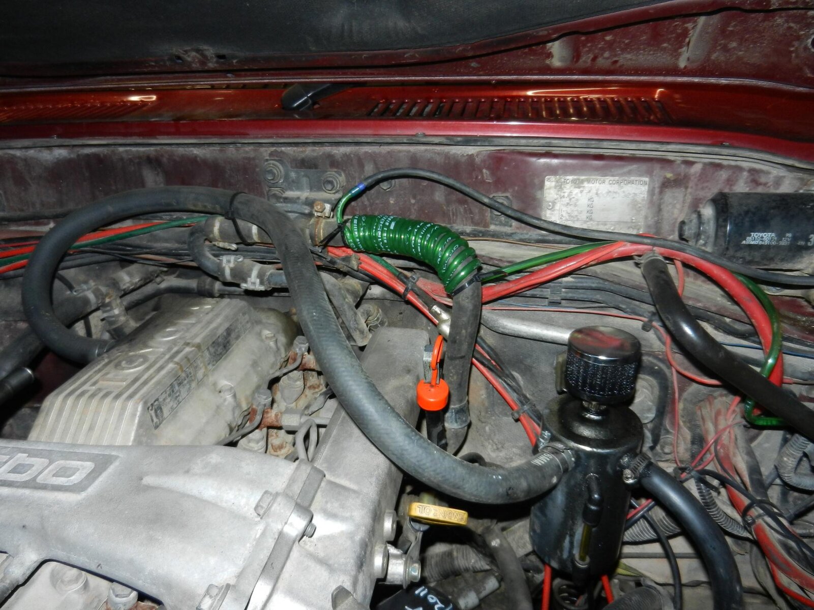

Bought a metre of plastic tubing, it's amazing how much is used up wrapping around a heater hose :doh:, so went out and bought two metres, wrapped around aforementioned heater hose and Voila, I now have sparkly clean windscreen
with heated windscreen washers.

Not a bad idea that, got some washer hose in my tool box :think: washer bottle gets warm but can't hurt heating the hose too
Chas been telling people about that mod for ages. I think that you're the first person to follow suit. It works a treat and costs nowt. I can see steam coming off the windows in winter. I want to heat the washer bottle next.

I'm trying it first as it is, if it's not quite hot enough I'm going to wrap the coils in cooking foil to retain the heat bit more, thanks for the idea Chris :thumbup:, I remember you posting that a while ago.
