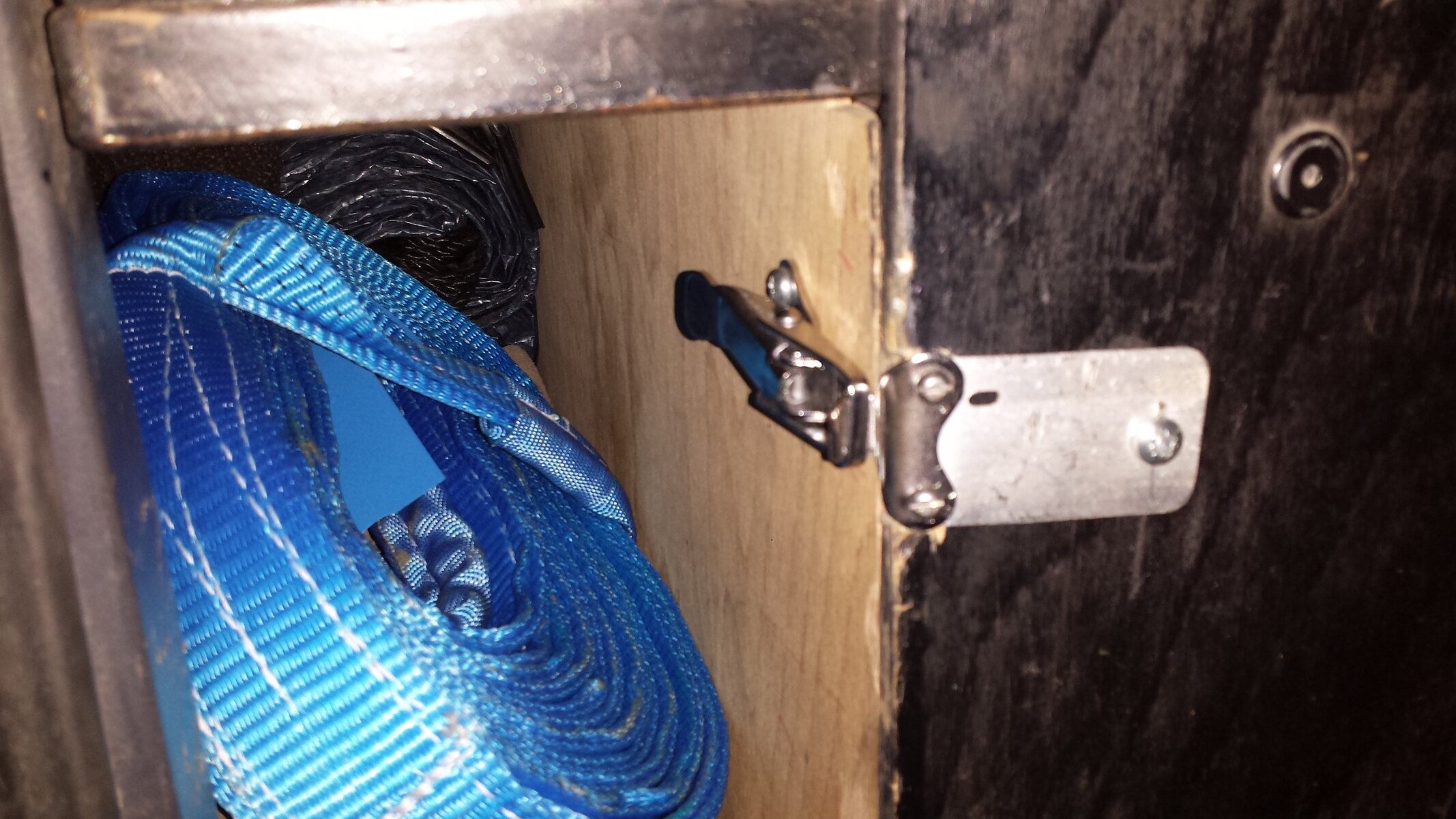

I finally got fed up with the drawers at the back shunting back and forth on braking and acceleration and fitted some over centre latches. Only one pic, but one latch on each drawer. The metal plate is for reinforcement as the drawer front is wood.
