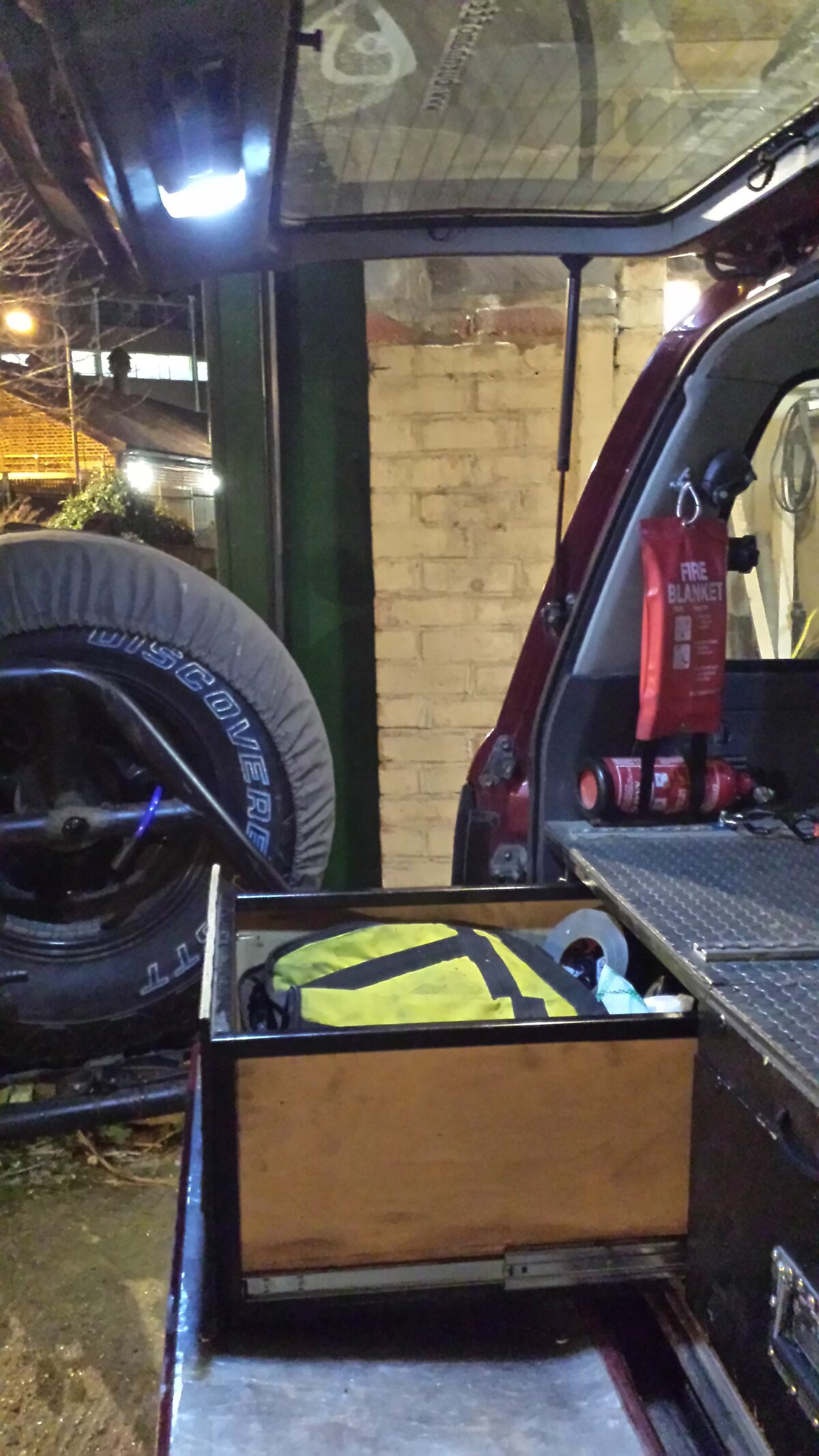

Finally got round to fitting a light in the upper tailgate. I acquired an interior cabin light with the three way switch (modified with an LED panel) and cut a small rectangle out to fit it flush. Wired to the tailgate switch so it's only powered when the tailgate is lifted and doesn't come on when any other door is opened.

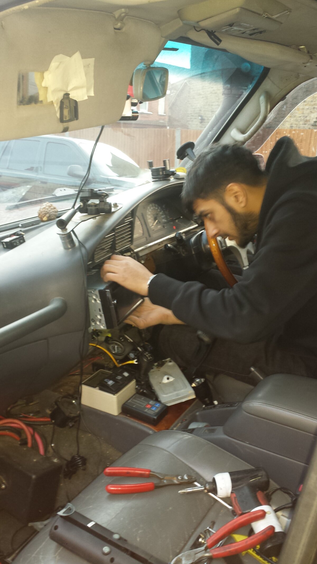

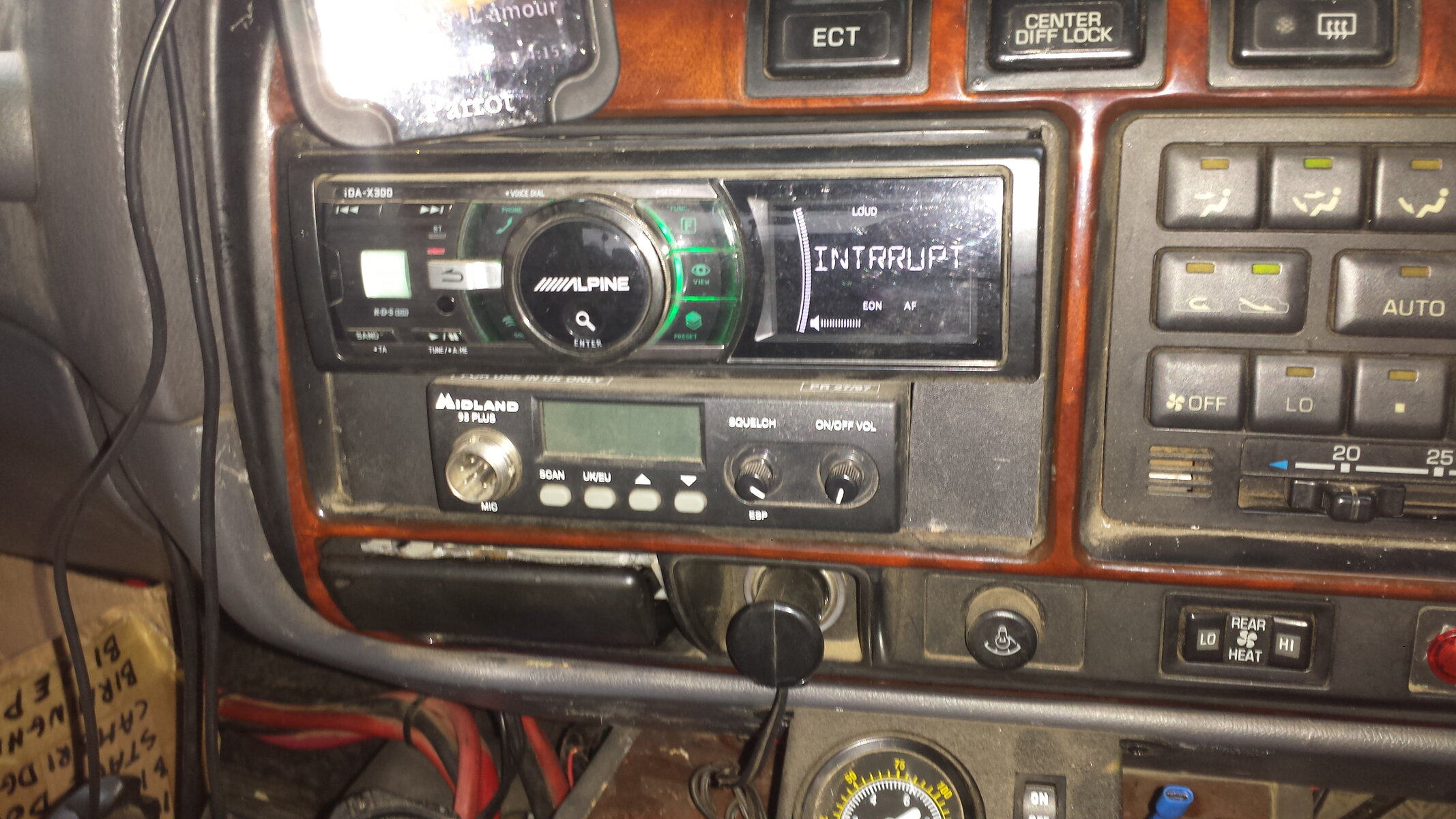

Bought a sooper dooper Pioneer double din unit with a 300w sub woofer for the 80, it's got SatNav (useless compared to the Garmin DEZL) Bluetooth hands free phone facility (not as good as the Parrot though)
but the sound quality is much better then the Alpine it replaced, the CB will have to be relocated somewhere else . . . eventually
and here's the local car radio shop man swapping them over.
and the finished article.
