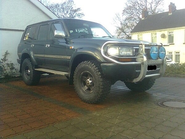

Mickey T's
Gave the ole girl early xmas present with some new Mickey Thompson boots.
Very impressed with these tyres so far. Excellent road manners for fairly aggressive pattern.
