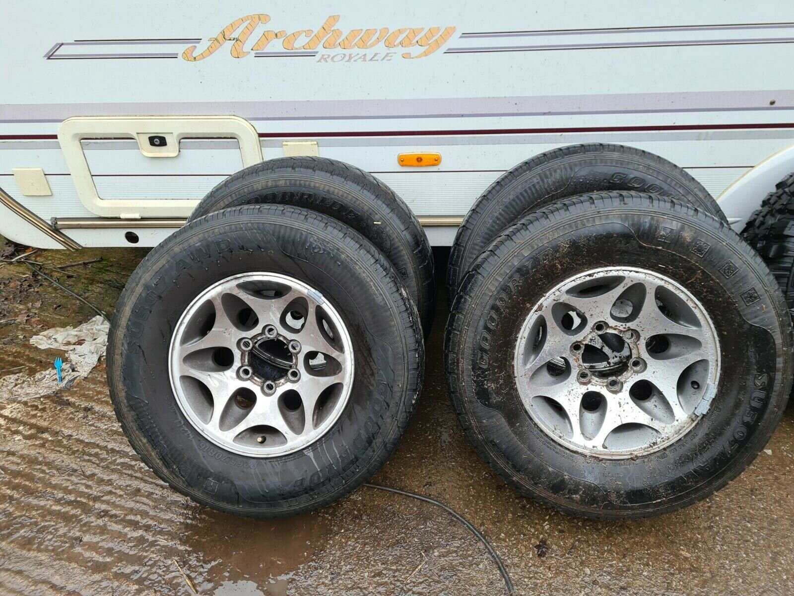

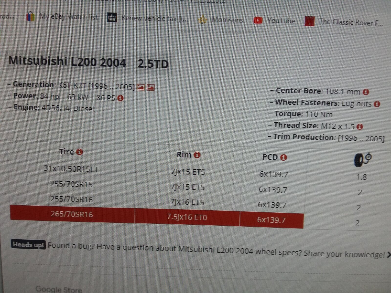

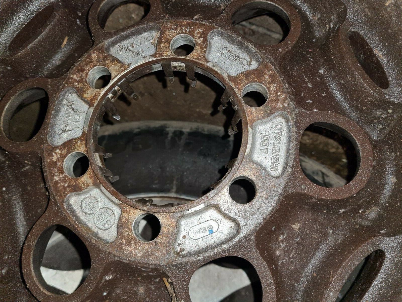

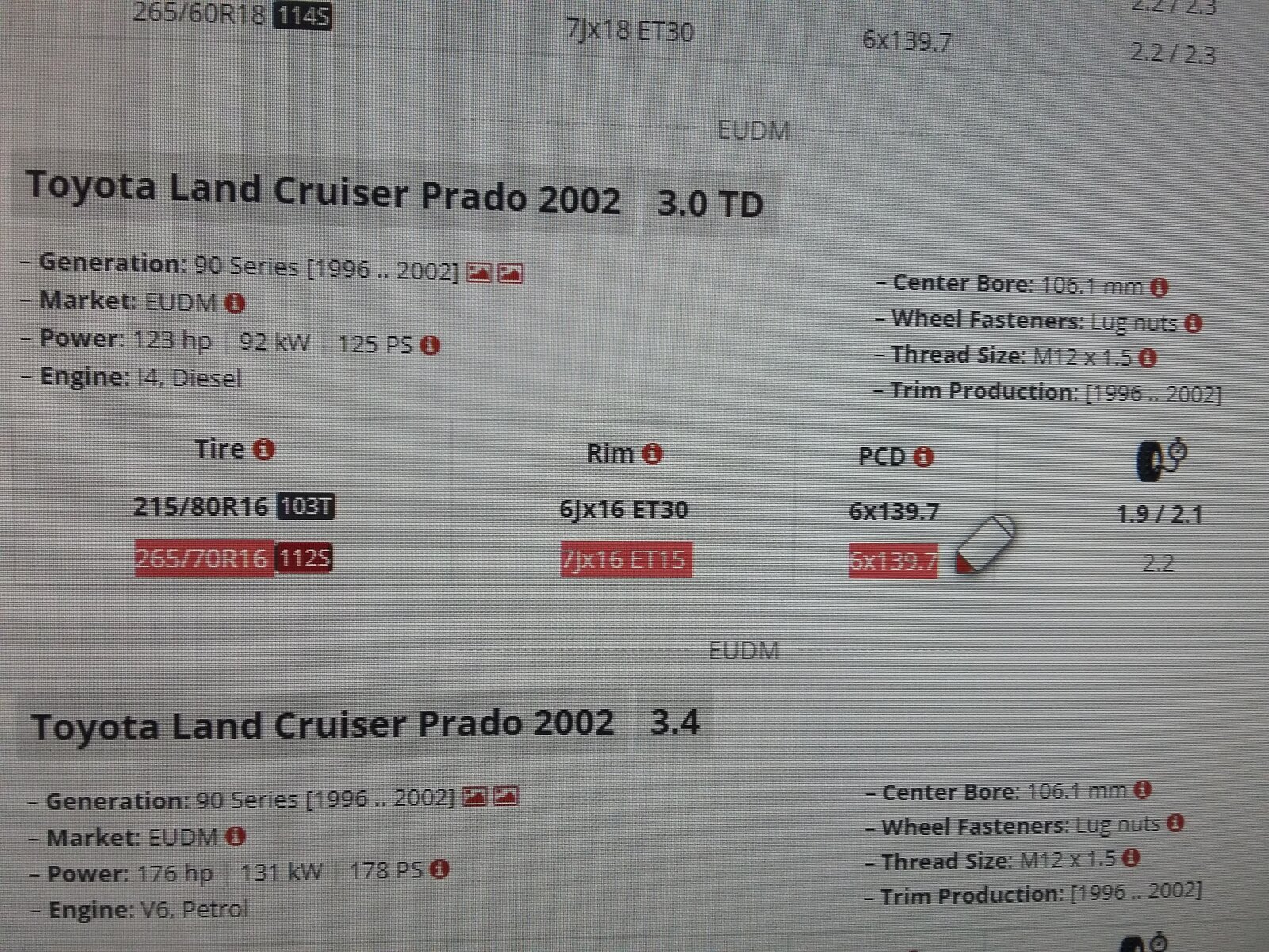

Can anyone tell me if these L200 alloys will fit my 02 Collie the only difference between my wheels and L200 is the offest and 2mm centre bore difference so am i right in assuming these will fit of will i need a spacer or something? any help or advice very much appreciated as you can probably gather i haven't a clue about wheel dimensions
