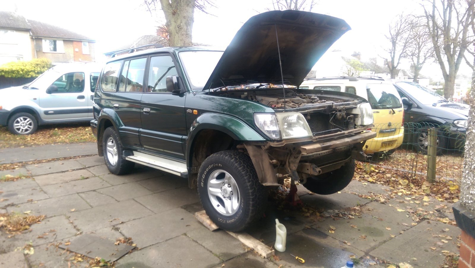

Hi, as I have pics along the way I thought I would share my winch mount build, in time it will become a full bumper.
Just needs bolt hikes drilling though chassis legs on final fitment.

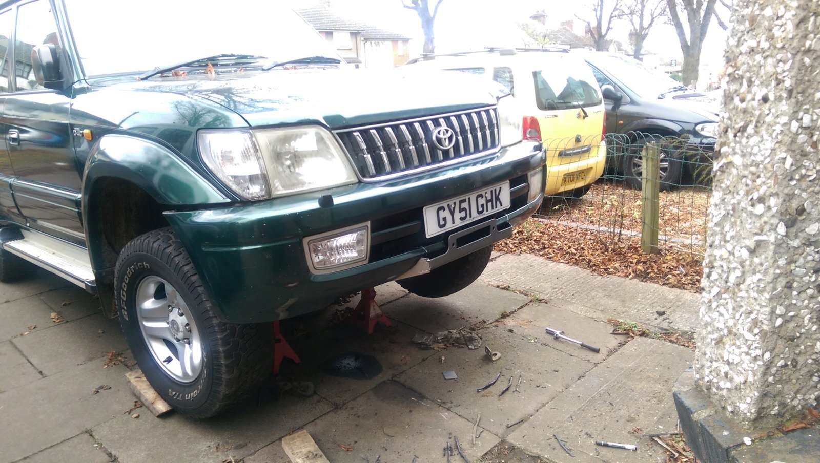

Progress this evening, got the winch bolted in the tray and bumper fitted back on. Planning to use the Colorado for a trip to Blackpool over Christmas so doubtful I will get the winch wired and rope fitted until the new year.
Any battery suggestions and wire diagrams between the two batteries?
