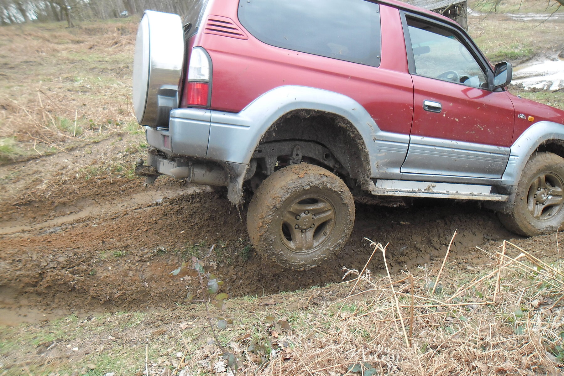

35's aint gonna fit i'm afraid Mr Rust unless you can do a solid axle swap using 80 axles and run the tyres outside the existing bodywork .
Shayne I had 35inch tyres -315/75/16 cooper stt on both my red 90 and my silver 90 an no axle swap took place on either truck :wtf:

Sorry guys i meant without cutting bodywork . I went off to find the pic below after posting to show it could be done but i dread to think how much cutting was involved in this truck
