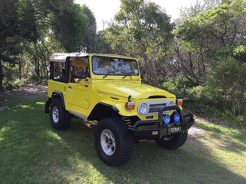

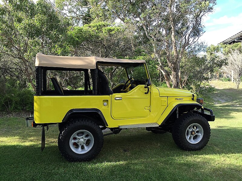

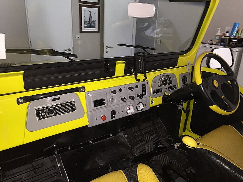

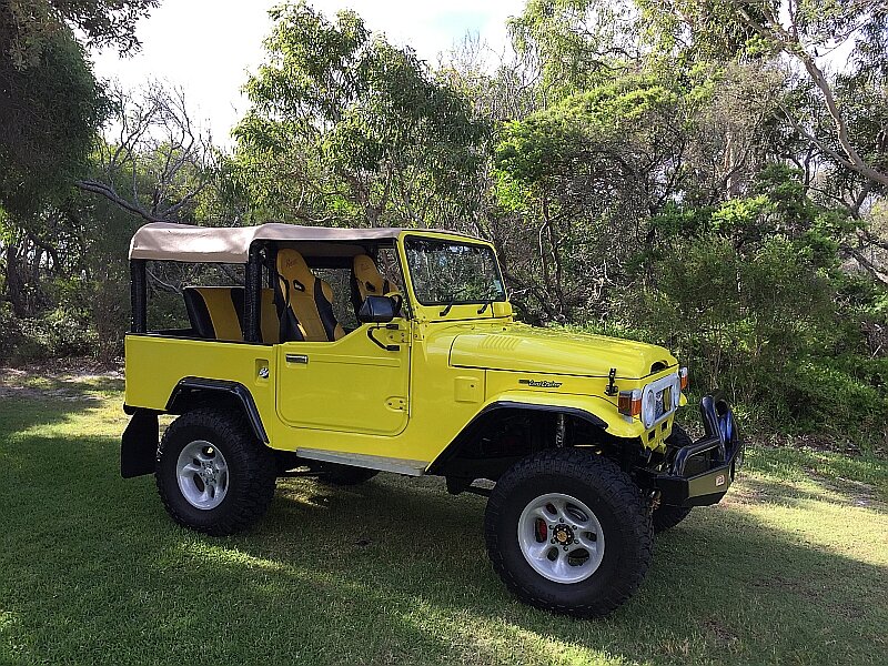

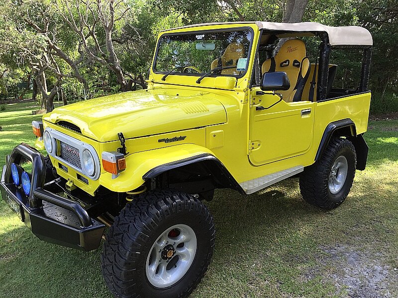

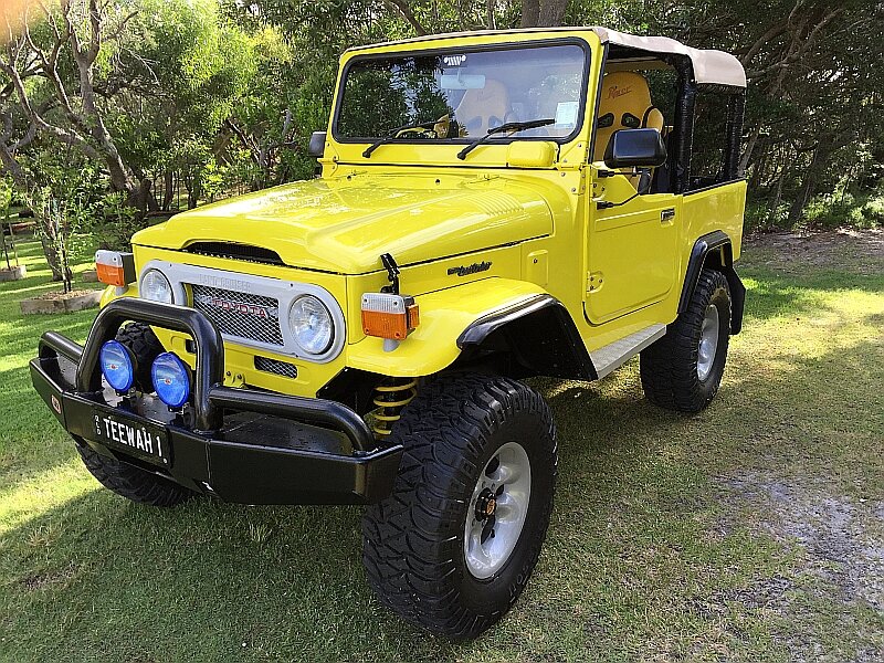

So managed to fully complete the 40 over the weekend, gauges & switches installed.

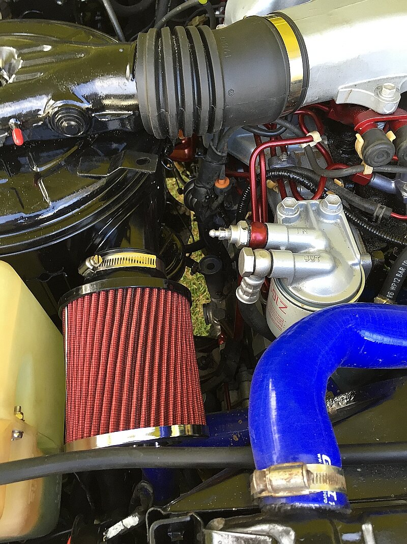

Also added an extra pre-air cleaner as the beach sand gets into everything.

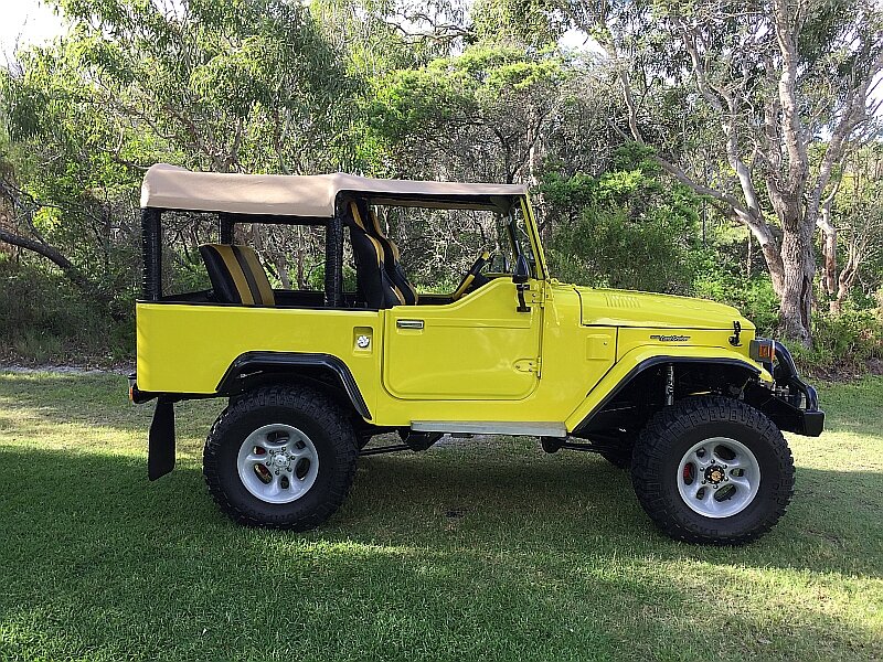

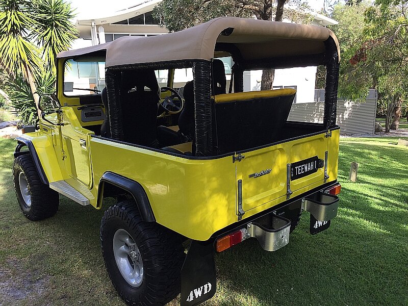

And installed the canvas top.

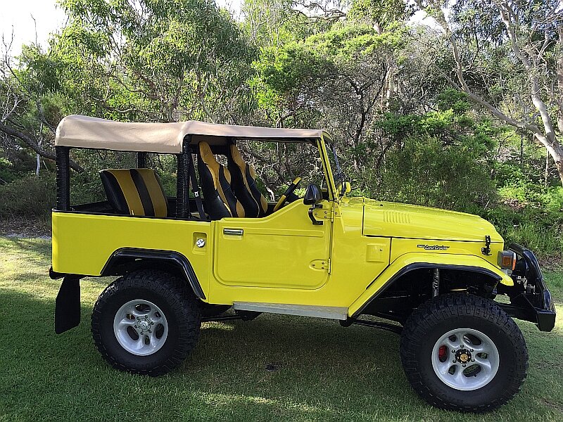

Also placed another set of front coils in to lower the front by a inch.
That is one cool cruiser I love it a big :thumbup::thumbup:thanks for the pics.Tony

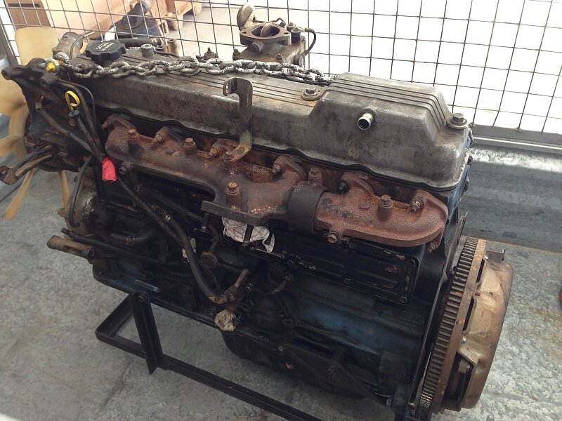

When you finish one you have to start on another 5 year project, so I have a chassis and another 12HT engine, so I will build sister 40?

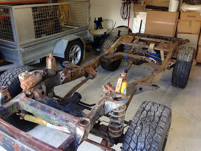

The next one will be the same, extend fibreglass body once again to FJ43 size, 12HT, 5 speed, e-lockers all round on a all coil chassis.

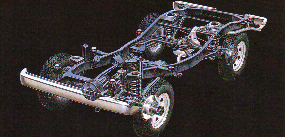

What chassis is that Rob?
At first I thought 80 series but then I saw how the control arms mount to the chassis, so now I'm thinking Bundera maybe? :think:
Could I ask you how you find the Baja MTZ on tarmac? I am looking at the ATZ or MTZ and wondered what you thought of yours so far. They don't look too aggressive.
Your right Ben, its a RJ70 Bundera, wheel base at just under 93", so instead of putting 80 series suspension on a 40 series chassis like I did last time I am using the RJ70 chassis I have.

The MTZ's work well in the soft beach sand and I run them at around 17lbs. I don't do a lot of tarmac driving but they seem ok but I don't drive it much over 85kph on tarmac as I don't want to over heat the tyres with 17lbs in them. These MTZ's are 8 ply wall but if your driving more on tarmac and don't want to chop them up to much I would go ATZ.
I will buy another set MTZ's when these are worn out but it will probably take another 7 years for that to happen?

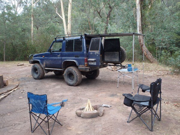

Hey Ben, liked your rear awning so I ordered one, 1.6m wide and 2.5m long?
Going mount it here?
I have one of those style awnings too and have been looking at cutting down and doing the same thing with it. Looks pretty easy to do but the cover isn't so simple. I may have to get my local canvas place to do that. Or just not bother with the cover I guess
