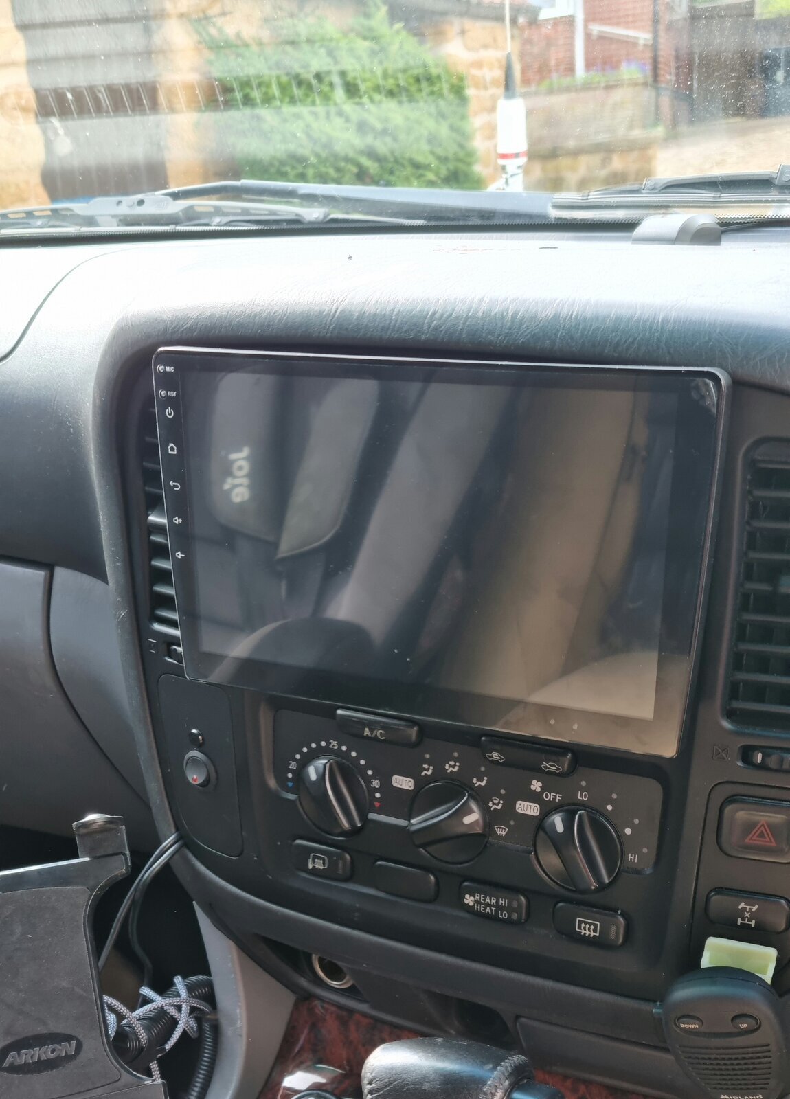

So I went with a 10.1inch Eonon unit which seemed to have great reviews. So far so good.
For £20 I might see how good the OBD reader, is even though its a 2001 and £40 for the DAB+ module.
Anyone know of an mOBD2 Bluetooth unit with no password?

@pugwash i didn't have the nav unit. Old dash syle with pocket and tape deck with CD changer.
This android unit has worked well for me.
