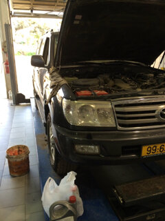

If you put in front springs which are designed to carry the whole load of the front, you will loose all damping, i.e. no shock absorber function. The 16 step adjustable damper (aka Actuator) requires a certain pressure and movement of fluid in order to work.What if I replace torsion bars to OME ? How it's going to effect my AHC ?
Note that I do not want to give up on the AHC but would like to get less tumbling at the front
I assume Globes=Actuators ? ...work as accumulator??
If they are kind of accumulators and their membrane wears off then the pump should show some warning like high temp
Since AHC link to VSC / TRC I assume there will be other warnings as well - do you know what will be the default warnings for imbalance between struts ?
Warning for pump?
Still looking for specialist in Israel ...

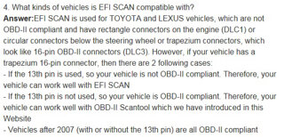

Meanwhile bought icarsoft i905 which should be able to monitor AHC temp and pressures
Will check with Techstream too
And, btw, if the gas globes loose some pressure, the suspension will be harder, not softer. The AHC pump will keep the pressure up to keep the set height, and when the globe looses gas pressure, the membrane will start to bottom out. (When the globes are completely shot, you will have no suspension at all, just four stiff struts, but still full height control)
