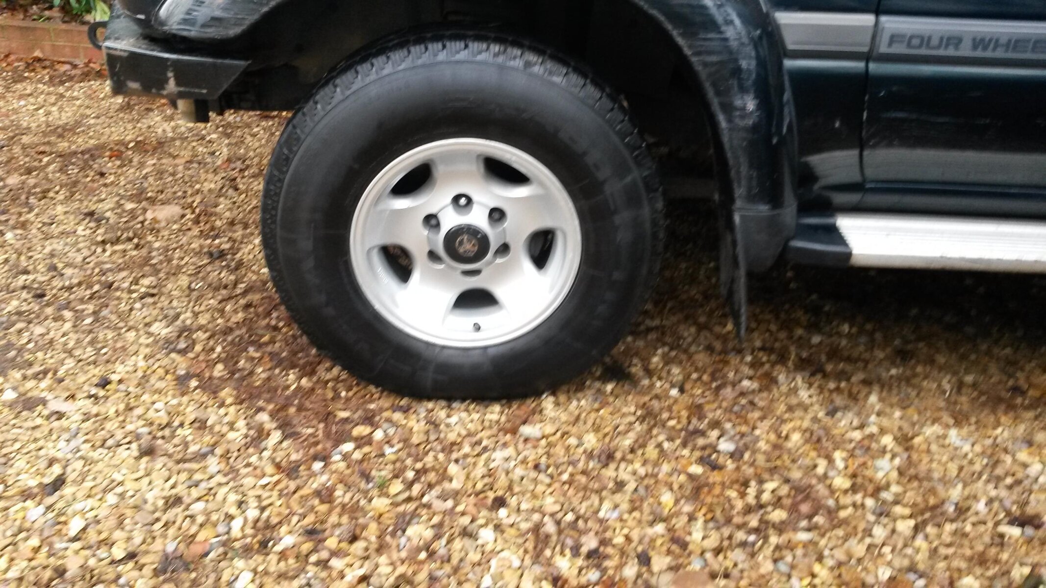

IMHO, all wheels should be properly balanced, too many tend to only worry about the front wheels when out of balance rear wheels overload the dampers (shock absorbers) and can generally shake the whole truck.
