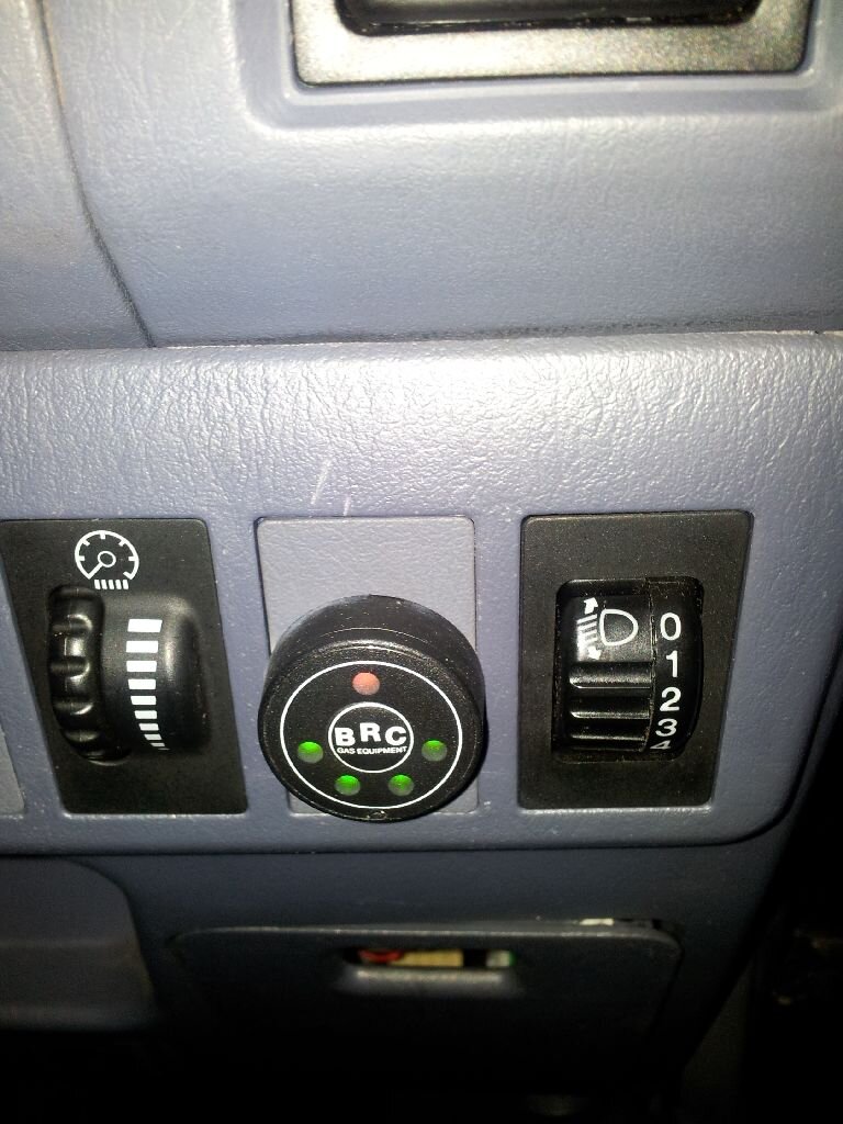

On mine, there are 4 green LEDs which act as the LPG tank gauge. When all 4 are lit, then the LPG tank is full. They go out one by one as the tank empties. When it gets to the last LED, it doesn't go out like the others but flashes for a while. Then when the LPG tank is empty, this light stops flashing and goes out, a buzzer also sounds. The system then switches over to petrol. The tank indicator/gauge lights and the LPG on/off indicator are all in one small button/unit. I'll pop a pic of it up in a mo.....
as promised (though probably redundant now).

I don't think the gauge is 'faulty' because it reads full when it is full but tends to read low as gas is used even though there is plenty of gas left, I had this checked by an LPG specialist at Capital Autogas New Malden, Surrey KT3 3NE and he tried re-setting it via his laptop with some success, but while watching him it did seem to be a fiddly job. He also fitted a new sender in the LPG tank. Strangely I had exactly the same problem with my Lexus.
