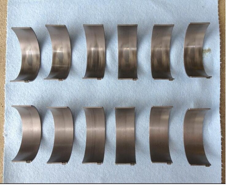

BEBs changed - picked up a little on piston one else looked pretty good for 180k. Still ticking though :icon-cry: - oh well, at least thats the BEBs done!!!!

i have changed a number of these out now and most were fine but some were bad to terrible.

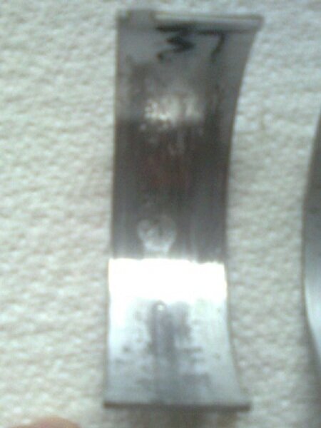

I was cursing myself for listening to rumors and getting into this filthy job as all my shells came out looking like new, hardly any marks - until I pulled #3 and there I had a good size crater in the middle of the top shell.
Hard to tell from the crap image but the crater was well deep...
