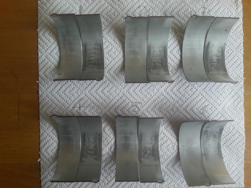

Finally got round to doing my BEB replacement this weekend with help from Rob - massive thank you again Rob.
I know how much you all like photos so here goes...

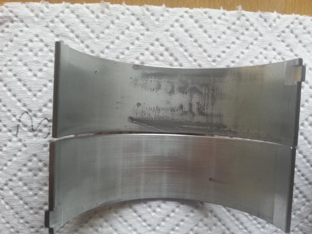

All worn, particularly the tops and all have a small pit but not nearly as bad as some others on here:
The worst one was the top on #3;
All replaced with ACLs so that is a weight off the mind. Next job is to find the leak in the power steering pump.
