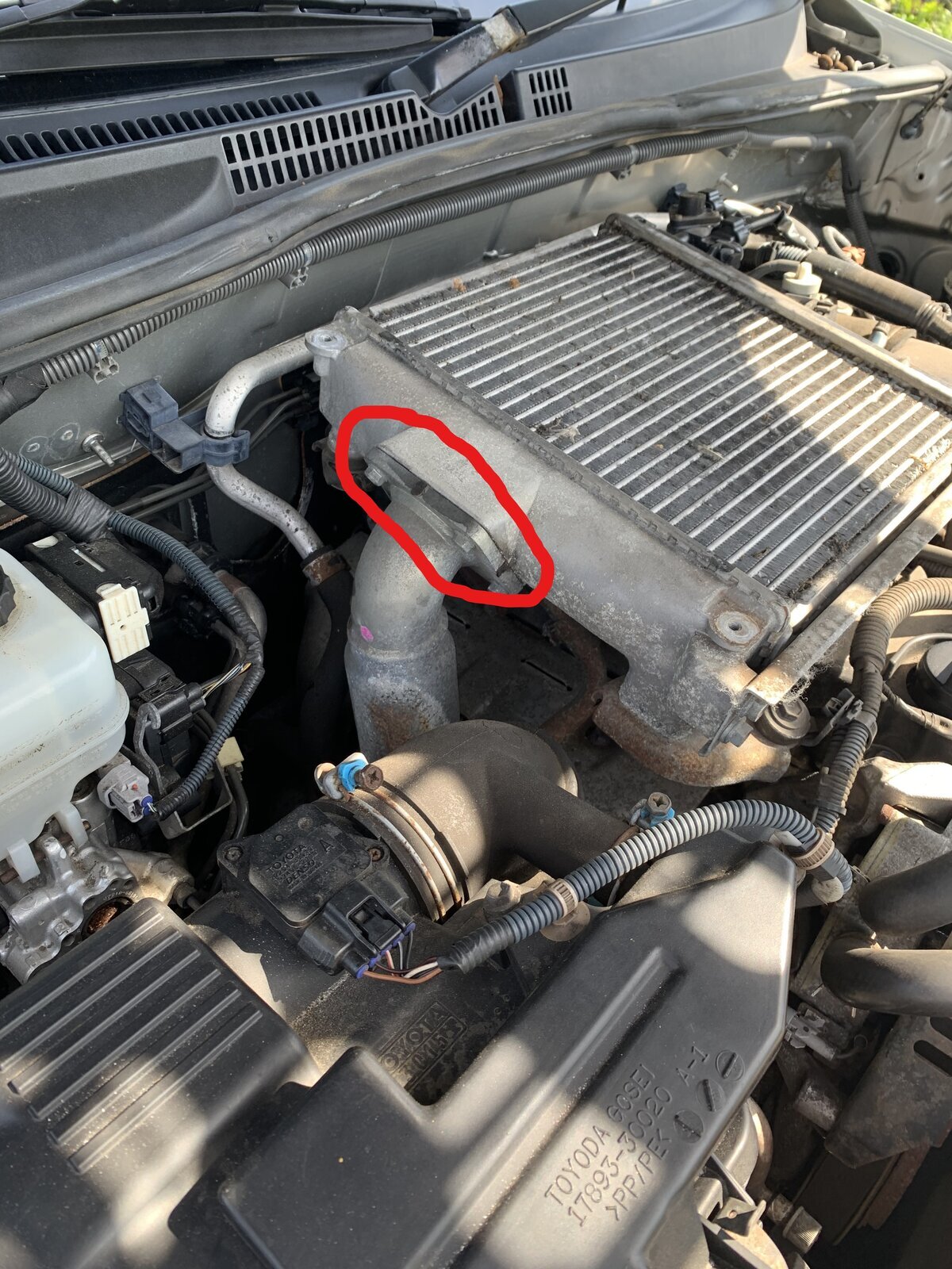

So before starting on anything at all, I've been trying to find out exactly where the squeal is coming from. The noise is not coming from belt/pulleys (although I do think one of the pulleys is worn). It seems to be coming from around the engine, one of the gaskets seems to be worn. When you stand facing the engine, the turbo pipe (I think that's what its called) going into the intercooler, the gasket on that seems to be the culprit. Would that make sense or am I just making assumptions that don't make sense?
Here's the image of where I could kind of hear the noise coming from.
I'll have to check tomorrow morning again to pinpoint it but just wanted to see if a worn/old gasket on that pipe could result in such an ungodly sound?

There is no risk and very easy to remove that. 4 bolts and it's free, the pipe has movement in it so you can inspect that easily.
I'd be surprised if it was this though
I remember my cousin here in Cyprus removed the intercooler on his 3lt hilux to cleanout the egr valve which has the same 1KD engine as the 120 , and he removed the 4 bolts where you think the noise is coming from instead of the top jubilee clip at the turbo lower down , well when he went to bolt it back because it was very tight when he was undoing the 4 bolts it wore out the aluminium treads and would not tighten up it hissed and leaked , he solved it by putting PTFE tape on the treads of the bolts , , but from then on he says he will always undo the jubilee clip instead of the 4 bolts on the intercooler I wonder if that is your problem and its caused from that by its previous owner or garage and the gasket is leaking air , also look lower down the pipe in case any of the two jubilee clips are loose . if so its a cheap fix if either end is loose or leaking ,

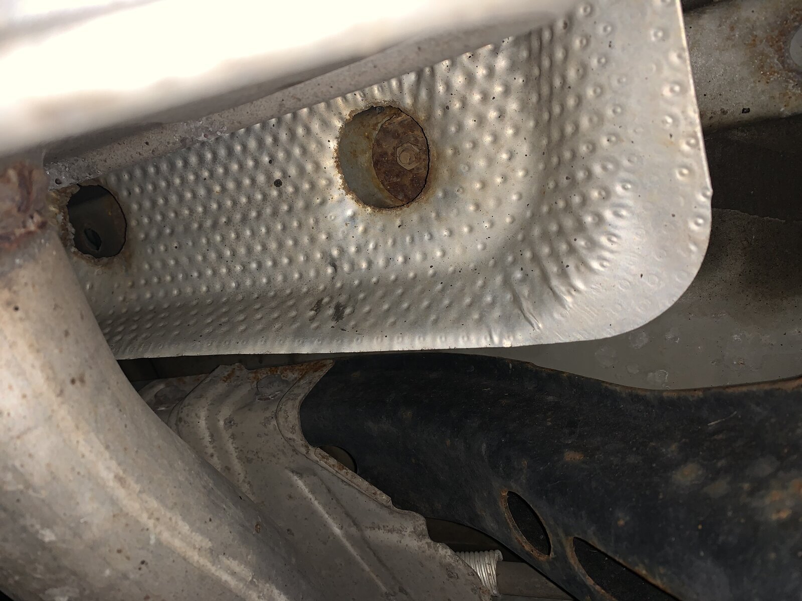

Now that you have said that , if I were you just get under the car with the engine running and check that any of the heat shields are not loose and slightly touching the exhaust and vibrating as they can come loose and need a bigger washer for the nut to hold it in place .

I THINK I've found the culprit. As TonyCY11 said looks like a heat shield has come loose.
I guess I should now go find some giant washers as those big ones aren't enough any longer...
Either way, if this fixes the noise problem, I'm going to be a happy man.

This morning confirmed that that is the exact problem I have along with the heat shield. Holding the heat shield up stopped the rattle, holding the exhaust pipe up where the joint is stopped the squeal.
