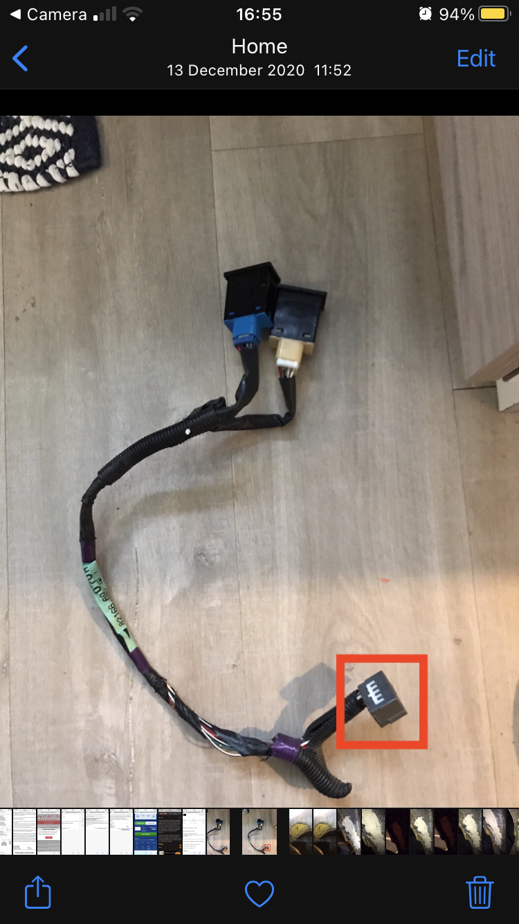

Love the leather seat swap!! Did you do the heated seat control as well?
How did you wire in? Did you find ready connectors hiding in the centre dash near the gear stick? Or you wire them yourself?
The plug is in place but the length of wire with the connecters to the switches from a VX is needed.

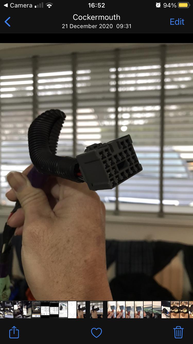

Thanks, I got the VX cables that looks like the photo below. Am I still missing another part of the cable? I tried looking around below the ashtray area but couldn’t find anything that matches the grey end connector in the second photo.
Where do your blue and white connector cables run to?
Thanks

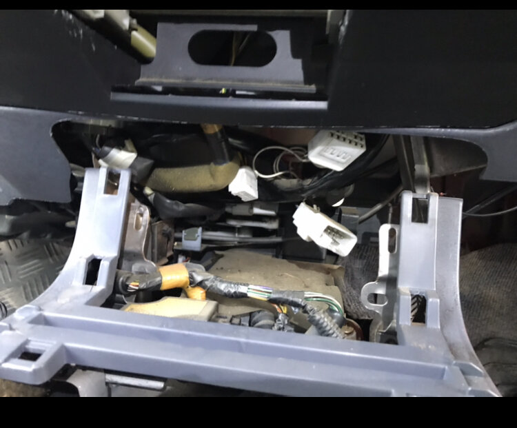

The wire to the right is for the 2nd start/ pwr botton and doesn't have a plug as its part of the loom and they all have it.
The wire to the left is for the heated seats, there is a blue based switch and a white based switch. It has the two plugs at one end and the master plug on the other. the socket for that is about level behind the front of the console on the N/S. I can't imagine its not there even if its an import. I got the wire with the console when I got the interior so I got the heated seat switches.
As regards the wiring to the seats, its tucked away under the carpet under the seats, Id be amazed if it wasn't there ready to plug into the seat socket.
Thanks AndycruiserguyLomas, for the Master socket, when you said behind the front of the console on the N/S, you meant behind the AC control knobs? I did have a look around mine below the astray but didn’t see the other end of the Master socket. Picture below looking towards the front of the car below the astray. I can see 3 white plugs/sockets.
I will probably have a look behind the climate control of mine.
Will also have a rattle below the carpet under the seats.

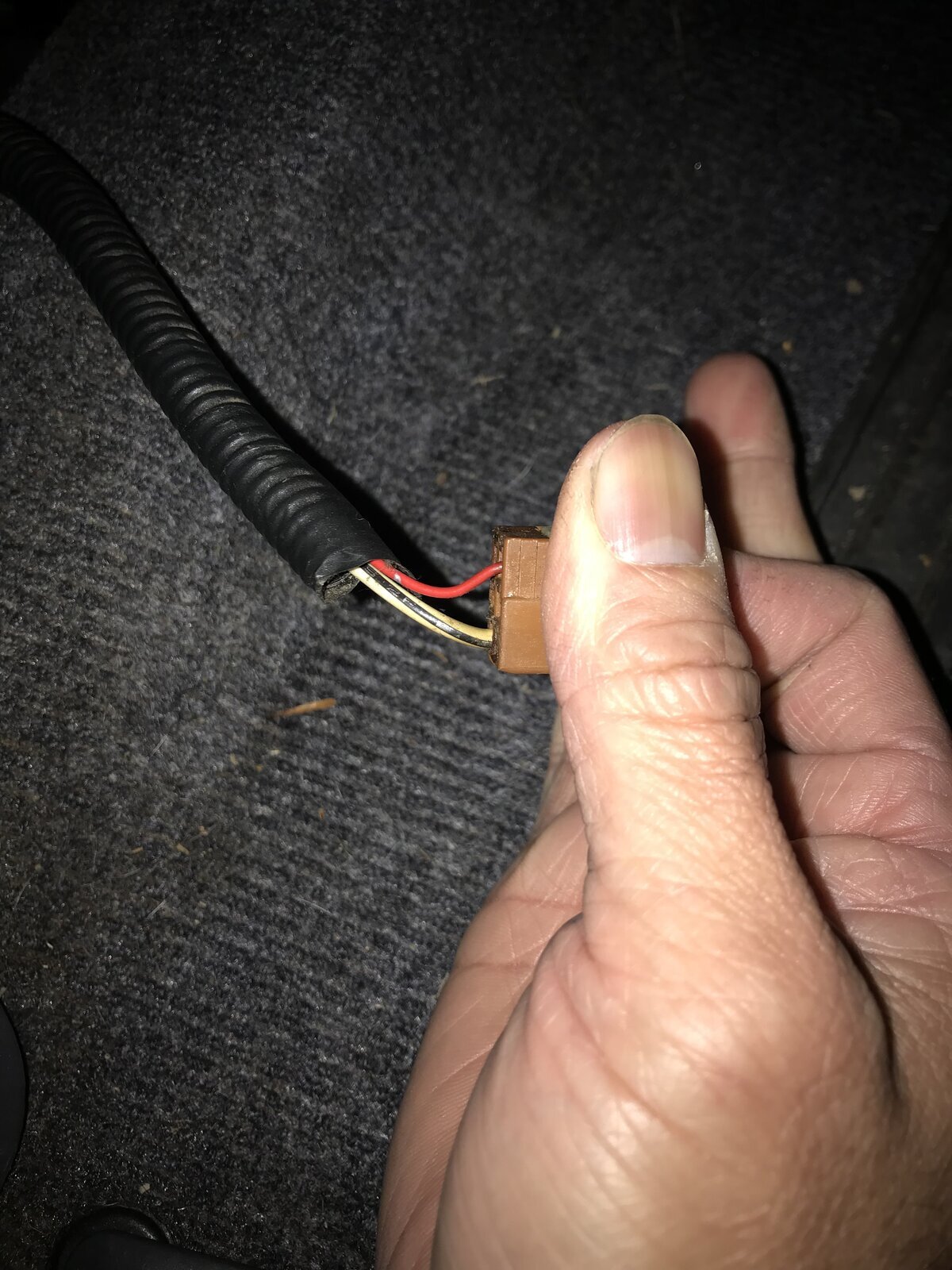

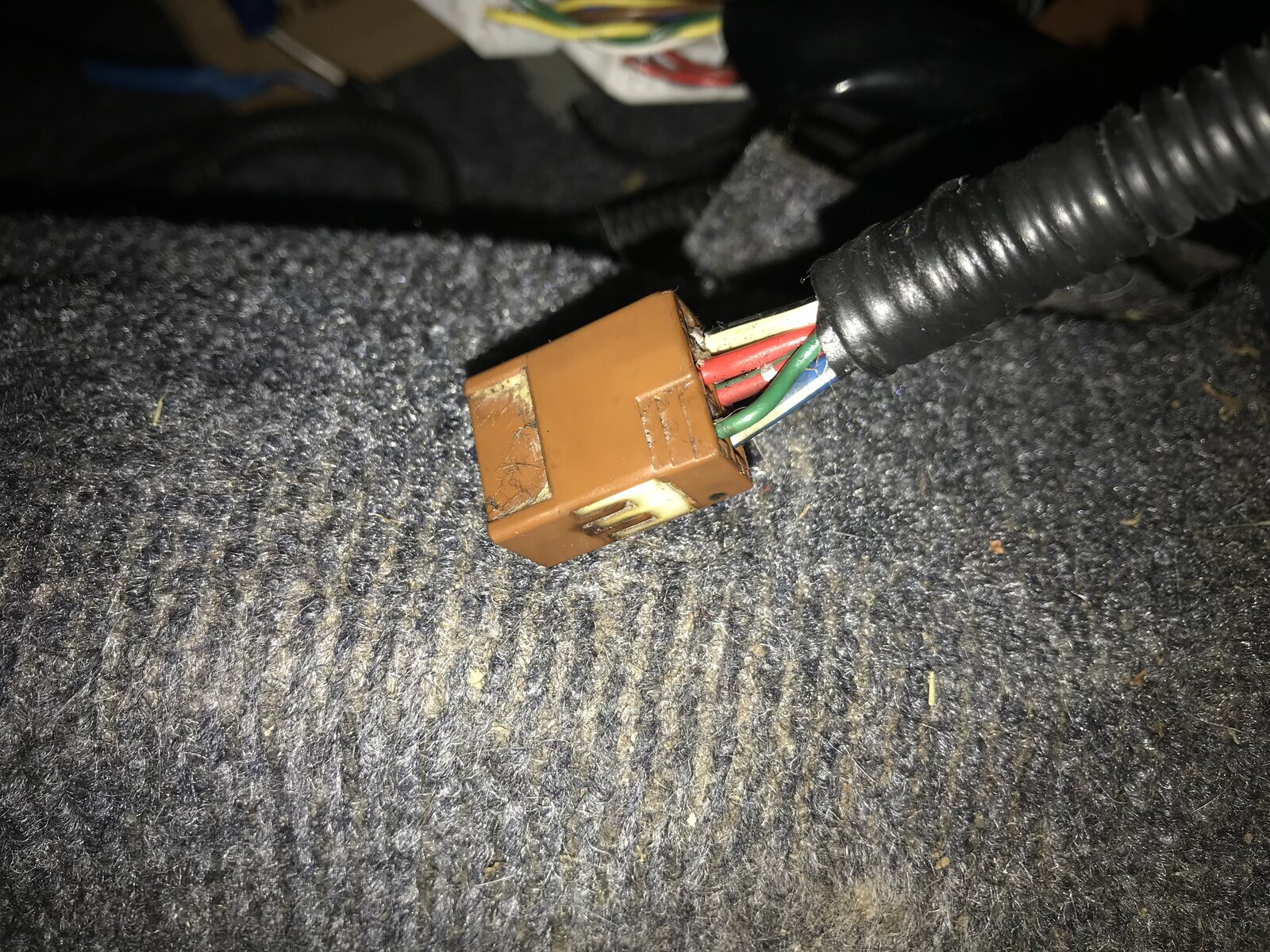

Hi AndycruiserguyLomas, I found all 3 plugs!! 2 brown and one big one at where your photo says. Big thanks
However I have a question, the passenger brown plug below the seat has the same number of wires as the female end from the seat, bingo! See first photo.
However, the brown plug below the driver seat only has 2 wires?? See second photo. The female end from the driver seat has 4 wires. Am I missing something anyone?
