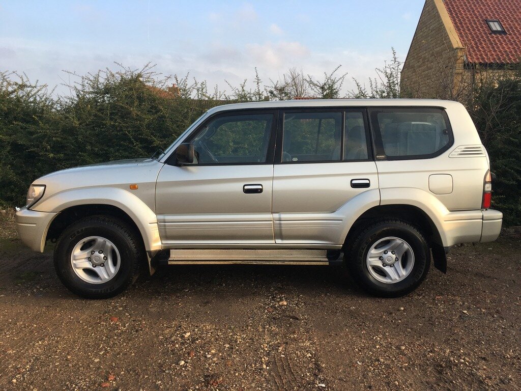

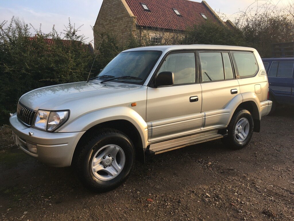

That was a great read. A photo of how she looks now would be good:)
Also looking forward to hearing about the mpg.
Will get a couple of photos up shortly, will monitor fuel to see how it compares with the D4D compared with the ratio of what I have in them moneywise. At the minute I have 4x as much in the D4D as the V6.
