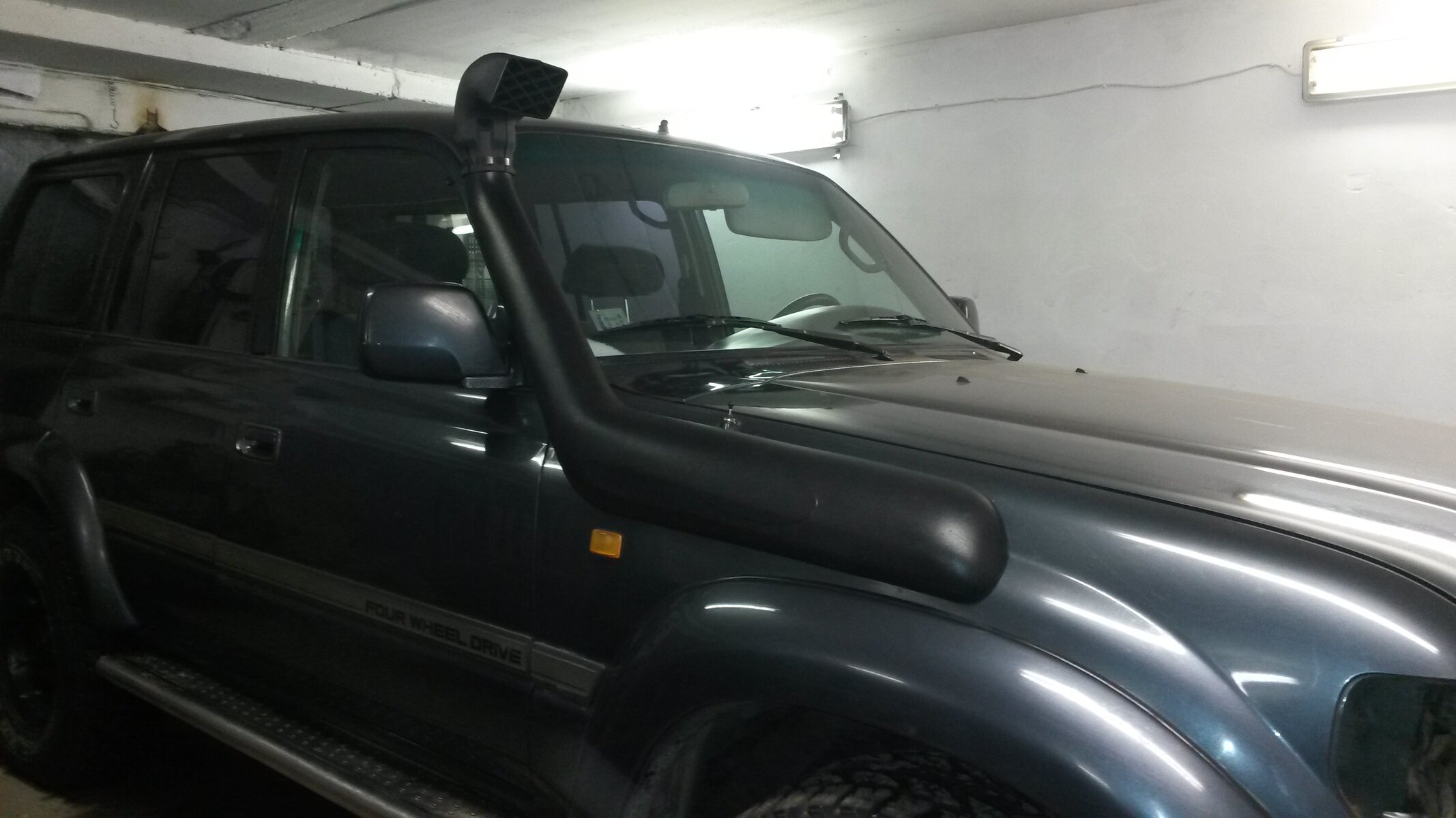

Don't start thinking I'm a rivet counter or brand name victim, I'm not. If it works it gets the job.
However, there are currently some cheap snorkles on eBay, cheaper than I could make a stainless one for so I took a chance.
The plastic doesn't seem bad, tough but not brittle.
The moulding quality doesn't seem bad but the top is too big for the scoop.
The moulded in rivnuts seem ok.
The scoop feels as brittle as hell, I don't see it lasting.
The fasteners are ok, mostly an unknown grade of stainless but seem ok apart from the top mount bracket screws which are black self tappers.......
And finally, the template........
You would do better by blind guessing. The main hole is 20mm too high and the mounting holes between 10 / 15mm too high, low, left or right of where they should be.
Be warned, £80 is cheap for a cruiser snorkel but to my mind what they should cost, however in this case the cost does represent the quality.
