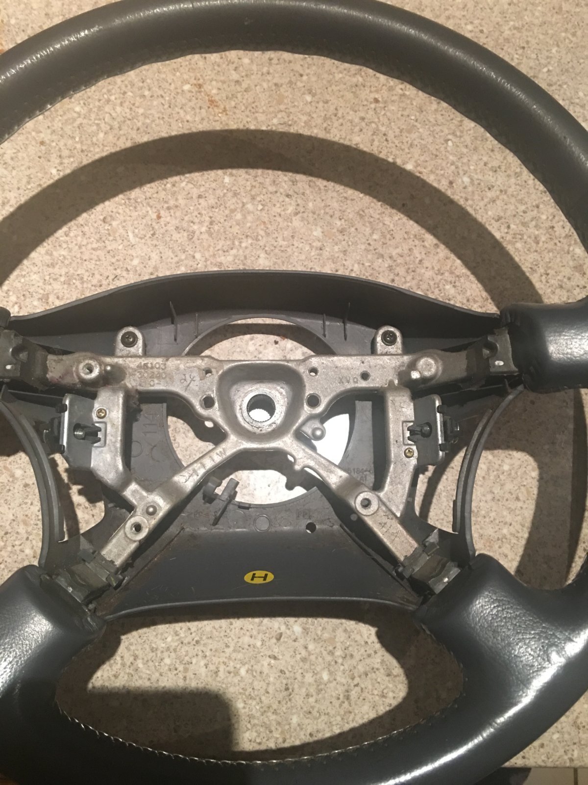

hi , I have a d4d 2002 kdj95 , without cruise control ! when I took air bag my steering wheen also dont have the suporting bracket. I ll get the stalk ( item number posted above ) but how to make that frame ? Anyone know if Incould just buy it ?
If you get a petrol CC switch it will have the bracket and work in a roundabout way. The one I ( and others) used won't fit the bracket of the petrol and has to be made to fit. I held mine in the right location and drilled a 6mm hole in the steering wheel frame and fastened it with a nut and bolt in about 5 mins.

thats my steering wheel , with no bracket

that clip what is there for to suport thr stuck ?
so sorry , so you just drilled the metal frame and added a bolt and a nut ?
