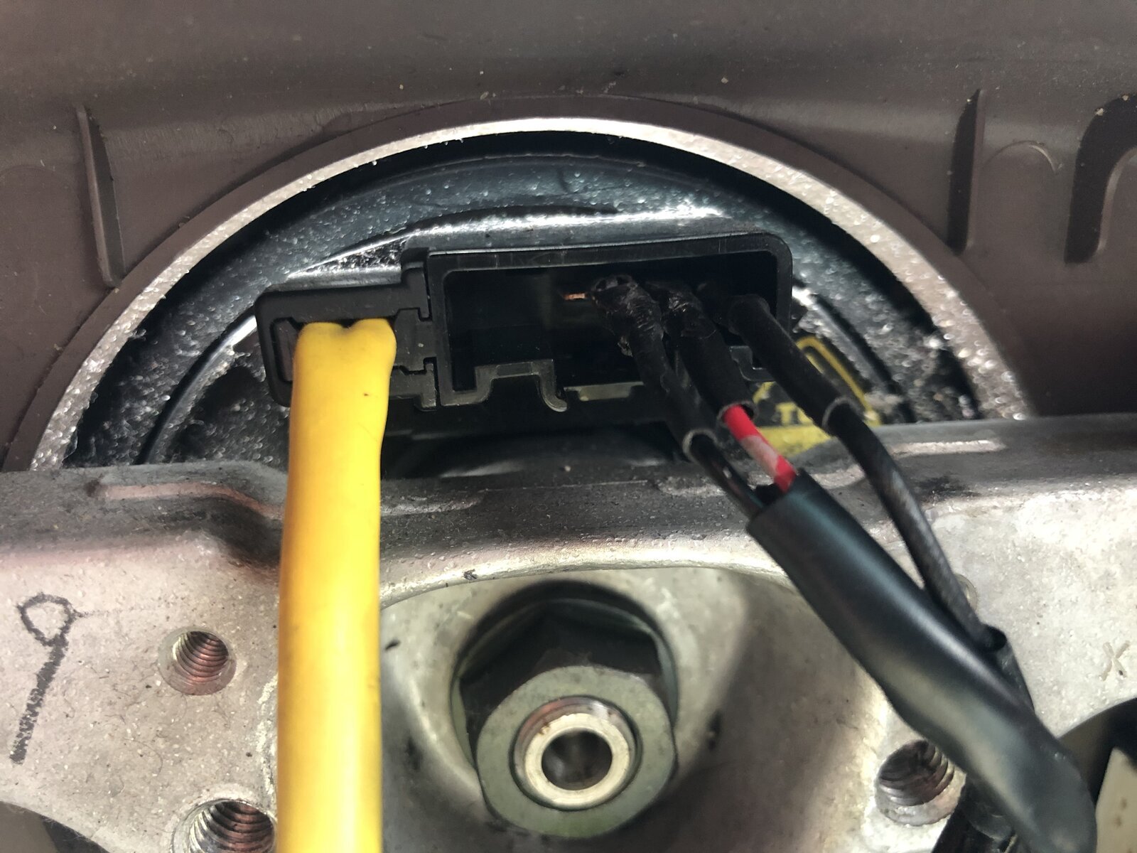

I couldn’t find a way to use the original plug so I used small spade connectors & insulated them using heat shrink.

Hmmm.. I wonder is that the issue. I used the original plug by taking pins from elsewhere although if everything is connected it should work. I just wonder if its making a good contact
Well the horn works & you can't really make a bad connection. Even if the connection was not great, I think you would still get some evidence of a connection like at least the cruise light but I have nothing at all. I'm at a loss now like I should just give up but I really want cruise or the 90 will have to go ha ha.

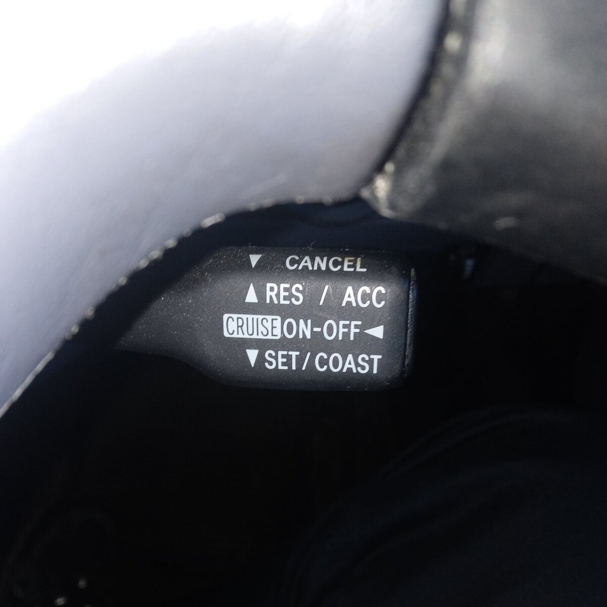

This is what my Australian domestic market one looks like. Not sure if you get symbol based ones because of Europe or what.
