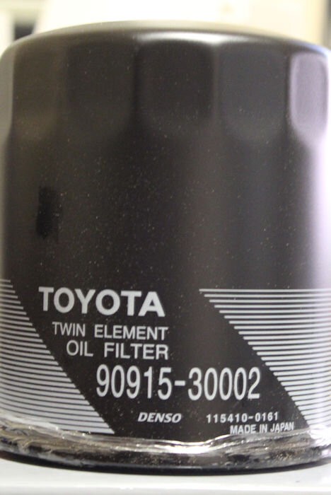

This is a genuine Toyota oil filter for my 80 in Australia. I know it is genuine because it came from Toyota and I just took the photos but I don't know how you are going to distinguish genuine from copy in your environment. There's no hologram but this box is about 10 years old so the new ones might have it.

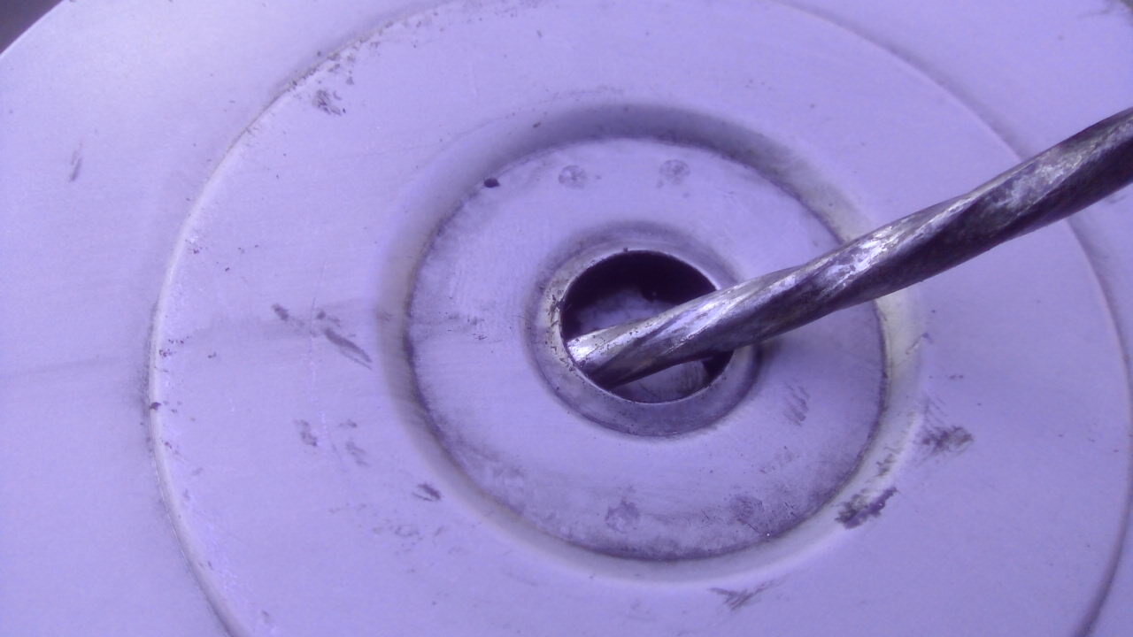

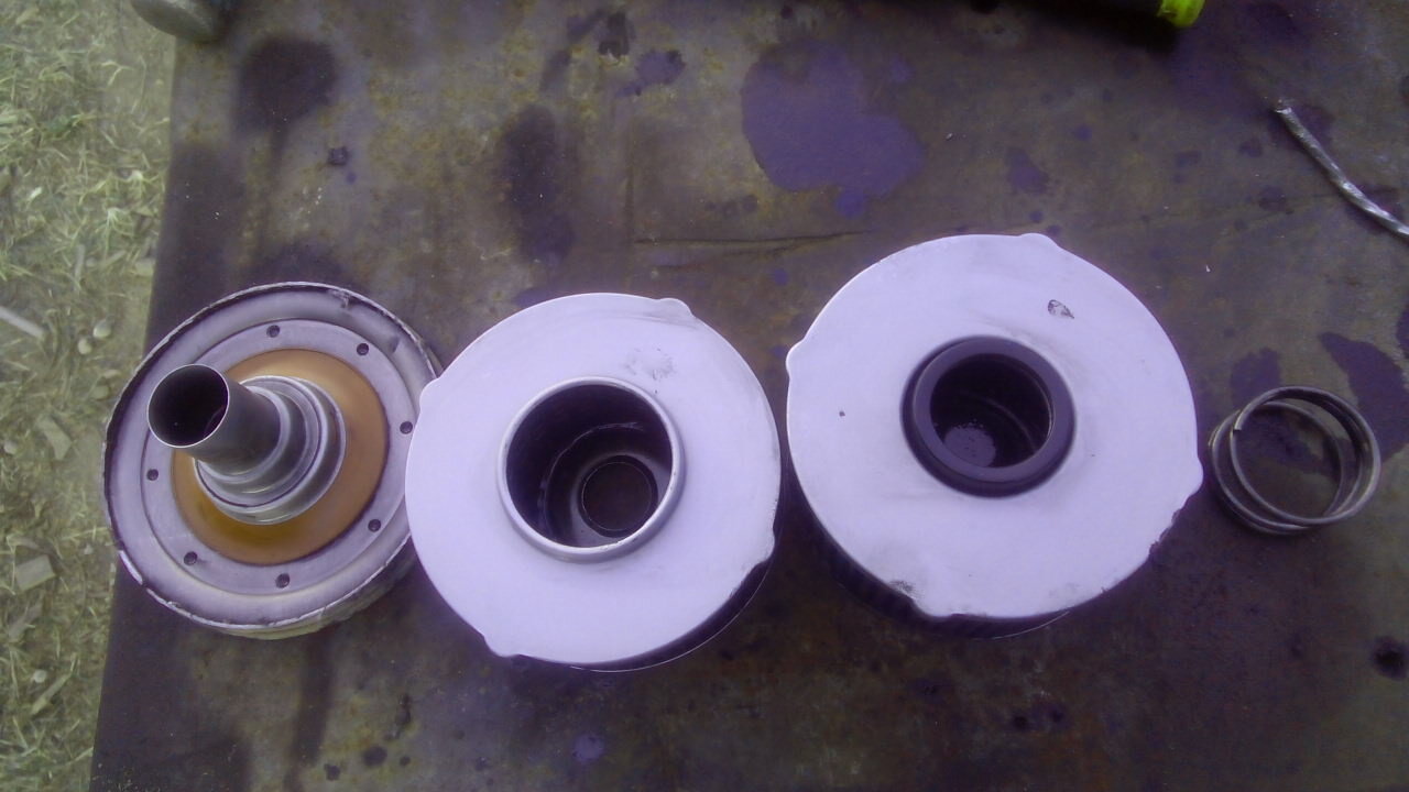

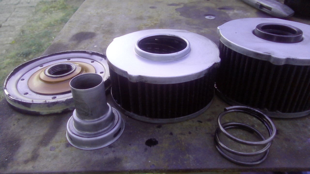

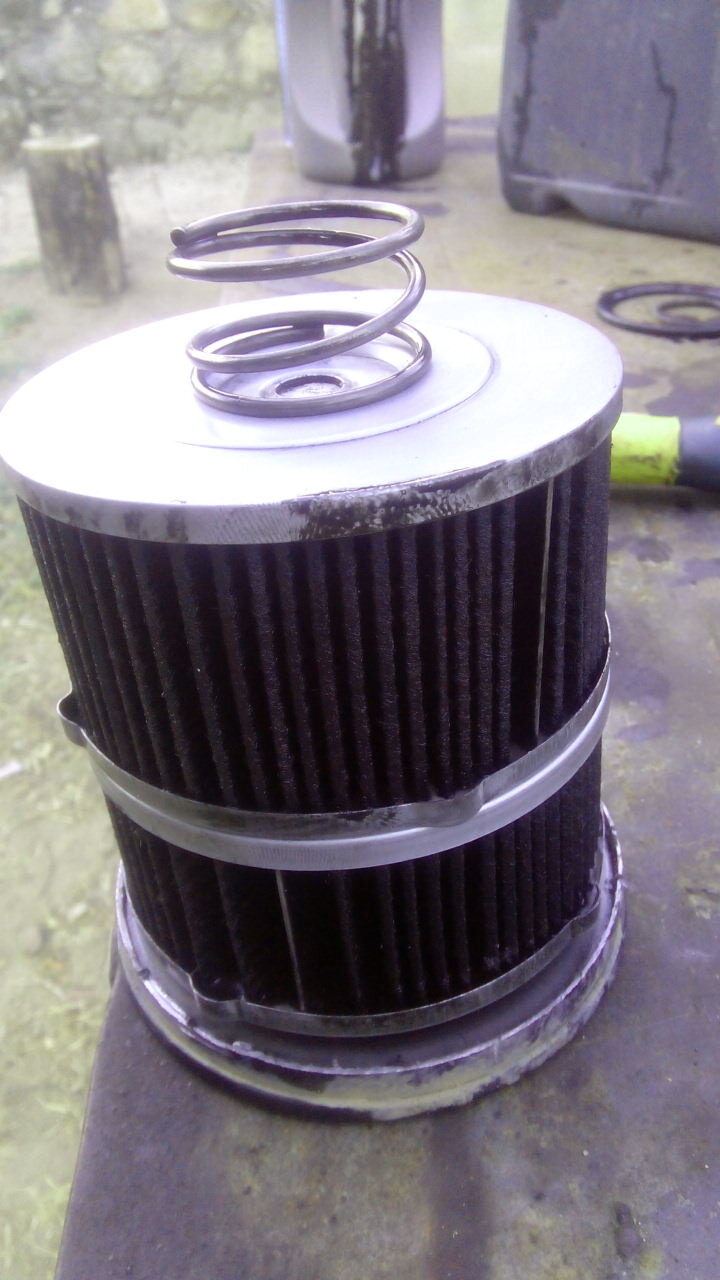

I don't like not knowing when there are ways to find out! So I stripped open the filter... So now what?
IMG_20160817_164602.jpg IMG_20160817_164618.jpg IMG_20160817_164646.jpg IMG_20160817_164704.jpg
