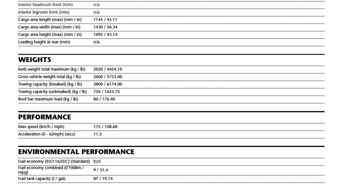

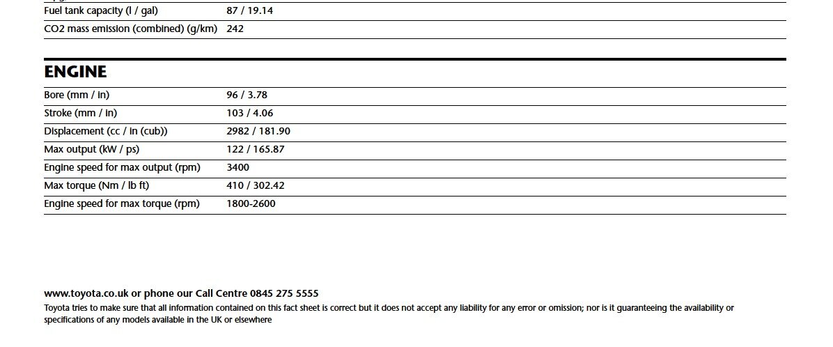

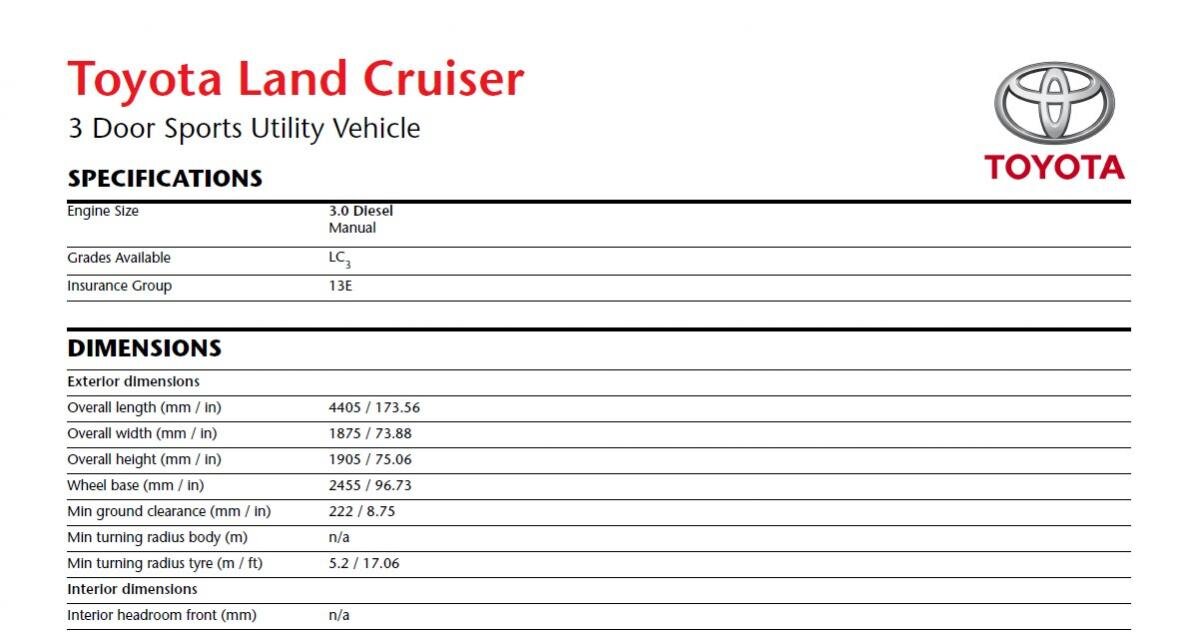

As it is a pdf, I cant upload it as one.
So I have split it into 3 pieces, top, middle and bottom.
I have overlapped by 1 line, so nothing missing.
Note, this is for the early engine, at 165 bhp, most are 173 bhp, or 175 bhp, with a few 203bhp LC5 invincibles, but were a limited number.
Gra.
