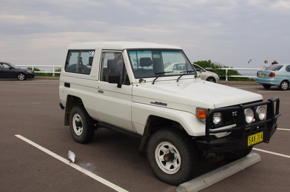

Just after we picked it up from Newcastle, NSW:

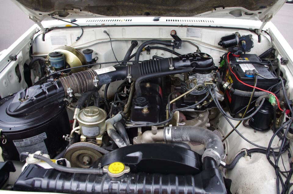

We never quite got the engine bay this clean again:

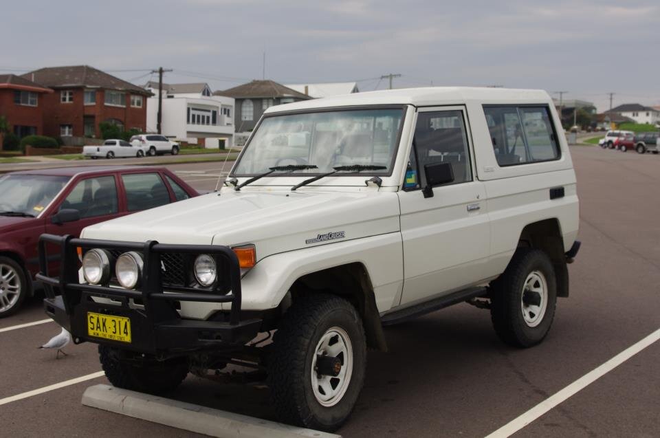

1986 Toyota FJ73, absolute base spec, no central locking, aircon or electric anything beyond the lights, ignition and radio.
Upgrades: circa 2" lift with IronMan FoamCell Shocks, ARB front bar, IPF 900 lights, BFG KO's, 2.5" exhaust and headers

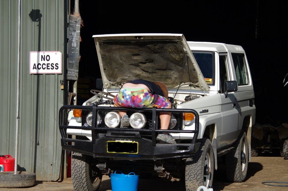

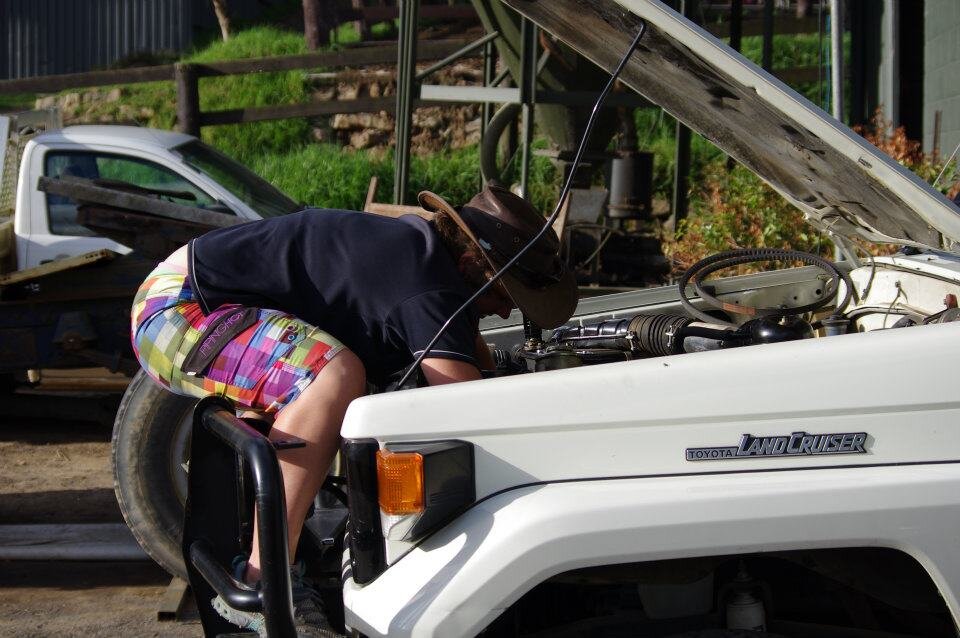

From time to time we needed to do work on it; on this occasion the water pump had crapped itself at the top of the work drive, so it was roll it 3km down the hill and park it in the yard, borrow a work truck to go home and then fix it when we got the parts:
GF could only work on the engine bay like that; in fact I had to open the bonnet for her!

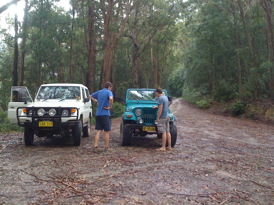

4WDing in the Watagans:
Swag camping: (I'm hiding in the background in front of the 'Cruiser)
Group of guys who'd bludged off of work due to rain, so decided to go to the Watagan's; they'd spent the last 10km pulling a backpacker's fan out of the bush as it was FUBAR'd They'd decided they wanted to find a road that is somewhere in the Watagan's called Daniel's Point Road; they never found it but I think they went off on Sawpit Road and ended up with a long winch out (in fact one of the lads was in his boxers as he'd drawn the short straw of attaching the winch!)
