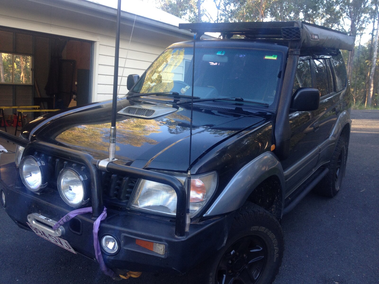

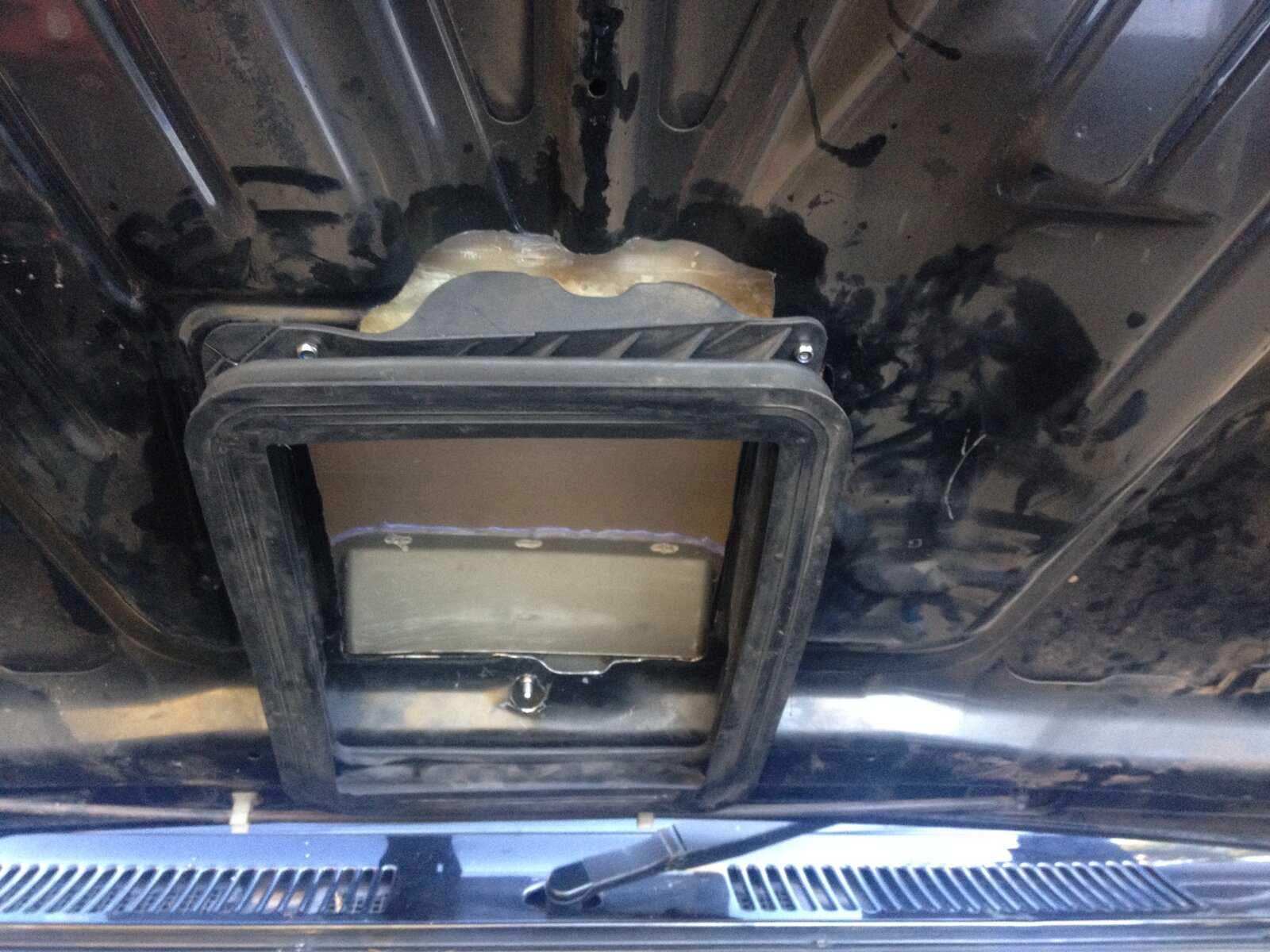

I fitted the intercooler to keep egt's down (because I have the fuel and boost turned up). When I fitted the fan some of the air was escaping past the sides of the fan as the intercooler presents a bit of resistance. With the shroud fitted all the air from the fan goes through the intercooler and none escapes. The fan itself is particularly useful at slow speeds eg traffic, mud or soft sand, where there is very little air being fed through the bonnet scoop, and hot air from around the engine was rising and soaking into the intercooler making it much less efficient. I imagine the heat soak problem is even more pronounced if you don't have a bonnet scoop.
I was just thinking it will work well when the fans doing its work but at speed much of the air from your scoops will bypass the cooler , i'd have the fan on constantly i think as the air will never get to cold to burn .
I don't use the grill scoops, instead I have fitted a bonnet scoop. I also have the original intercooler bonnet seal to prevent the air from "leaking" past the intercooler. It doesn't seal 100%, but does the job for a old diesel 4x4. So all the air from the bonnet scoop goes through the fan and intercooler, and at low speeds I still get a decent volume of air going through. With the temp sensor set to switch on at 50C I thought that it would be always on, but last week driving around the beach at Moreton Island there was a nice cool sea breeze and often it wasn't coming on (wasn't needed), but as soon as we hit a soft patch or a climb the temps would start to rise and the fan would come on.

Ah didn't know you had a scoop , never seen your truck before :icon-cool: :thumbup:
