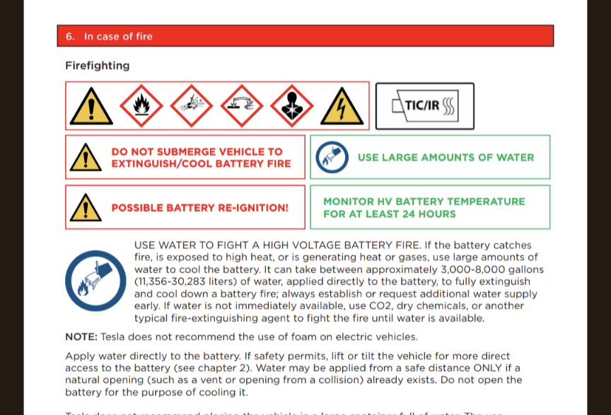

Recommend hydration for a Tesla 3 on fire is 10k ltr of water. Usual fire appliance in the UK carry 1.8k

Problem with that is you should not use water
