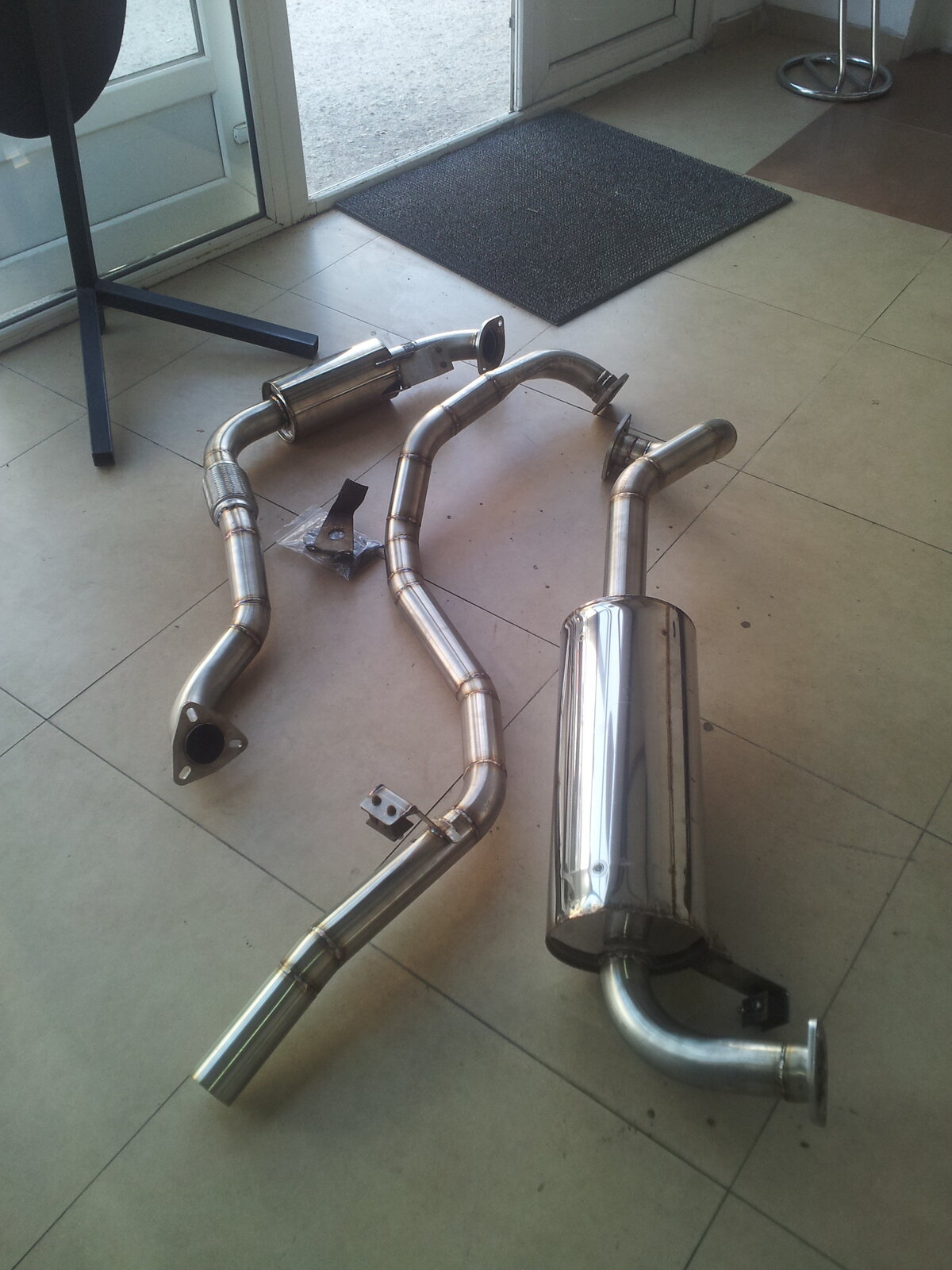

    So I don't hijack Chris's thread....
    The 80 is going in for a stainless system shortly but I'm very undecided on its exit point. Either rear where it should be, rear but tucked up a bit more or side exit behind the rear wheel.
    What have those who've got a custom system done? Looking for ideas/inspiration.
    Noise depending I might be able to get away with only the main silencer and ditch the small rear one. Bearing in mind it's a petrol.

    I built one for Muxley a while back Gary. I'll try & do a few photos tomorrow if the weathers okay but I just put a single

    Fat fingers... box in a 3" line. Looped it up & over the rear cross member & dropped down vertically near the rear wheel :cool:

    I get what you mean where it's routed, it'll be getting a 2.5" cat back system.
    I've built my own in the past but on diesels and I thought I'd save myself the hassle lol.

    Yeah it needs back pressure more then a td does. 2.5" isn't much bigger then stock diameter. Already re welded a hanger back onto the main box so before it breaks it's having a shiny one.

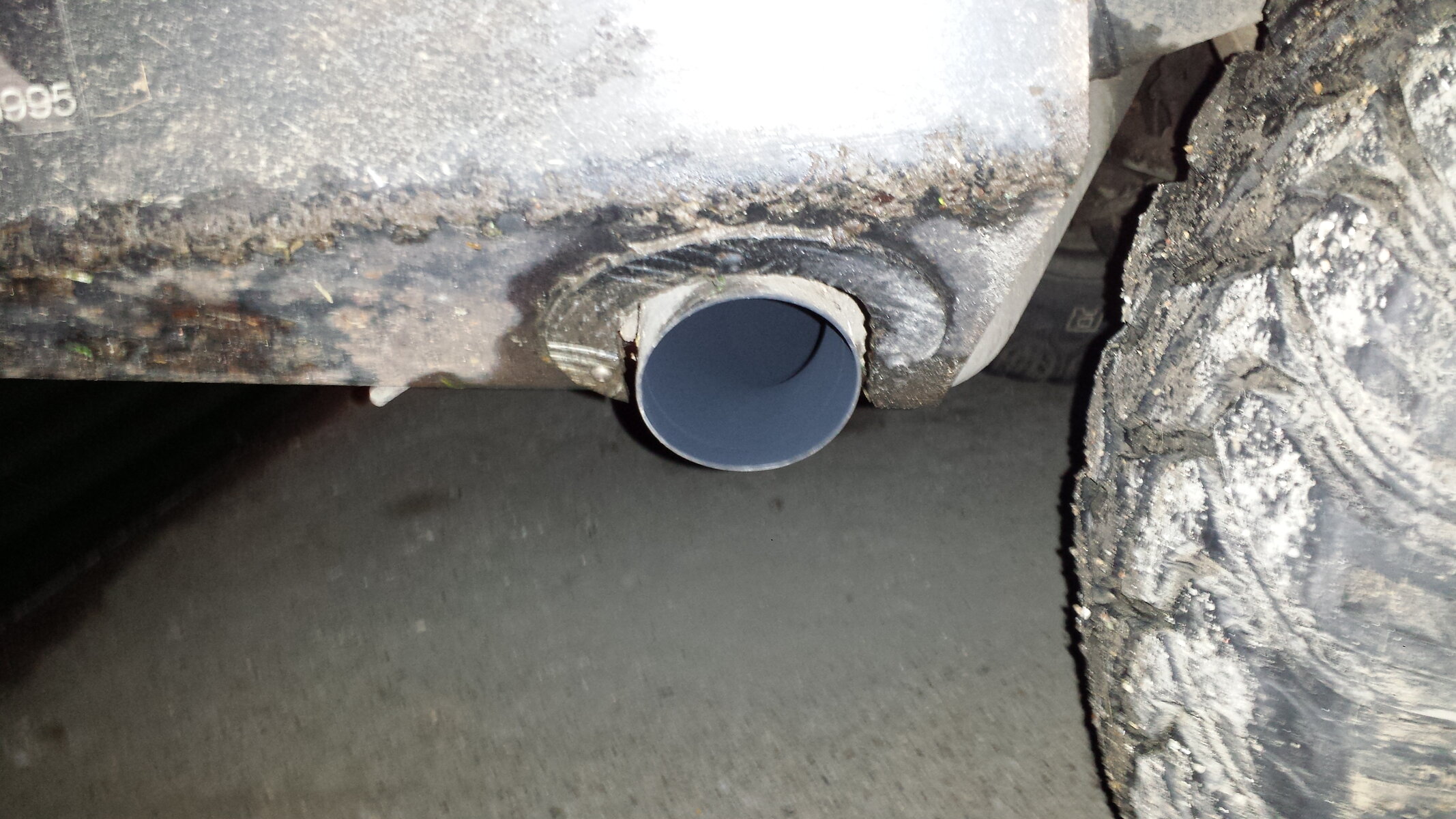

    I dropped over a rock once and flattened the rear exit pipe so when I had a 3" S/S exhaust made by Charlie at Prospeed I got him to side exit it through the bumper.

    I like that.

    Susceptible to rattle maybe, is that a rubber surround to the hole in the bumper Chas? It looks a nice close fit. :icon-biggrin:
