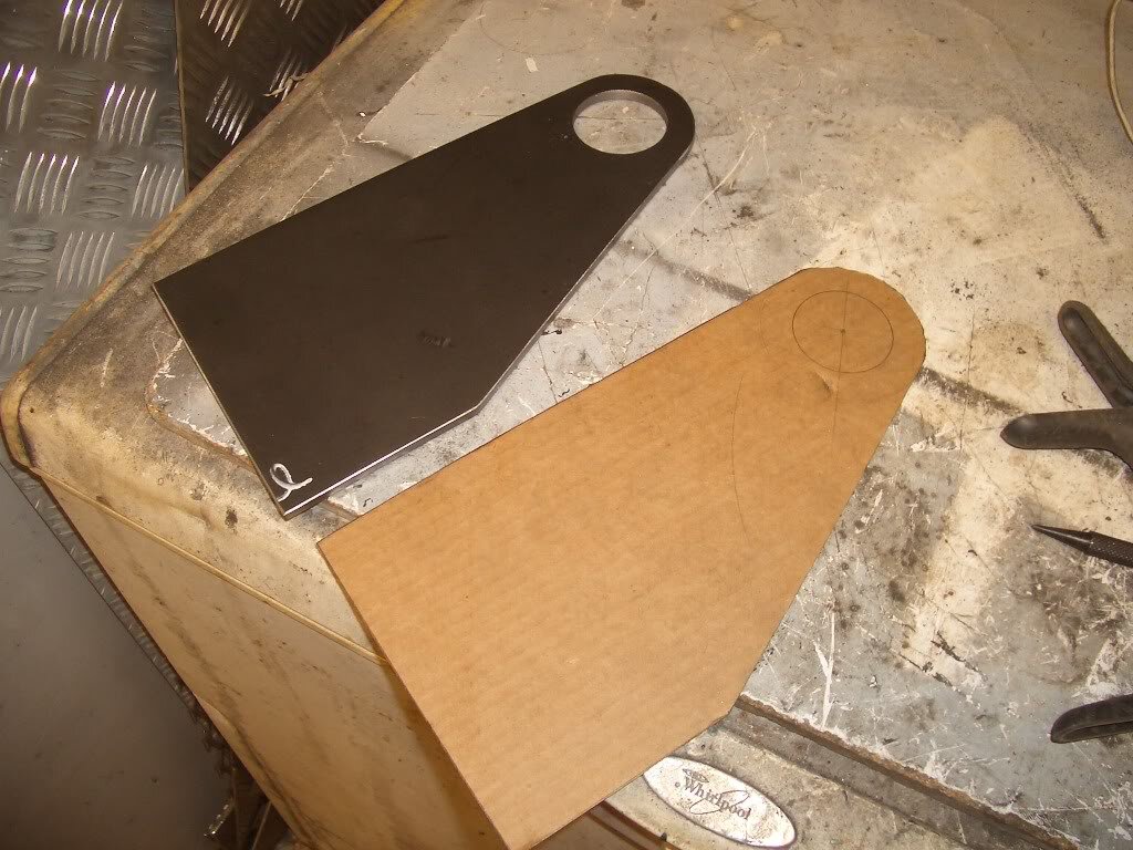

OK, so what are these mystery items then? Hmm. Eh?
Guessed what they are yet?

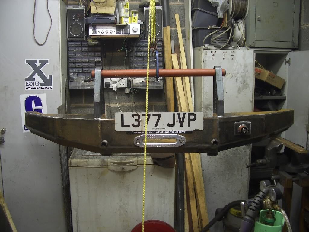

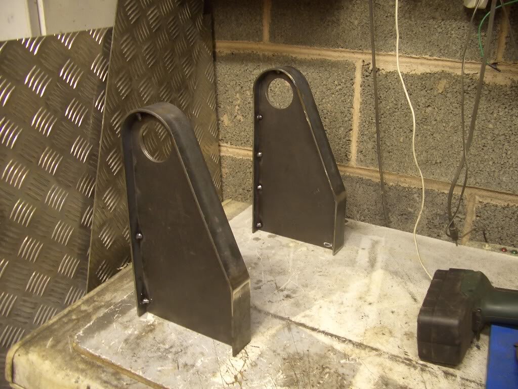

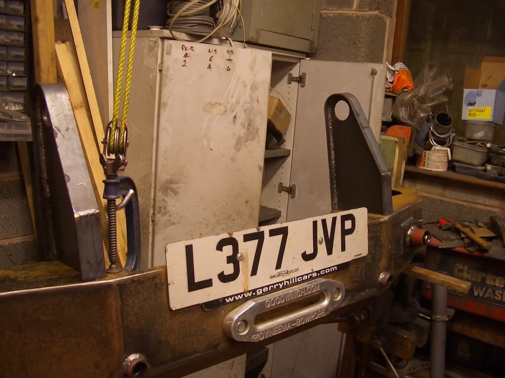

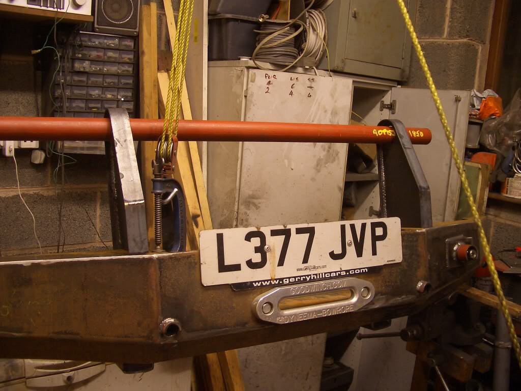

Getting the hang of this fabricating lark. Just tacked up at this point
Now then - are we there yet?
Oh yes. Well look, if I had the money, I'd buy something snazzy too. But I haven't so there.
I can't bend pipe yet, so this will get trimmed and there will only be the single pipe, with a light bar as well lower down.
Pretty pleased with that bit. Mind you, it's getting heavy.
Chris

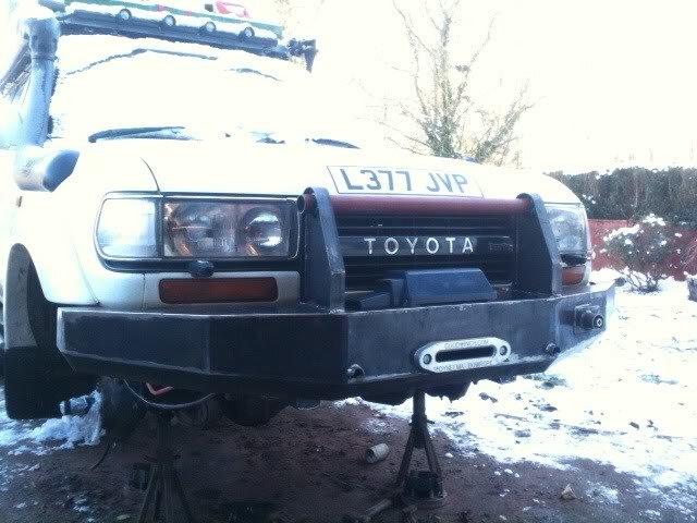

Looking good as usual Chris, should look like a bought one when you're done :thumbup:
Thank you Jon. Appreciated. Like a bought one eh? That's Gary's usual line. Far from that I'm afraid. You can see the joins! Once this is blasted and powder coated I think that it will look pretty sharp. Having that Plasma cutter would make things like this so much easier and neater too. Complex shapes are nice and when you have to cut every thing with a disc it limits you somewhat.
Finished off the mounting points into pockets too. Now it's really solid. The were open sided brackets before but now they are fully enclosed. Not much more to do.

Very nice job! Like your ingenuity!
One comment is on the air take-off. For people like me that would be a knee-buster sticking out like that :(
Then I suggest that you don't step out in front of me Frits! :lol: :lol: :lol:
There is no such thing as a pedestrian friendly winch bumper. Not when it's attached to nearly 3 tonnes of 80. It's actually pretty discrete. It doesn't stick out that much. Proving very handy for kneeling on is this bumper. Good for getting over the engine to fix stuff. I could make a special step that slots into the high lift points. In fact that's a damn good idea. I shall follow that up. :idea:

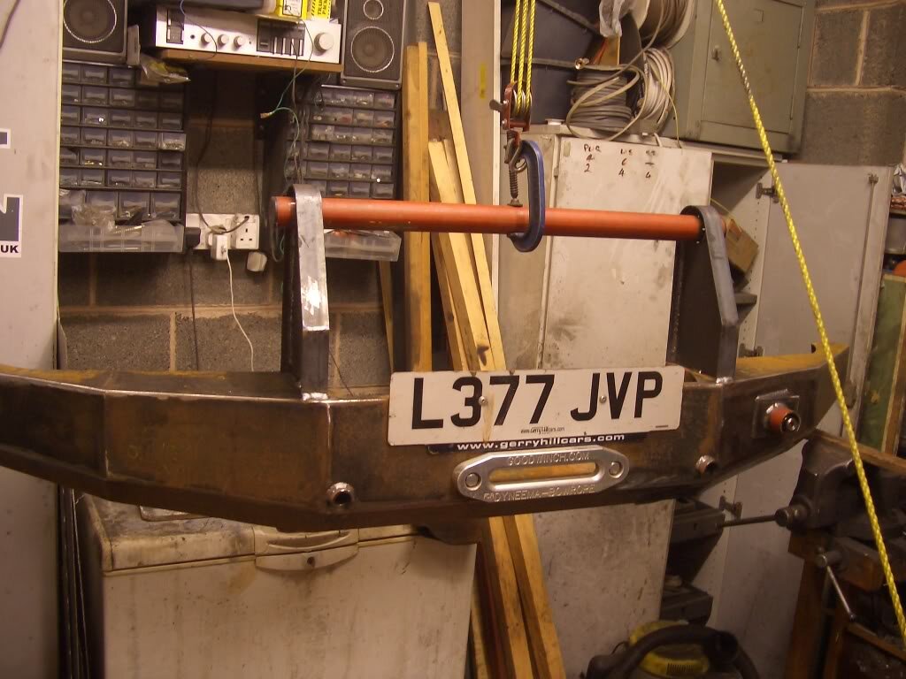

Look, I know that you are all desperate for news on the bumper front, so here's tonight's efforts. Now that's enough! Don't over do it. You'll make yourself poorly!!!
Thought about cutting a section out of the rib to lighten it up a little. But it's a pain without cutting gear. Look nice though.

Well the balance looks spot on :lol:
How heavy is it now?

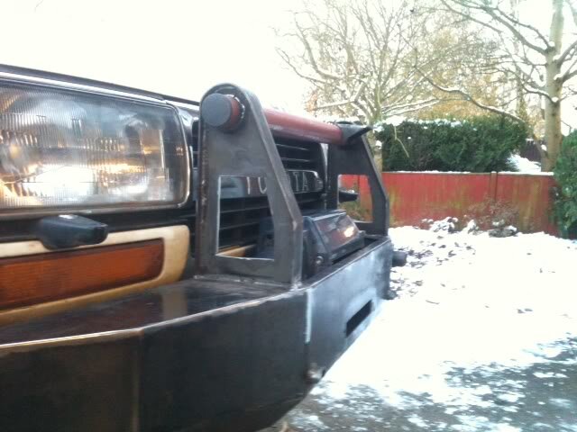

Put some real effort in today and I must only be one or two steps away from getting this to the coaters. Gave it a good polish down, did some filling and smoothing too, then stuck it on to see how it looked. Pretty happy, to say it's made from scrap.
The I decided that it looked a bit solid. So I set too and cut some sections out of the uprights to lighten it up a but. Need a bit of filing down and tidying. Another case for buying that plasma torch! Dear Santa, I have been very very good this year....

Wow that is an amazing piece of kit you have put togeher there :thumbup: :clap:
Thanks for that. Once they are blasted and coated these things tend to really start looking like 'a bought one'. Looked nasty all covered in rust, so I thought I whizz that all off with the grinder and cup brush. However, I seemed to have ended up storing most of that up my nose!
