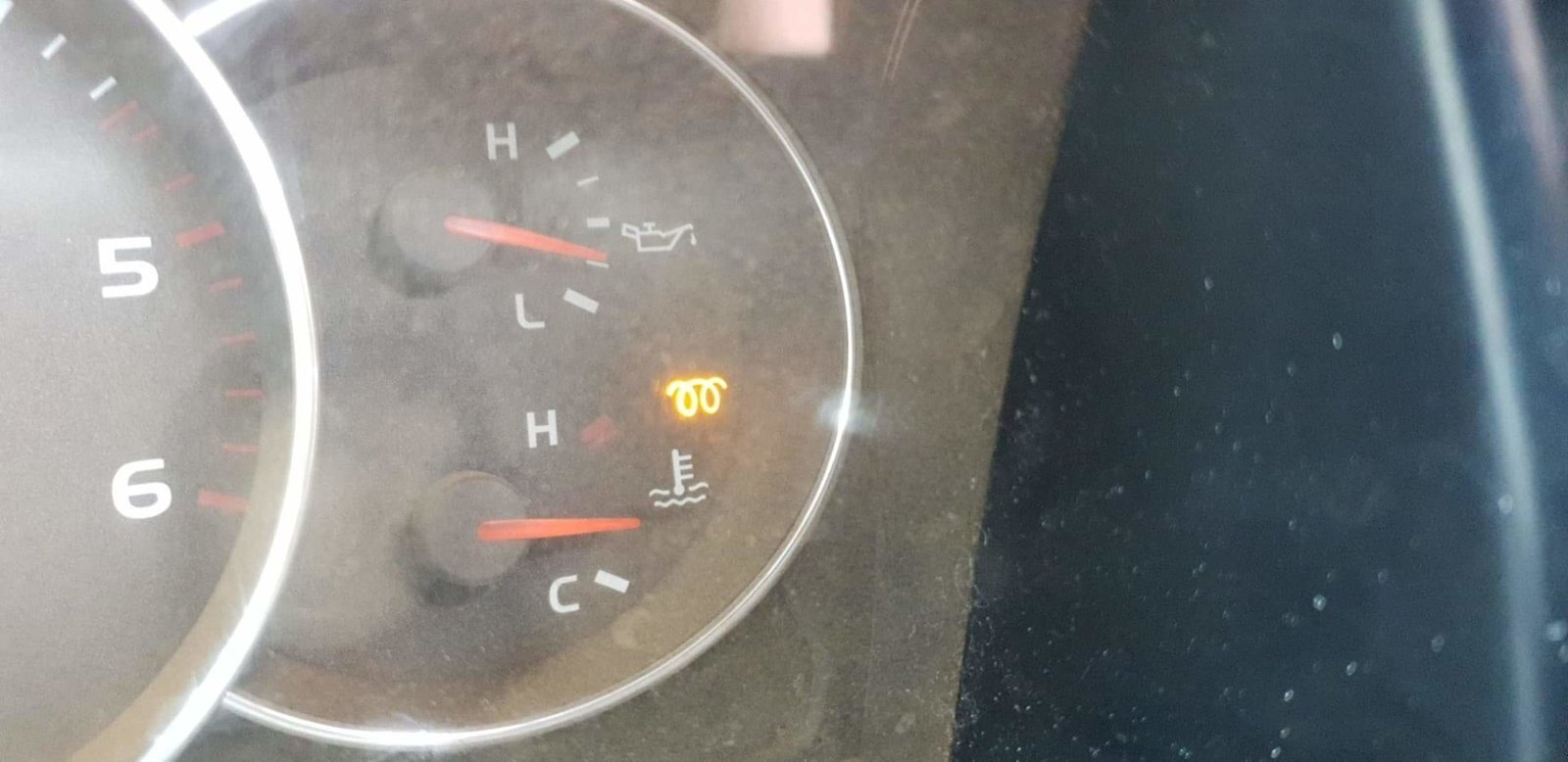

IIRC the wiring to do with the busbar/glowplugs need to be connected correctly, there are plastic insulators that need to be in a certain order between wires to insulate from each other. If incorrect, could have live straight to glowplugs, which is bringing on the light. Maybe worth a check that wont cost nuffink !
