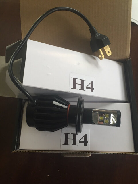

Got back home this morning to a small package containing two new style lamps that now have the control gear built in so no separate control box to mount elsewhere [emoji4]
Got to say service from Steve at Woodypeck was superb. Got a phone call the day after ordering explaining that he'd had to wait a bit for new stock and that he had just packed them. Had a good chat and found he has sold about 200 pairs and only had IIRC 4 returns, one being a cable, and said the manufacturers offer a 2 year warranty. He also explained that the new design was brighter still than those they replace. ImageUploadedByTapatalk1423742090.274774.jpgImageUploadedByTapatalk1423742146.718814.jpg
Seem nicely made with a good size heat sink and fan on the back. Another good feature is that the fitting collar detaches for ease of fitting with the spring clip in the back of the headlight.
Will update later with how they look. :-)
